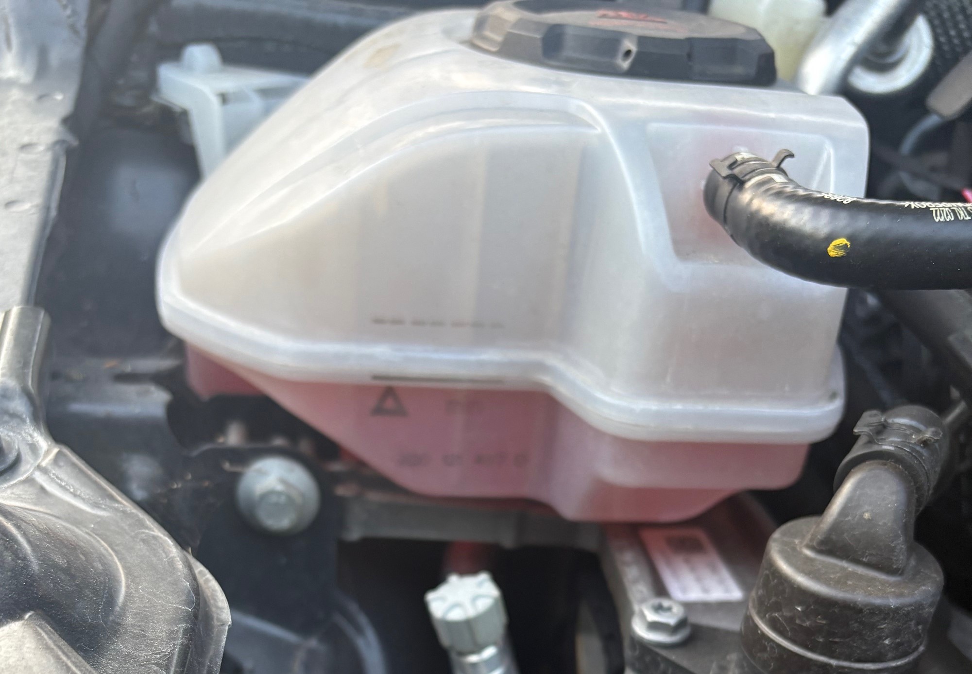

Hi all, i have just done a little inspection on my levels and i think the coolant may need a little top up , I was finding it hard to see the max line , on 2022 gti. I have got the 2nd year service in two weeks and I would assume it would get done then if needed ?. Had no lights on dash or anything like that . Have enclosed a piccy

How long has the coolant been at the minimum mark on the expansion tank? Has it always been at the minimum, has it been going down over time or has it suddenly dropped? When the cooling system is filled in the factory, sometimes air can be trapped in the system which is usually purged within the first few months of ownership and the coolant level in the expansion tank will drop as coolant replaces the previously trapped air. However if the coolant level’s suddenly dropped recently in a car that’s nearly two years old, it could indicate a leak in the system or a leaking water pump / thermostat housing (not uncommon with VAG’s EA888 engine). I’d keep an eye on the coolant level and check it regularly after the dealer (hopefully) tops up the coolant during the service. Replacing the water pump and thermostat housing at a main dealer is an expensive job so if they are leaking, make sure you get them replaced before the warranty expires.

EA888 (and few others) are very prone to water pump/thermostat leak. I am personally dealing with one, right now.
6 years and 80K km. Not cheap repair that is for sure.
What a wonderful and clever design, lets just make plastic housing, put it right on hot engine and torque the bolts to 9Nm (that is like a bit more then finger tight) because more will crack the housing ... what could go wrong?! right?
