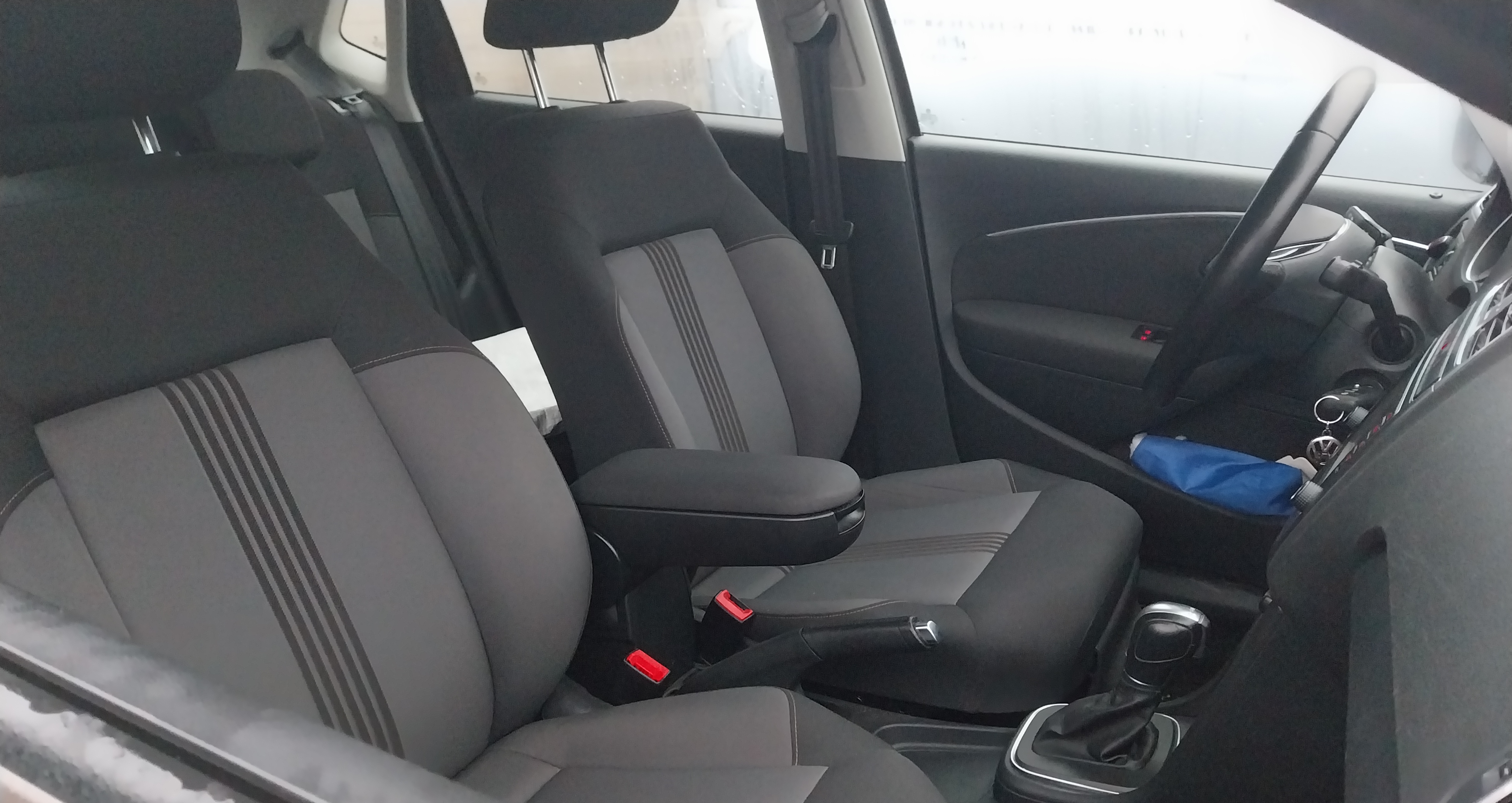

I want to add Heated seats so i looked at Kufatec (https://kufatec.com/en/cable-set-seat-h ... o-6c/49048), and it says that i need
Original seat heating controller
Original control unit for seat heating
Original seats with integrated seat heating mats
And i want to add the heating mats to my seats beacause they look nice in my car and don't want to change them.
But most importantly, where do i find these parts, and i want to be sure that they are the right parts, i don't want to use the wrong part and fry everything,
