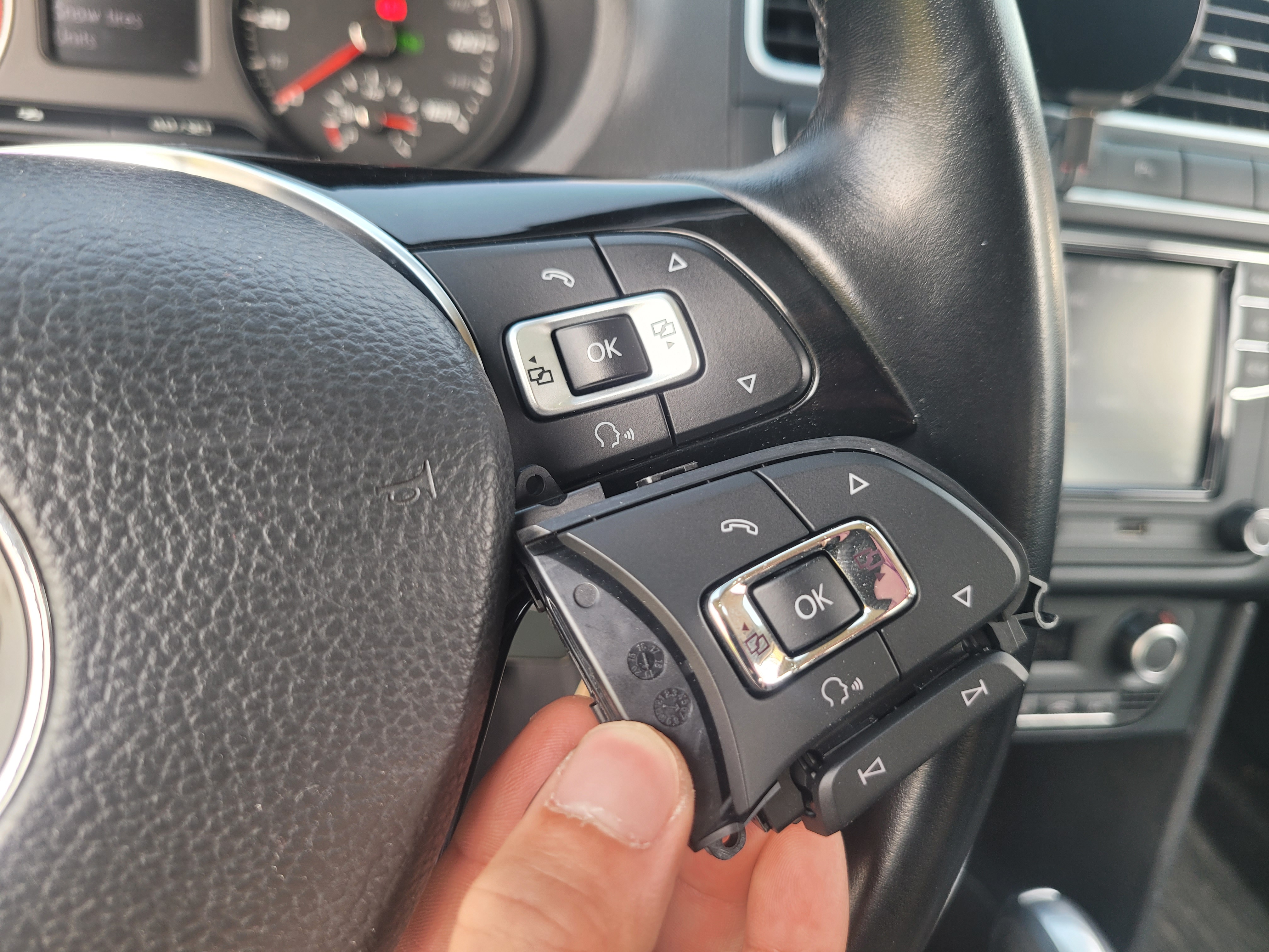

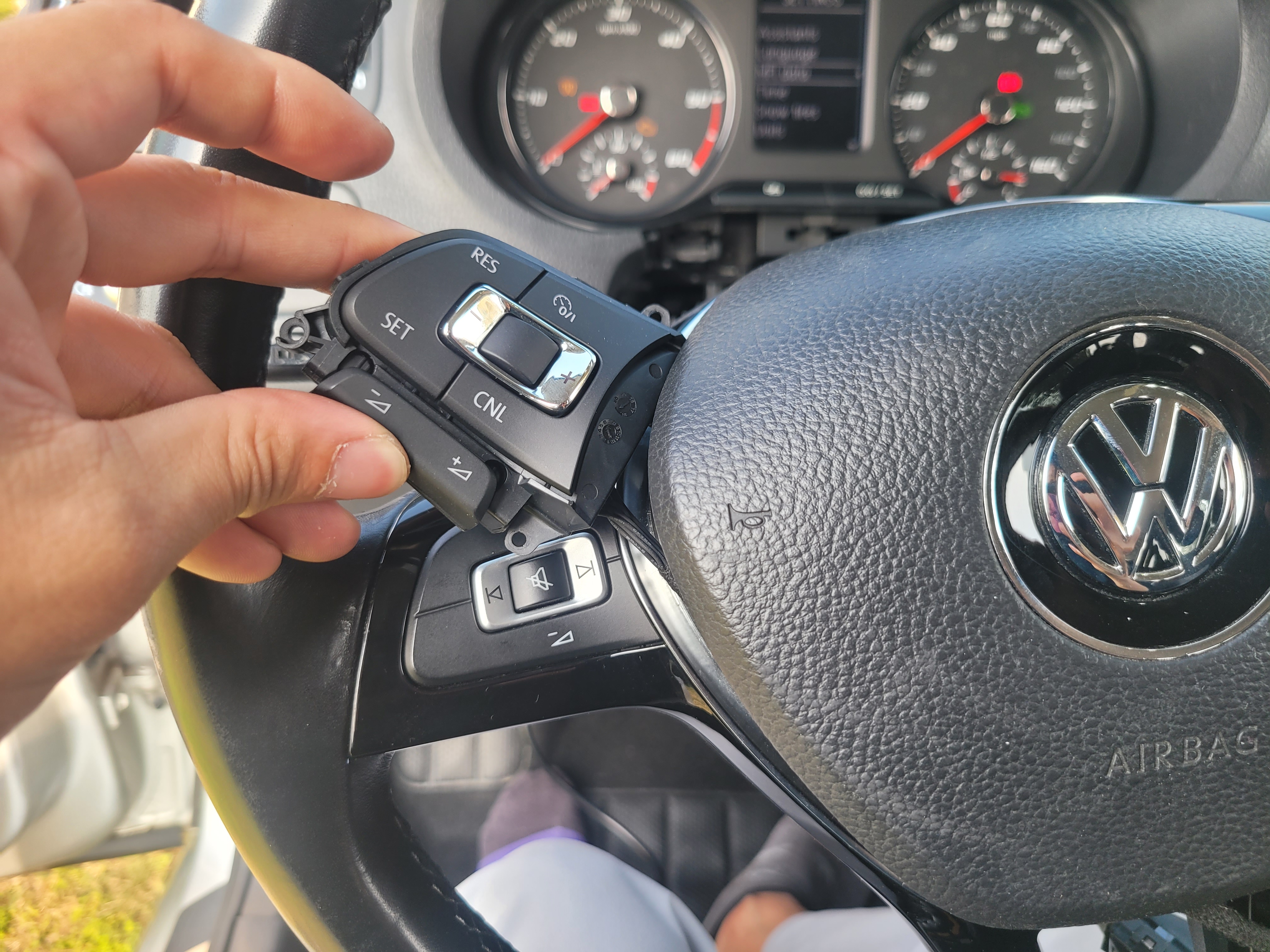

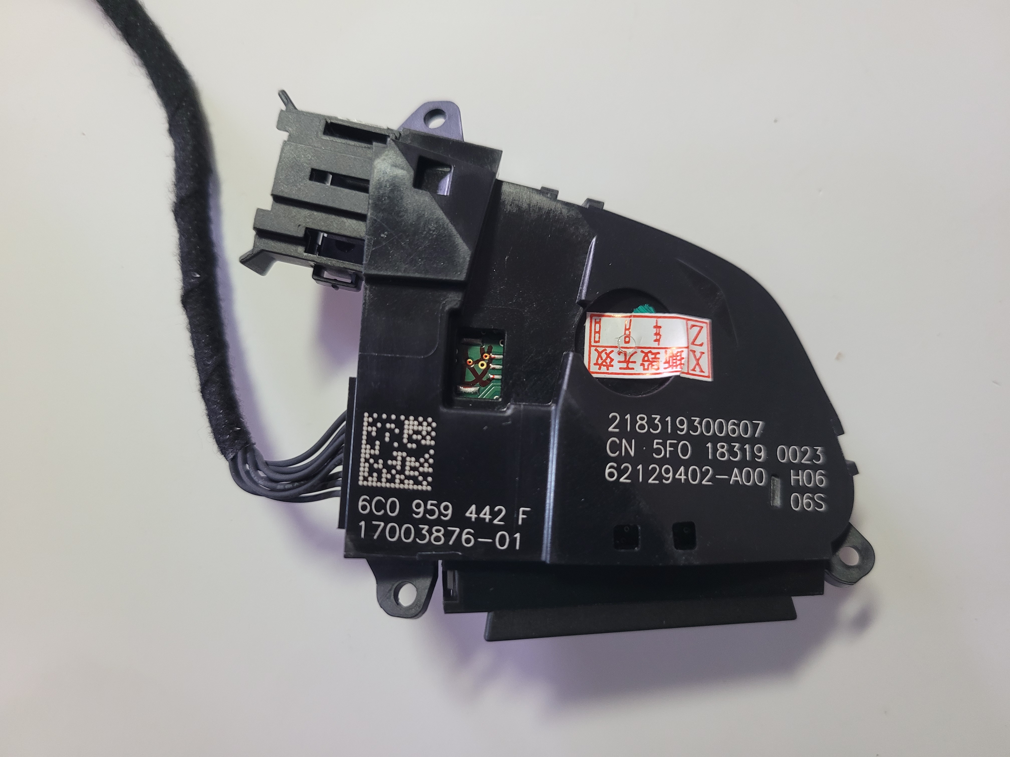

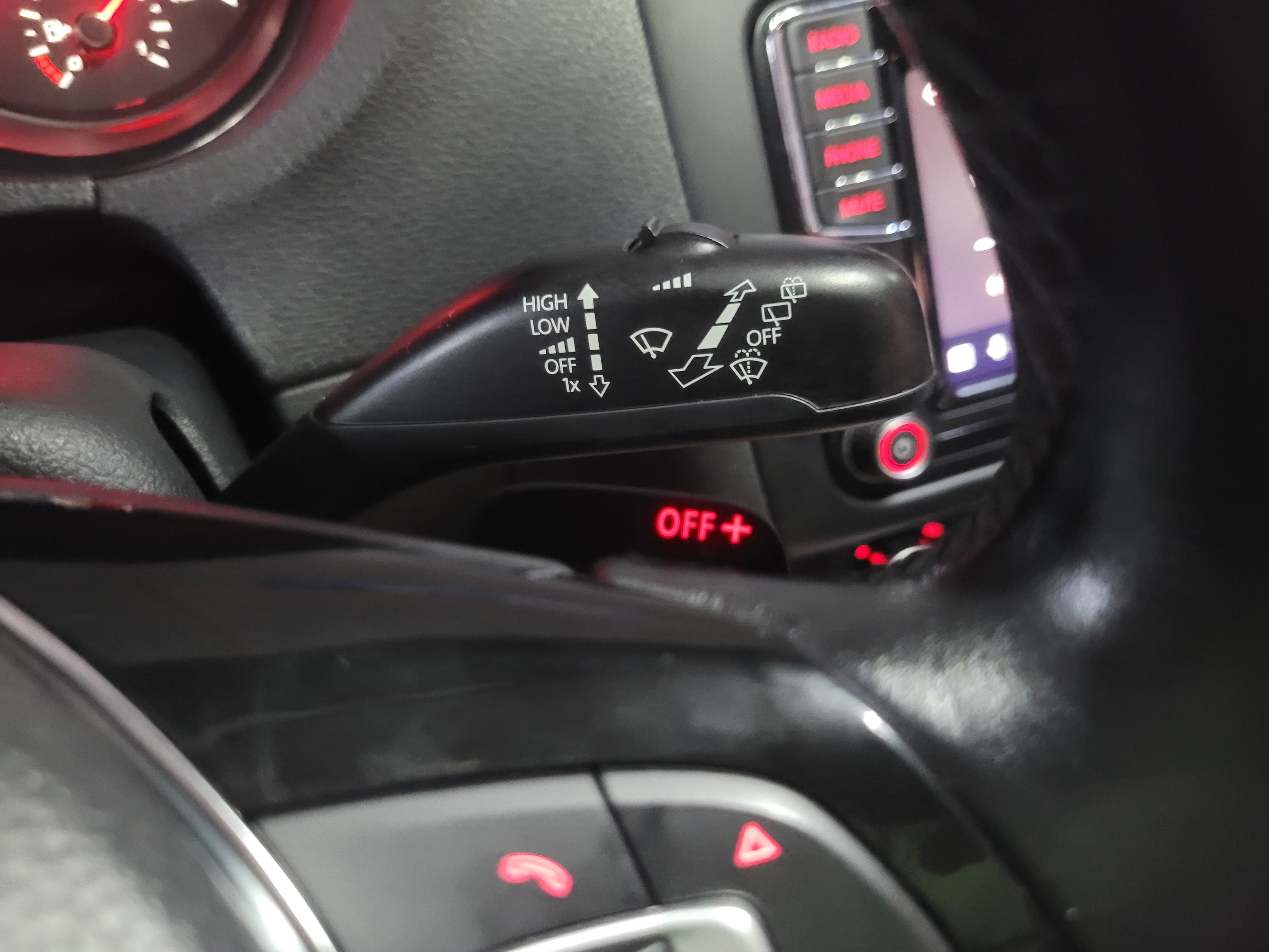

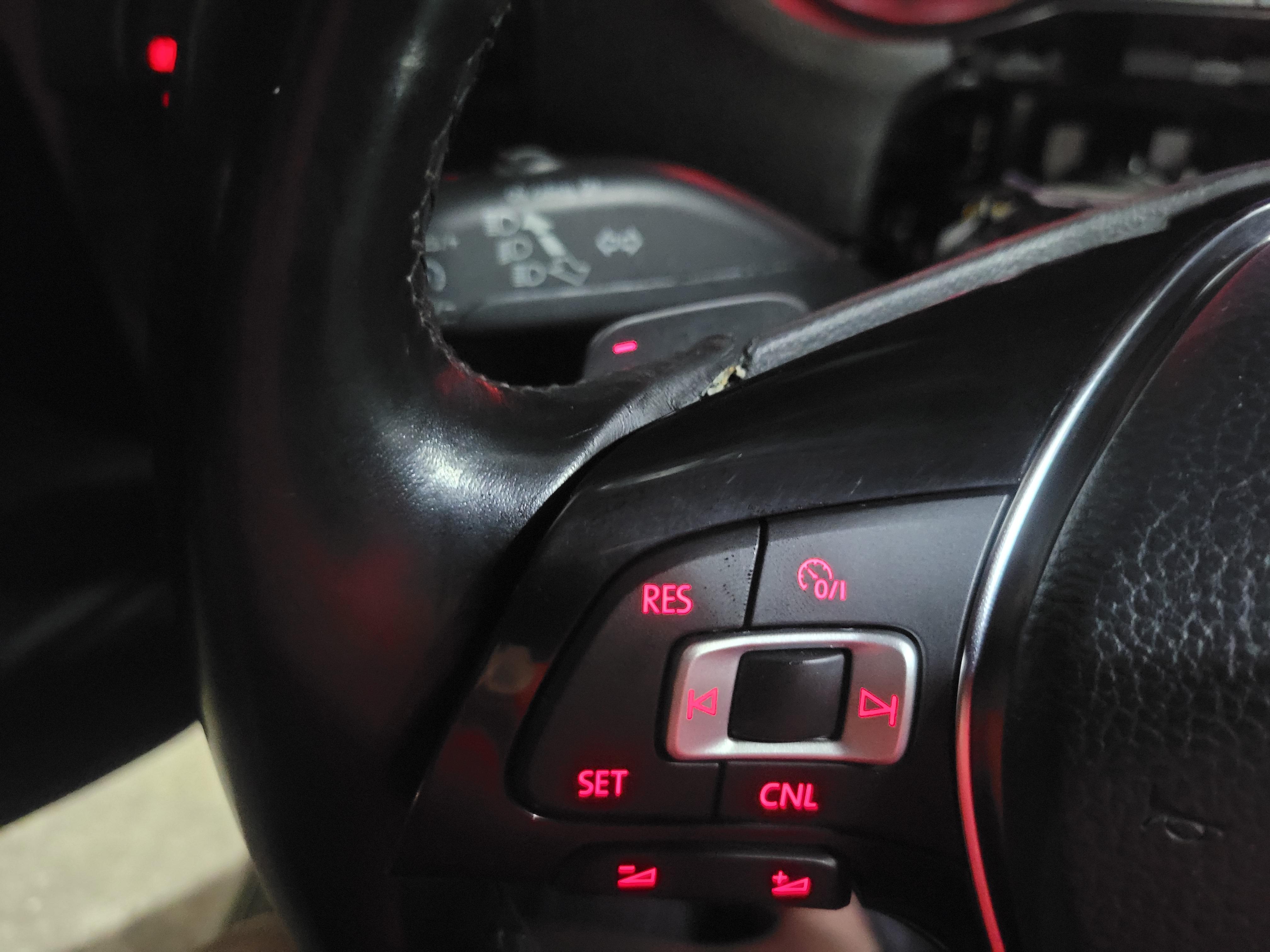

Hello everyone,
My POLO was originally equipped with an MFSW and a stalk, both without CCS.
In 2023, I upgraded to a stalk with CCS and experienced the convenience that CCS brings.
However, this year, I discovered an MFSW with CCS, and I quickly installed the 6C0 959 442 F MFSW.

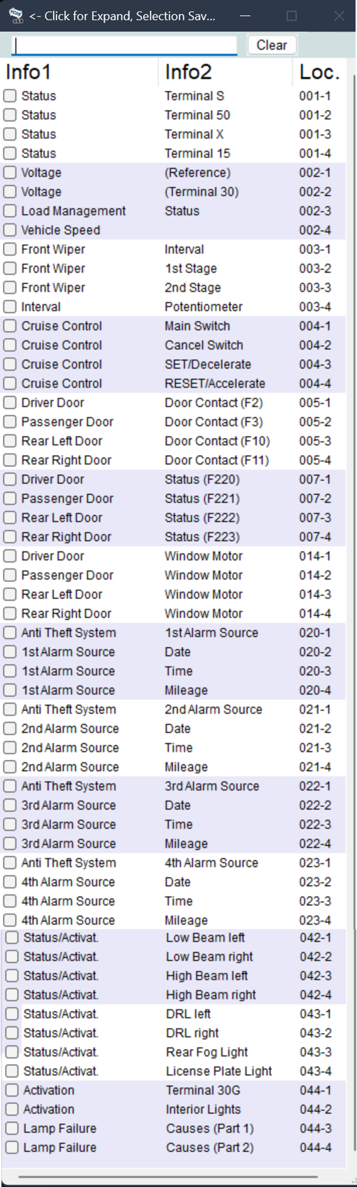

Currently, the issue I'm facing is that CCS isn't functioning (though all other buttons and backlighting are normal).
Below is a video of the VCDS test (where the CCS switch anomaly can be observed):
[youtube]https://youtube.com/shorts/oPpENAlKyyE?feature=share[/youtube]

Only E6 engines support CCS via mfsw
sejuani
Posts: 51
Joined: Fri May 17, 2024 8:38 am
Drives: POLO 6R
Location: Taiwan
Re: Need help on MFSW
Post by sejuani »
Thanks for the answer.

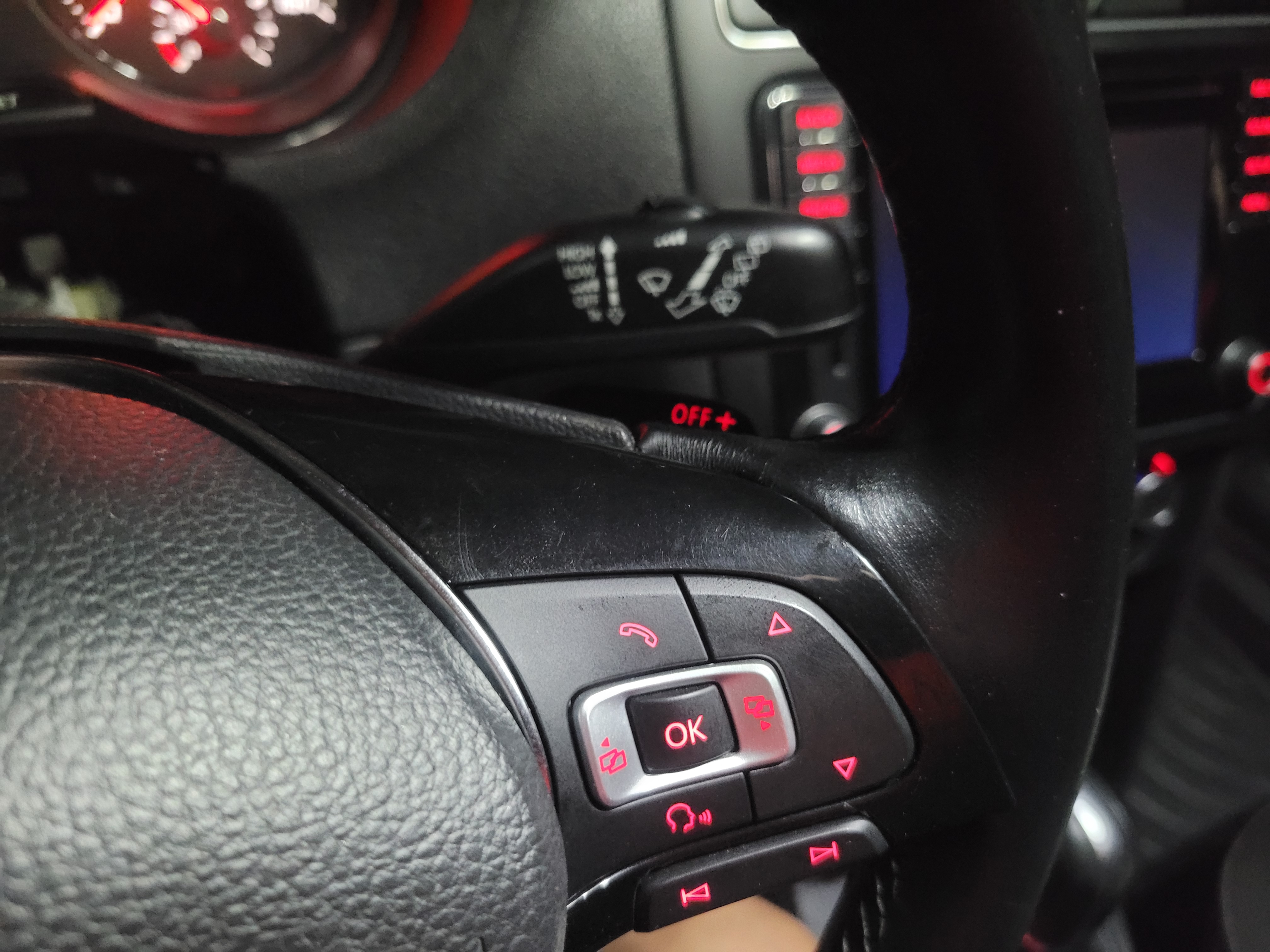

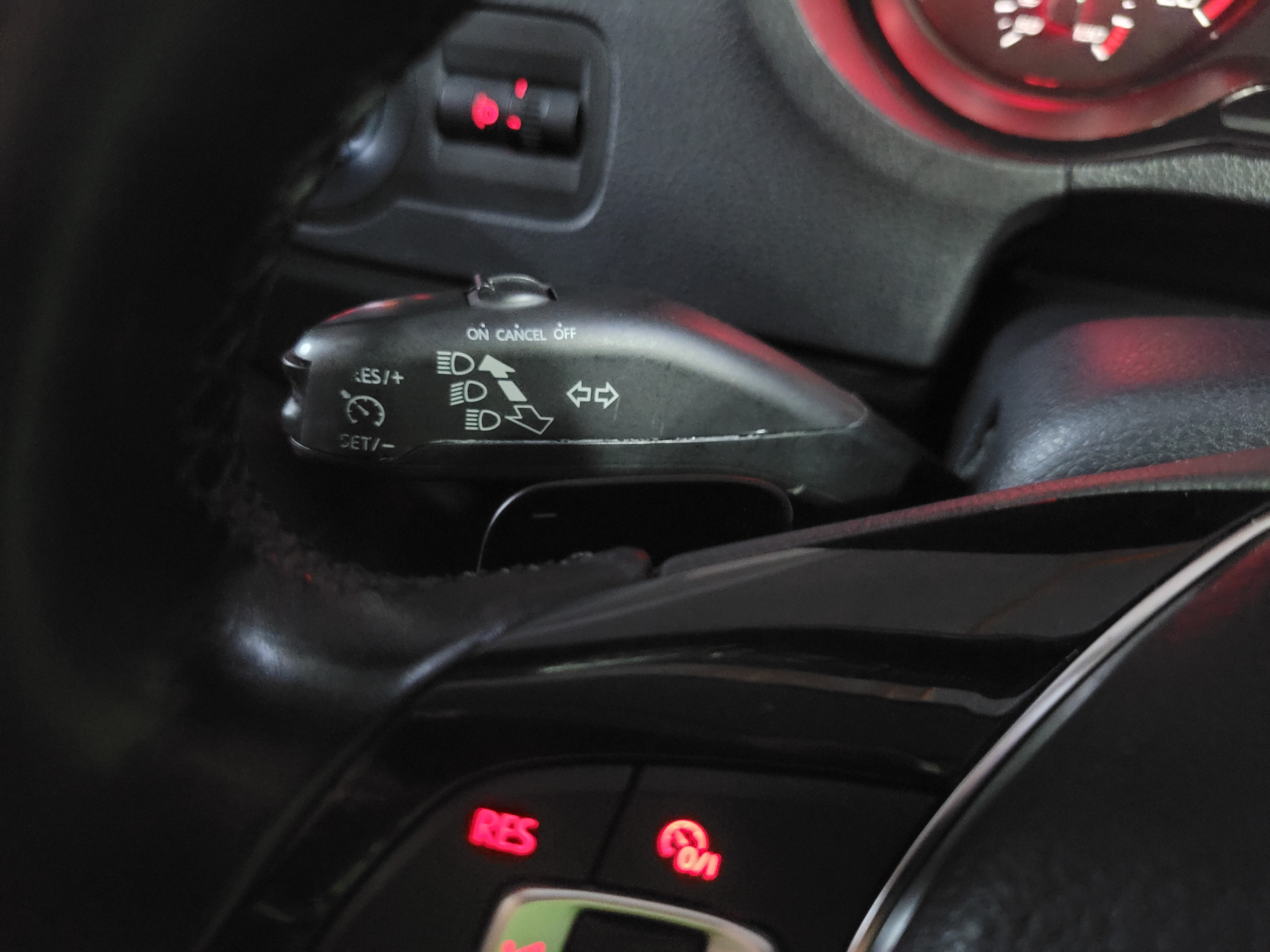

Today, I tried various methods and confirmed that CLSA cannot support MFSW with CCS.
I am even unable to independently disable the CCS of MFSW by canceling byte 17 bit 2 and byte 29 bit 6.
Considering that my MFSW was engraved using a grinding machine (and cannot be restored).
The current solution is to switch LIN from T73b/36 back to T73b/17, so I can keep my new MFSW.

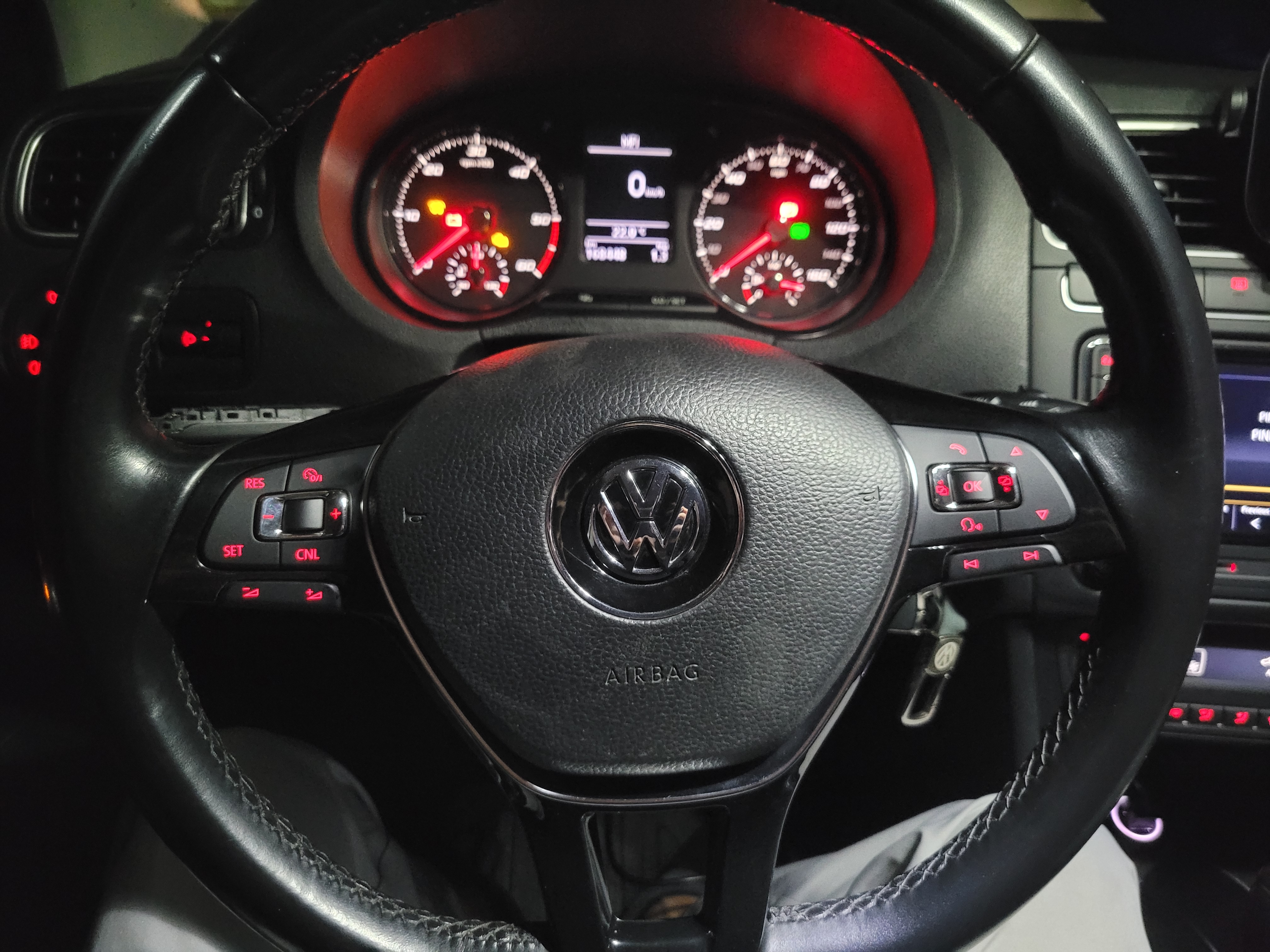

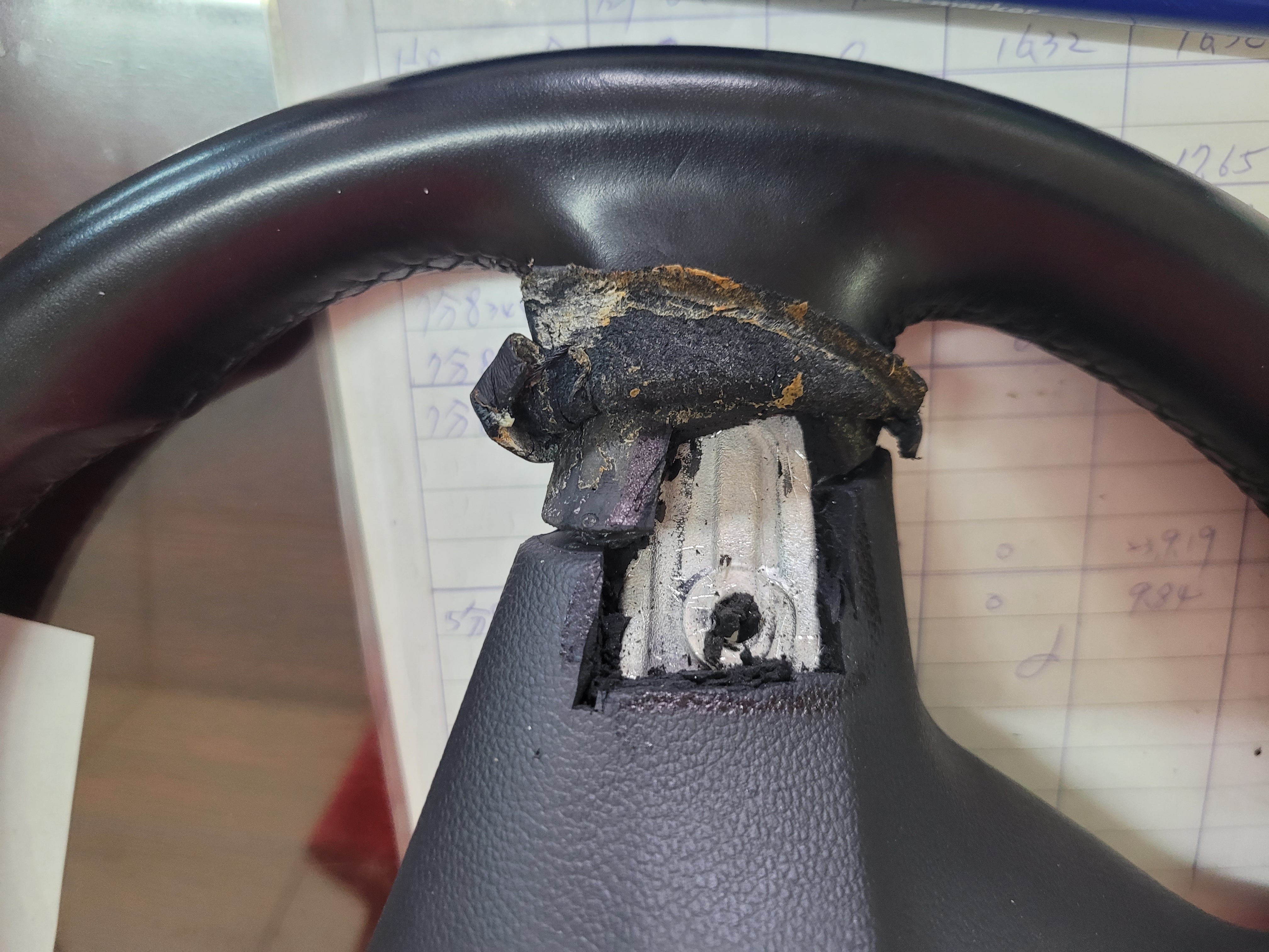

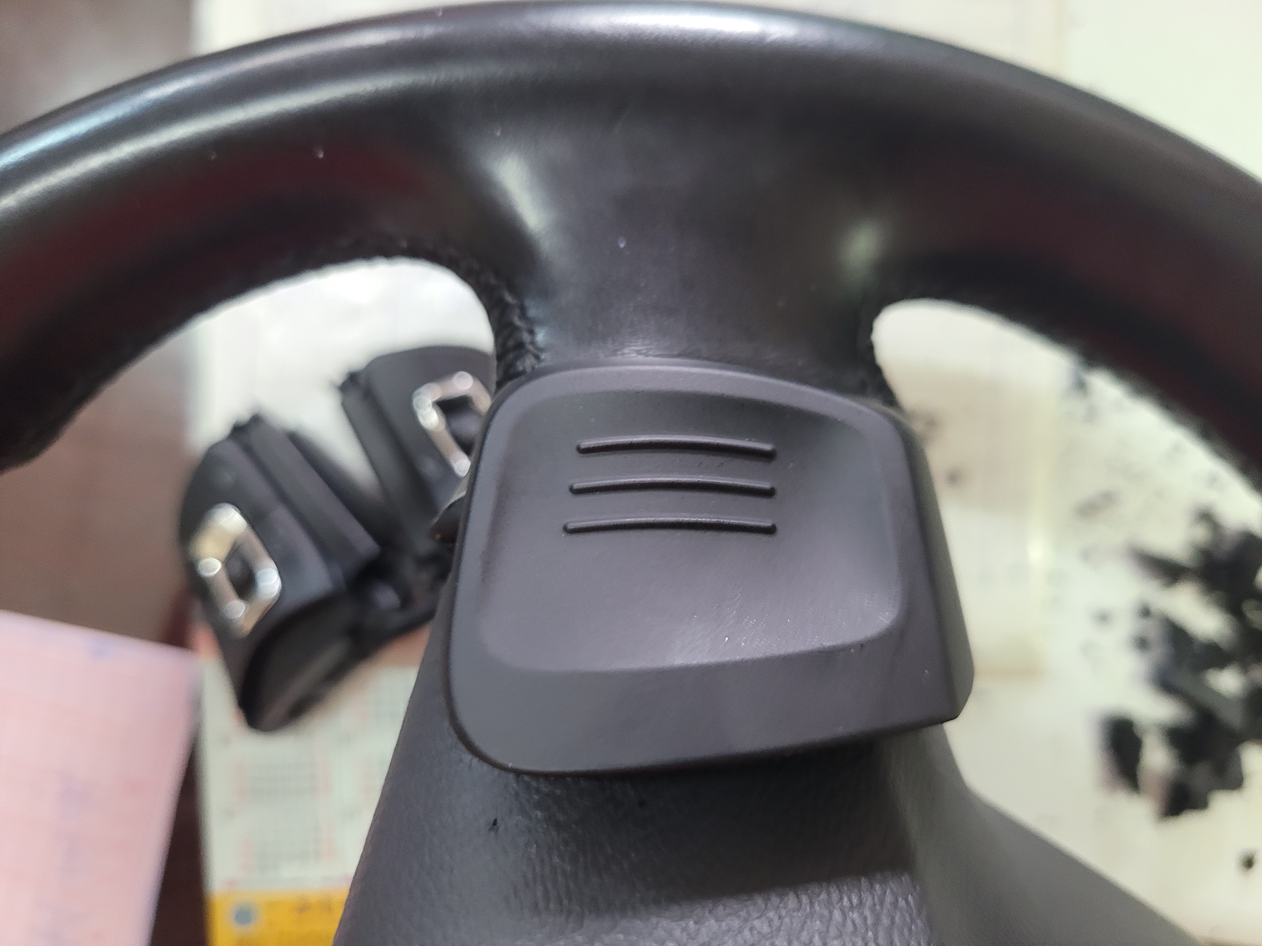

Now I know that the CLSA (EU5) ECU can't interpret the digital signals from the CCS on the MFSW (6C0 959 442 F).
As far as I know, the only workaround in my case is to use the Cruise Control Emulator developed by Slavik (MaDwArLoCk).

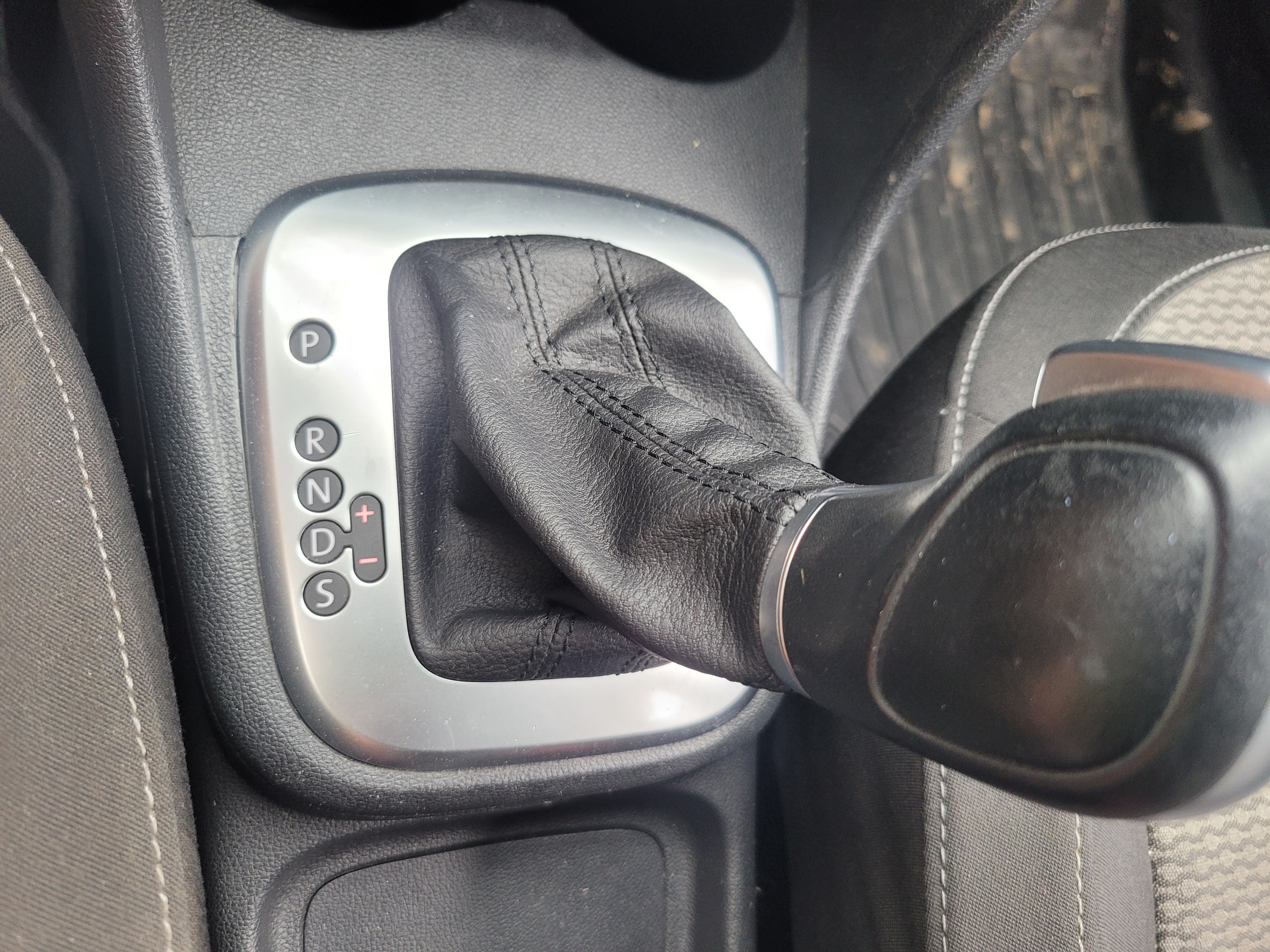

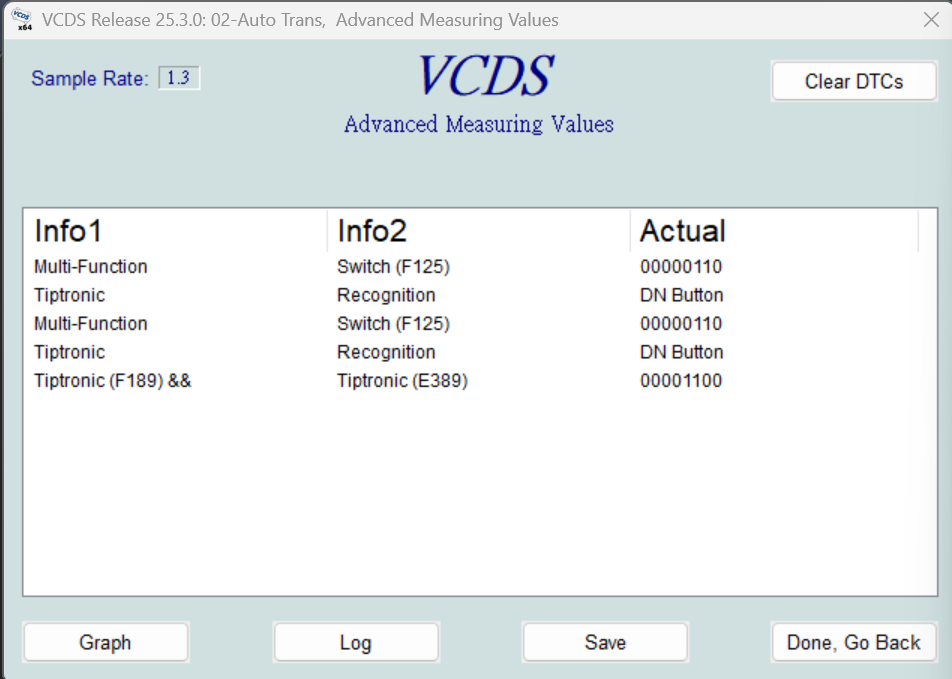

A few days ago, I tried to retrofit shift paddles (6C0 951 527) on my MFSW, but they didn't work either.
At first, I found the long coding for the transmission: Byte 1 Bit 5 — "Activation of steering wheel Tiptronic paddles (or high RPM?)."
References:
https://www.drive2.ru/l/510735521681507035/
https://www.drive2.ru/l/512637401919651996/
However, the shift paddles still didn’t respond after editing the long coding.
I then asked for help on a forum in Taiwan, and someone told me that the TCU (09G 927 750 LK) can't interpret signals from the shift paddles.

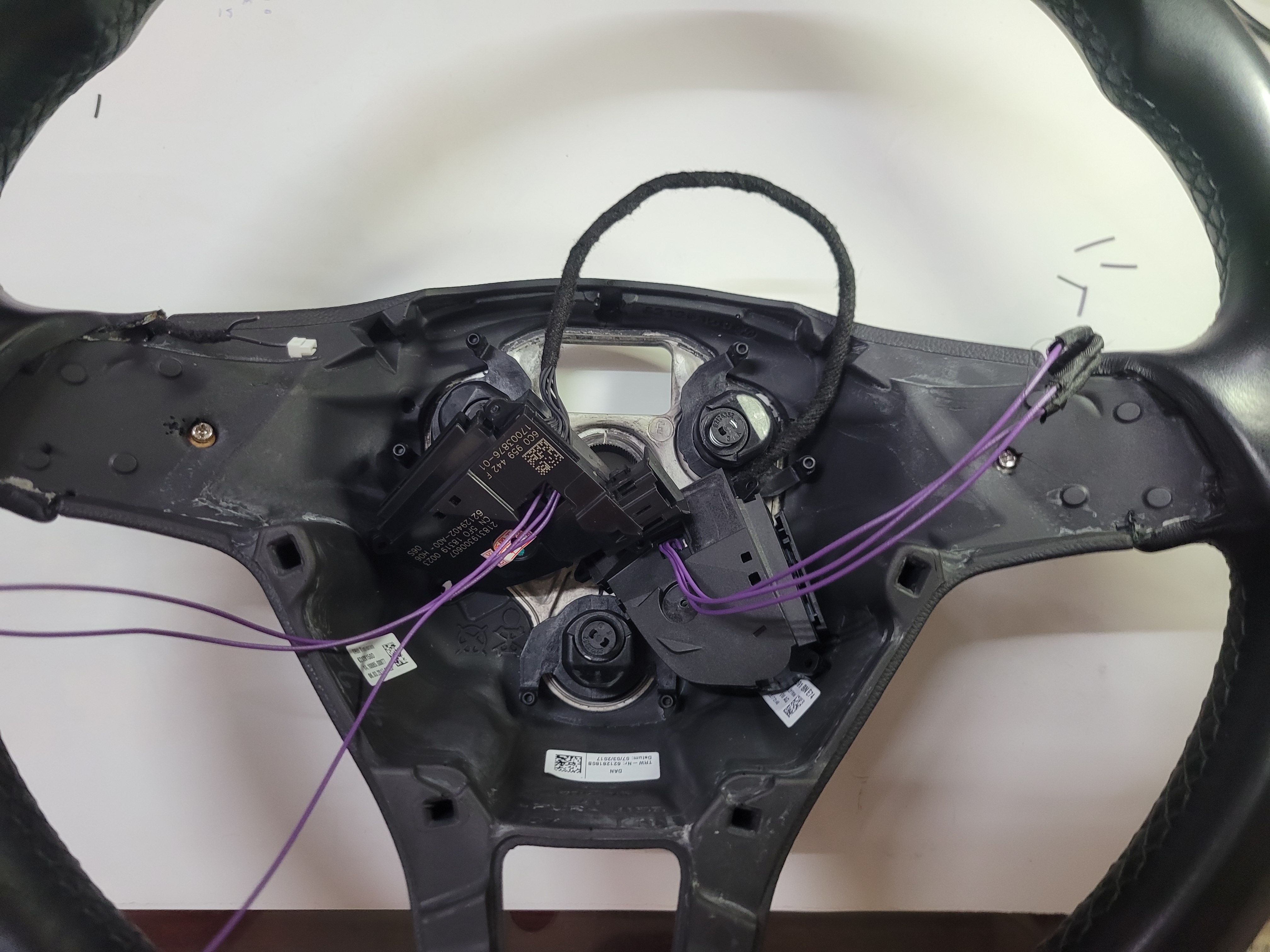

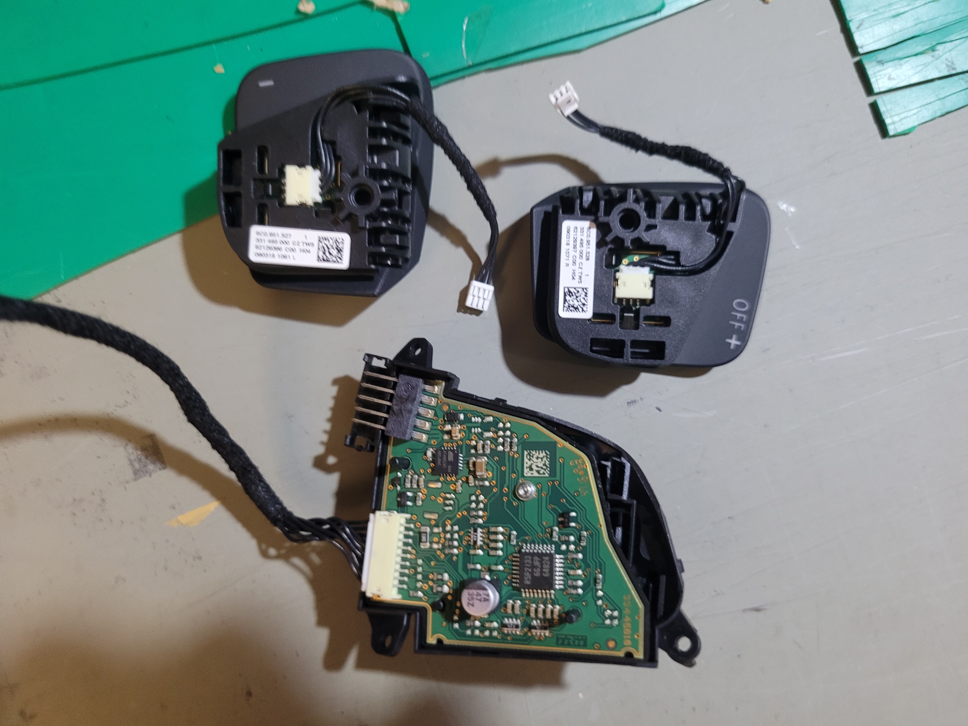

Is this true?
To retrofit the 6C0 951 527 shift paddles, it's necessary to solder a 33R0 (1206) SMD resistor and a connector (for the "+" and "–" paddle signals) using a soldering iron.
I heard that the resistor only affects the downshift paddle backlight, so I decided not to install it.
Also, since I didn't have the proper connector, I soldered wires directly to the contact points instead.
Currently, I suspect the issue could be one of the following:
1. The TCU doesn't actually support shift paddles.
2. The wiring might not have been properly connected during soldering.
can you read the measured values of the shifting paddles, in the bcm? you should be able to do this with vcds
sejuani
Posts: 51
Drives: POLO 6R
Location: Taiwan
Post by sejuani »
I couldn’t find the option about shift paddles under 'Advanced Measuring Values' in the BCM, so I checked 02 - Auto Trans. for 'Tiptronic' and 'Multi-Function'.
There’s no response in the parameters when I press the shift paddles.
However, when shifting between +, –, D, and S, the parameters display correctly

the "-" on the left paddle should also be illuminated
sejuani
Posts: 51
Drives: POLO 6R
Location: Taiwan
Post by sejuani »
iichel wrote: Thu Jul 31, 2025 6:16 am the "-" on the left paddle should also be illuminated
Finally, I soldered the resistor and the '-' symbol on the left paddle lit up.
But when I pressed the paddle, nothing happened.
