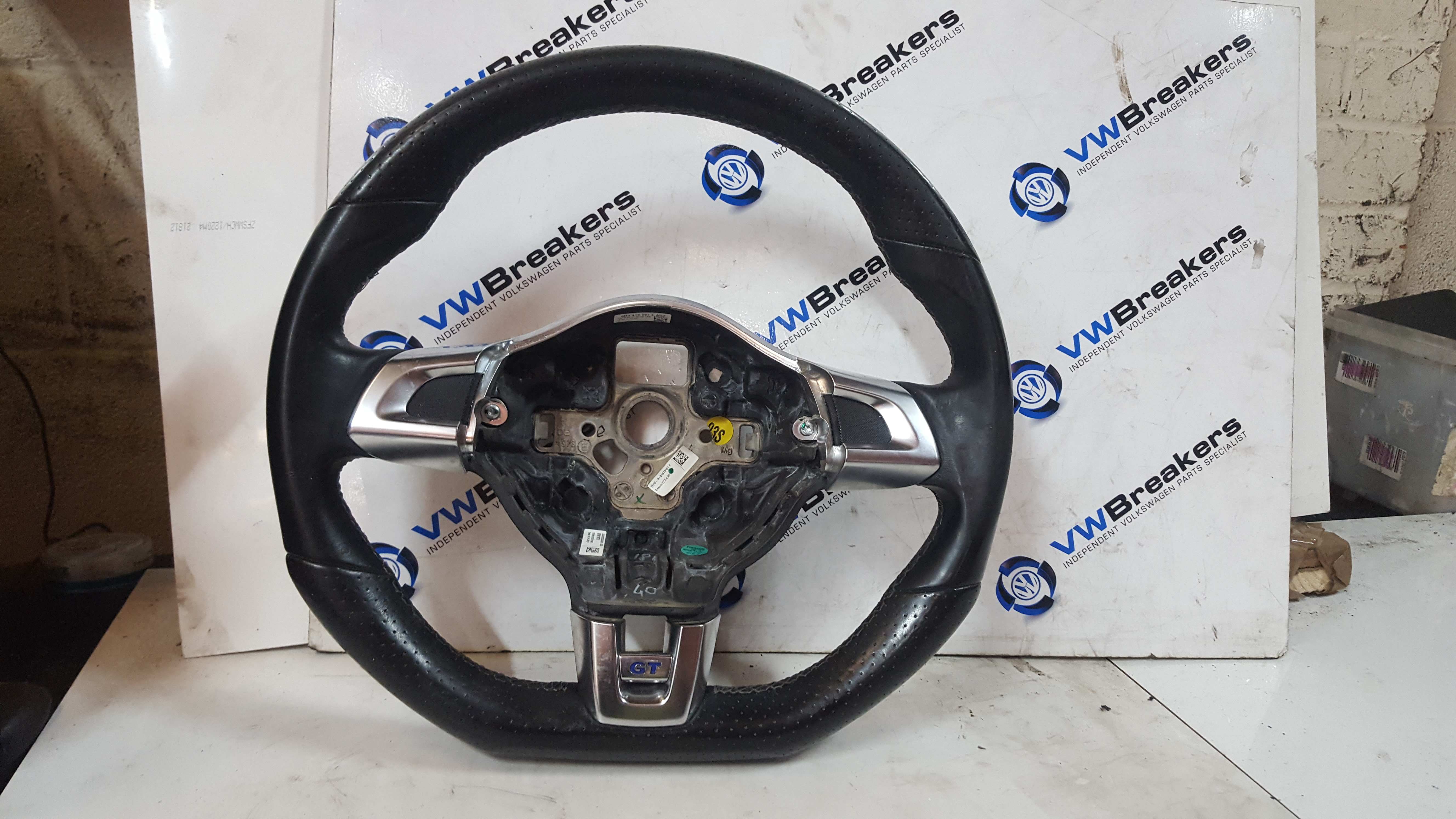

Hello guys,
I have the scirroco steering wheel on my polo (2010) is it possible
i can retrofit just the buttons ? Or do i need the whole steering wheel ?

iichel wrote: Sat Apr 19, 2025 4:05 pm I dont know. What wheel do you have now?
Hello buddy the Scirocco one that used to be only with the first GTI and GT if i remember correctly
I have seen only the multifunction buttons sometimes sold, so i was wondering if by removing the silver decoration of the wheel
you can place the mfa buttons there and then find an electrician to wire & code etc.

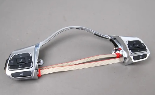

Posts: 8992
Re: MF BUTTONS

ciclo wrote: Thu Apr 24, 2025 1:13 pm The control unit: https://uk-polos.net/viewtopic.php?p=607100#p607100
thanx a lot Ciclo! Very helpfull cause i saw the module by accident yesterday BUT without the cables
and i was wondering how it looked etc!
Pretty straight forward!
