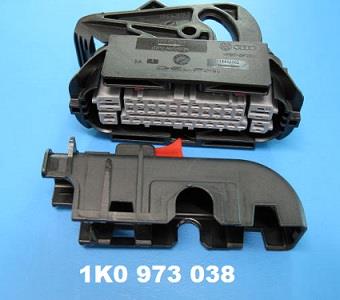

So I want to check the harness/cable from the wheel sensor to the abs pump/module, but I'm struggling to identify the correct pins on the module plug.
The rear left wheel connector plug is G46 and pin one goes to pin 33 on the pump module plug and pin 2 goes to pin 20. I think that is right?
But I cannot identify which pins are 33 and 20. As far as I can see, there are no number markings on the plug at all and I cannot find an image of the same plug online.
Can anybody point me where I might find a layout of the plug which shows pin positions?

JohnEds wrote: Wed Aug 27, 2025 10:07 am As far as I can see, there are no number markings on the plug at all and I cannot find an image of the same plug online.
:arrow: https://prom.ua/p1289470118-1k0973038-1k0-973.html

That's perfect iichel. Thanks for your help. I'm getting something like 0.9v at the wheel plug, which I think should be closer to 12v from what I've read. Hopefully this will enable me to track a fault and get it fixed.
Posts: 6694
Re: Polo 1.2 6r ABS module/connector pin positions
Rear left is 33 and 20. I'd recommend to test both wires for continiuty since you don't feel like the sensor itself is wrong, which you verified with a second sensor.
