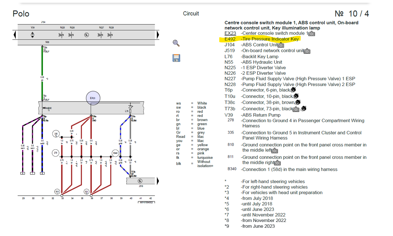

Hi

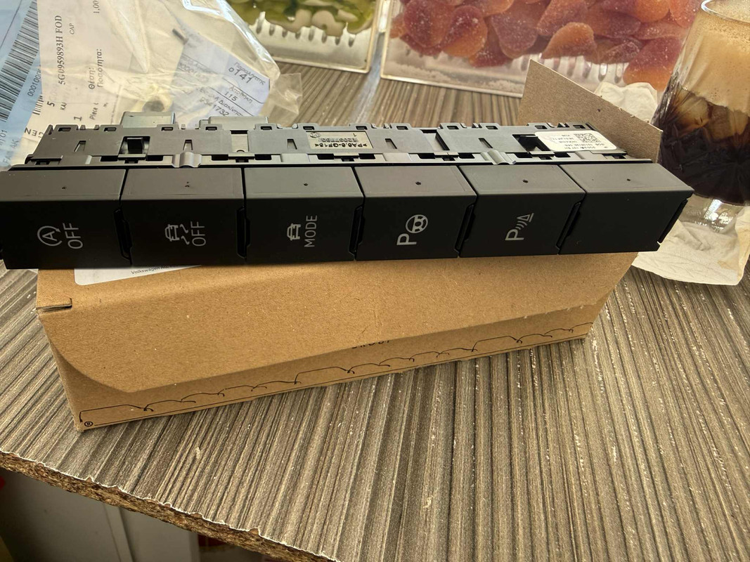

I have bought this buttons
I have search now in 4 days in ELSA to how connect ESP button

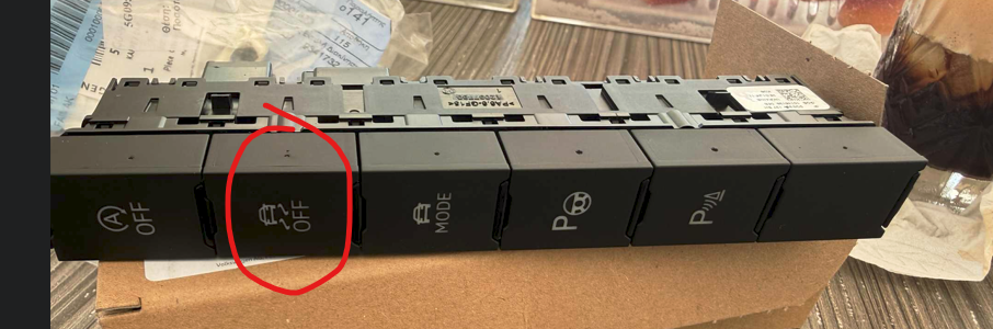

this
Do anybody know the pin for this and were it goes??
I have found all other buttons
thank you
Posts: 6689
Re: Installing center consol buttons
In your ABS computer, it will go into T38/12. On the other end I'm not sure.
vwtiguangreece
Posts: 3
Joined: Sat Sep 14, 2024 12:15 pm
Drives: Golf
Location: Greece
Post by vwtiguangreece »
Something is not right
i see this in ELSA
