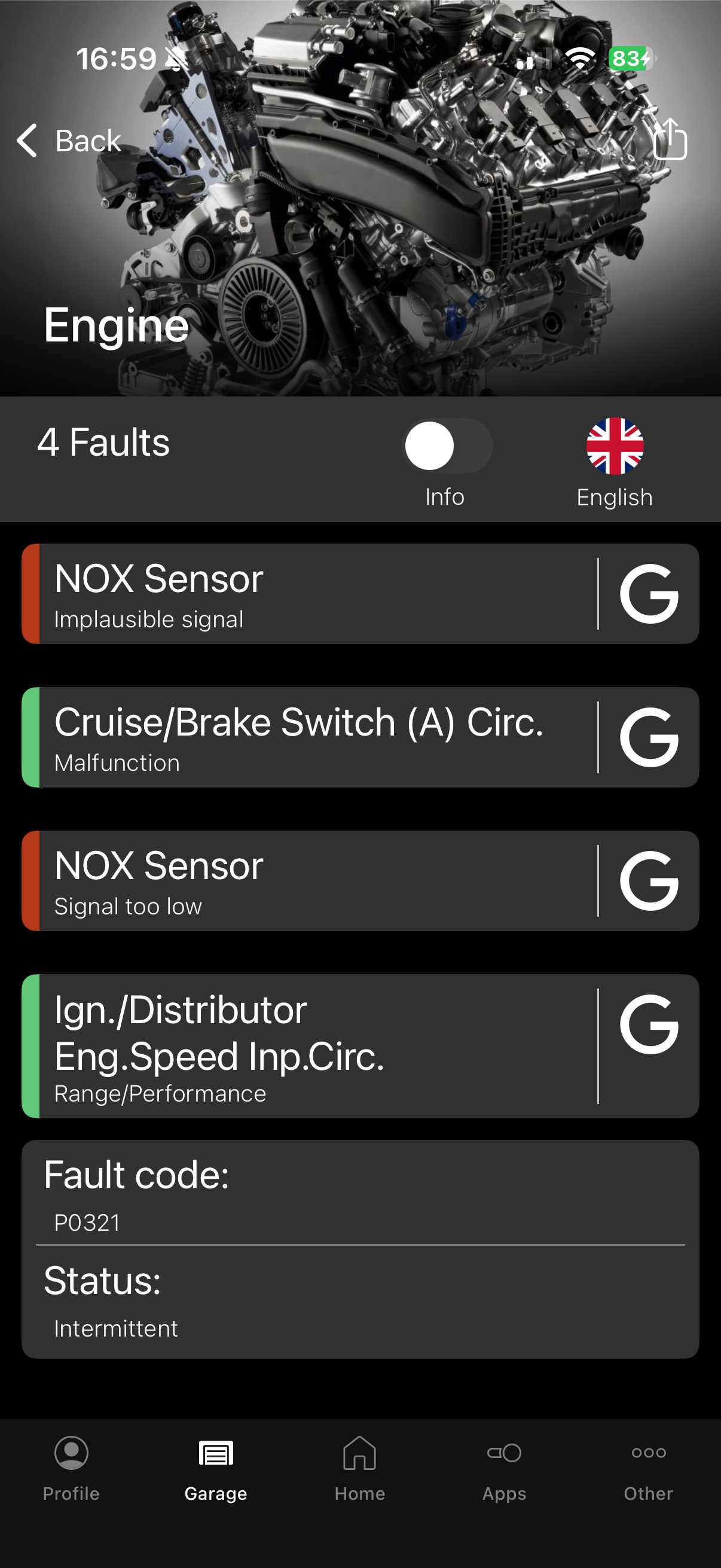

ImageGood afternoon
My friend has a 2006 polo 1.4fsi and is learning to drive on it. It’s been driving absolutely fine until he stalled it quite badly and it now won’t start.
I’ve checked for spark and there is some but on one cylinder it’s a bit weak but I’m not too worried about that as surely it would start or at least try and misfire. I can smell fuel with the spark plugs out and I can hear the pump priming with ignition. I’ve scanned for codes and I’ve attached a screenshot of the codes. The NOX code was there before so I highly doubt it’s that. Also the P0321 code I’m not sure about as the rpm gauge moves and shows a strong starting rpm, I’ve also checked to make sure the crankshaft speed sensor is plugged in and it is.
What’s worrying me is the engine turning over sounds like there’s no compression. It sounds the same turning over with the spark plugs out and in. I believe these engines are timing chain. I can’t hear any tapping of knocking when turning over and no rattling.

Please do a compression test. the fact that it sounds the same with plugs in or out is worrying
