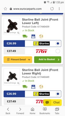

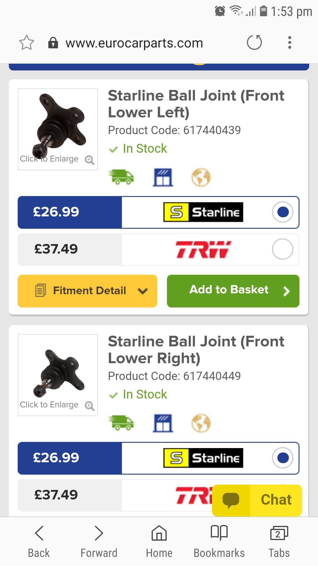

Just been on the euros website and they have left and right for my car which look handed in the pics, are these the right ones?

Part numbers are in the other thread, I suggest you call ECP and try those as I know they are correct.
Or just try changing to the quality supplier, might bring up the same part number

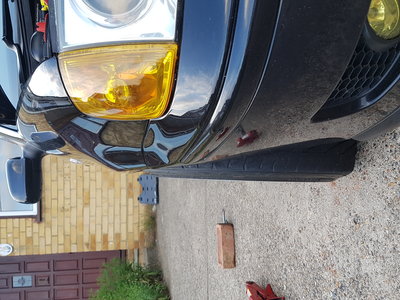

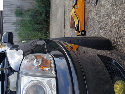

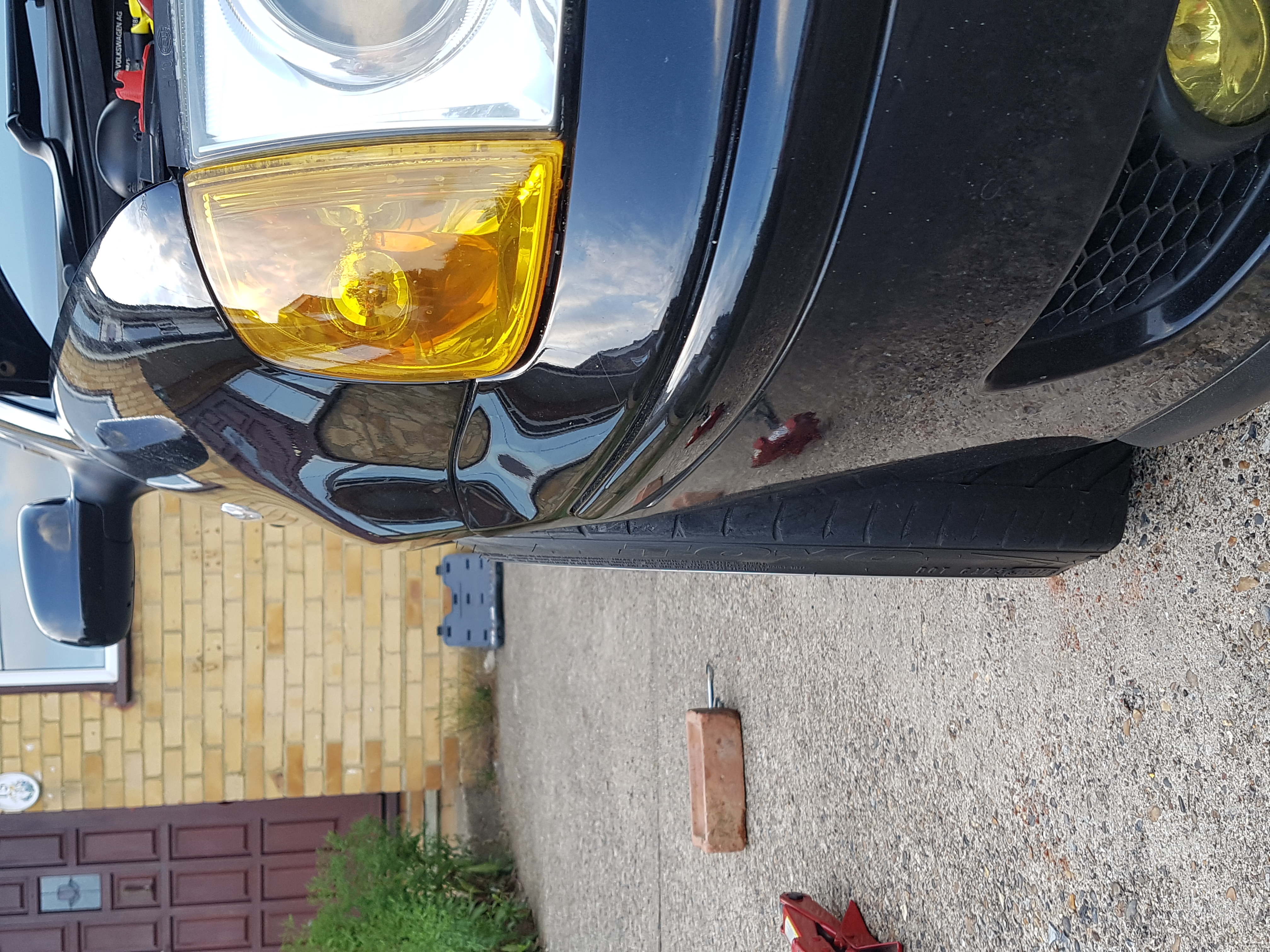

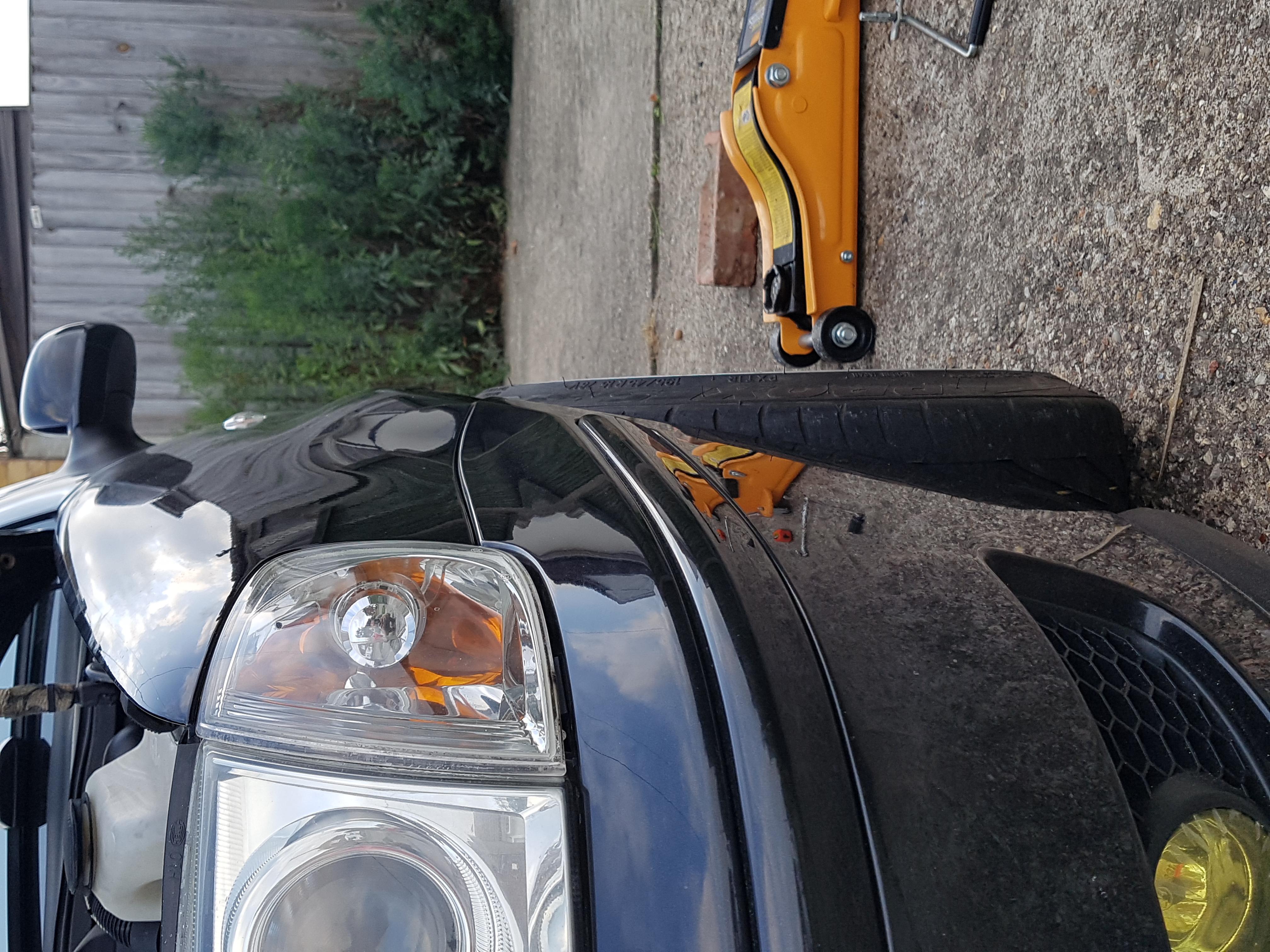

Hello again, I really appreciate everyone's help by the way, so today I swapped the ball joints over and they now look like they are sitting properly, the hub is now touching the nuts and is more central how it should be but I still can't figure out why my driver wheel is sticking out about 10mm more than the drivers side....
Passenger side Drivers side I did roll the arches slightly, years ago but I don't think that is the problem, it's very weird, the problem could also be that the drivers wheel is right and the passenger side is sitting in......who knows......baffled.

Get the tracking camber and castor adjusted And go from there
