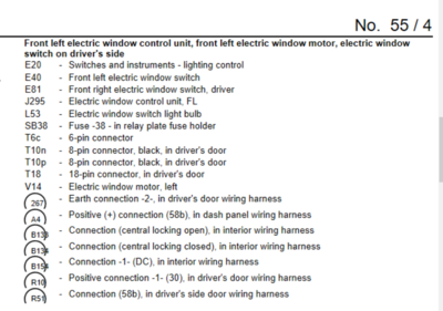

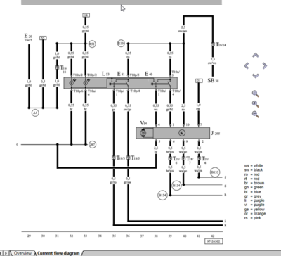

Can someone please help me with either a pic or pin assignments of the RHD driver door window switch?
Got a Polo 6N with missing door panel and window switch wires removed from connector.

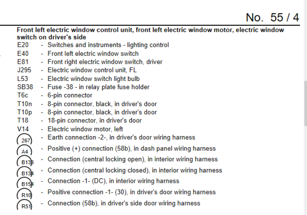

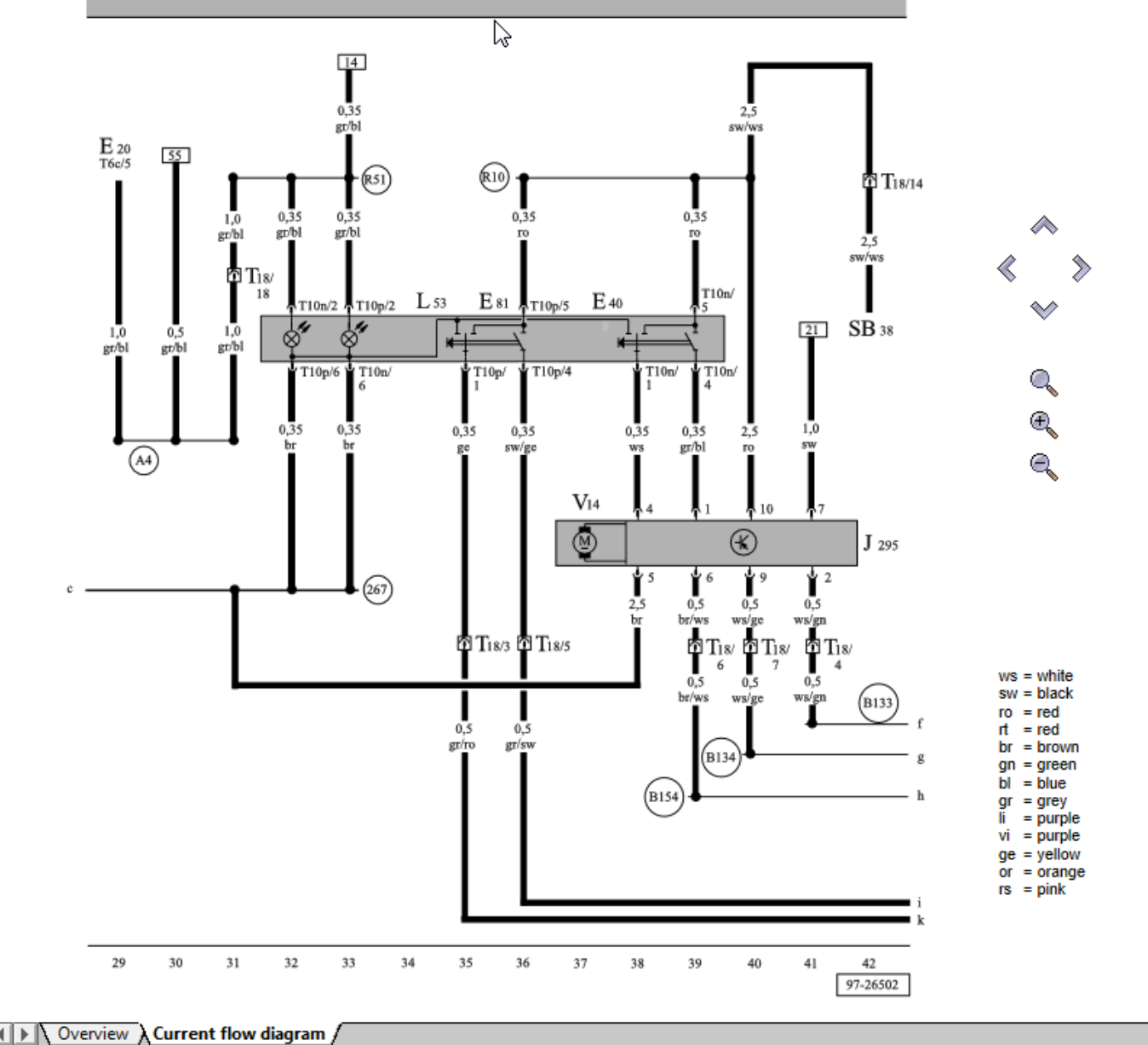

Here you go
Wire colours where they are two colours, like gr/bl are grey with a blue stripe
E81 is the switch itself, L53 and E40 are part of the same setup, so look at the main block in the middle.
