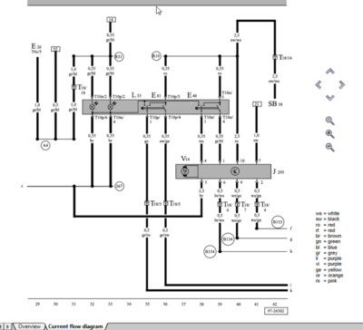

Got a Polo 6N with missing door panel and window switch wires removed from connector.
I add the passenger side pic too so you can see what mine looks like
Sent from my SM-N920I using Tapatalk

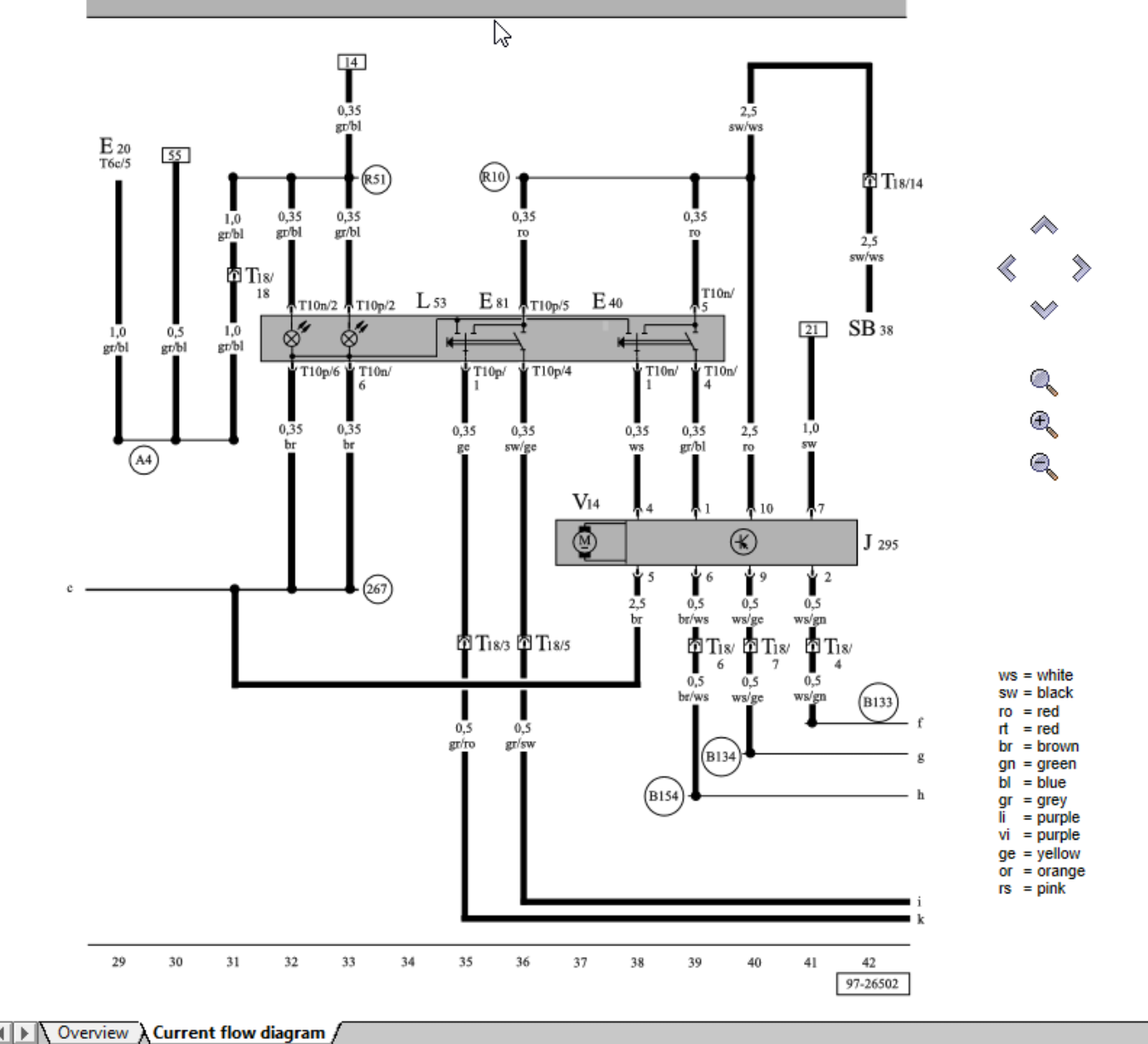

Thanks Alex. Getting a new door panel with switch and will try and get everything connected back to normal.alexperkins wrote:Here you go
Wire colours where they are two colours, like gr/bl are grey with a blue stripe

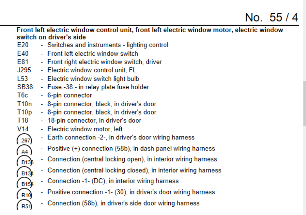

E81 is the switch itself, L53 and E40 are part of the same setup, so look at the main block in the middle.
