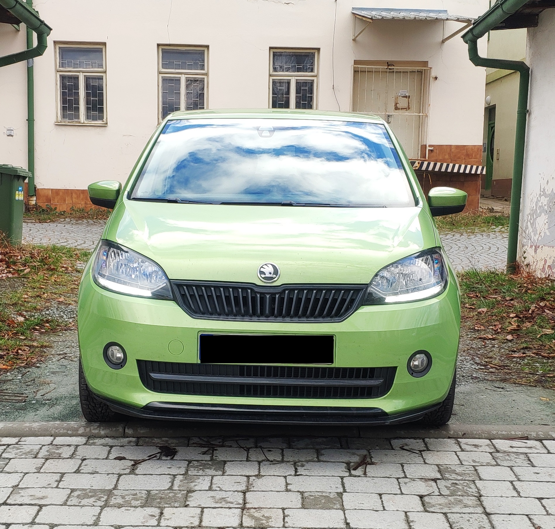

danikd wrote: Thu Dec 06, 2018 9:15 pm Seem sto be OK, man have to look at DLR from little distance ...
Re: BCM Max PQ25, adaptation. Automatic lights. Skoda Citigo/VW Up!
DLR seems to be OK ...
Main reason was light output - old H1 headlights - only low or beam was working ... New 2xH7 - both bulbs are lightning in highbeam, so its much better ... And they looks better ...
- Posts: 8844
Wow! It's really beautiful.
Thanks for the picture.
