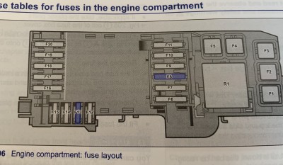

Tip 5:
There are some empty slots in the fuse box. If you do an OEM retrofit (i.e. PDC) it's probably handy to use the OEM fuse location.

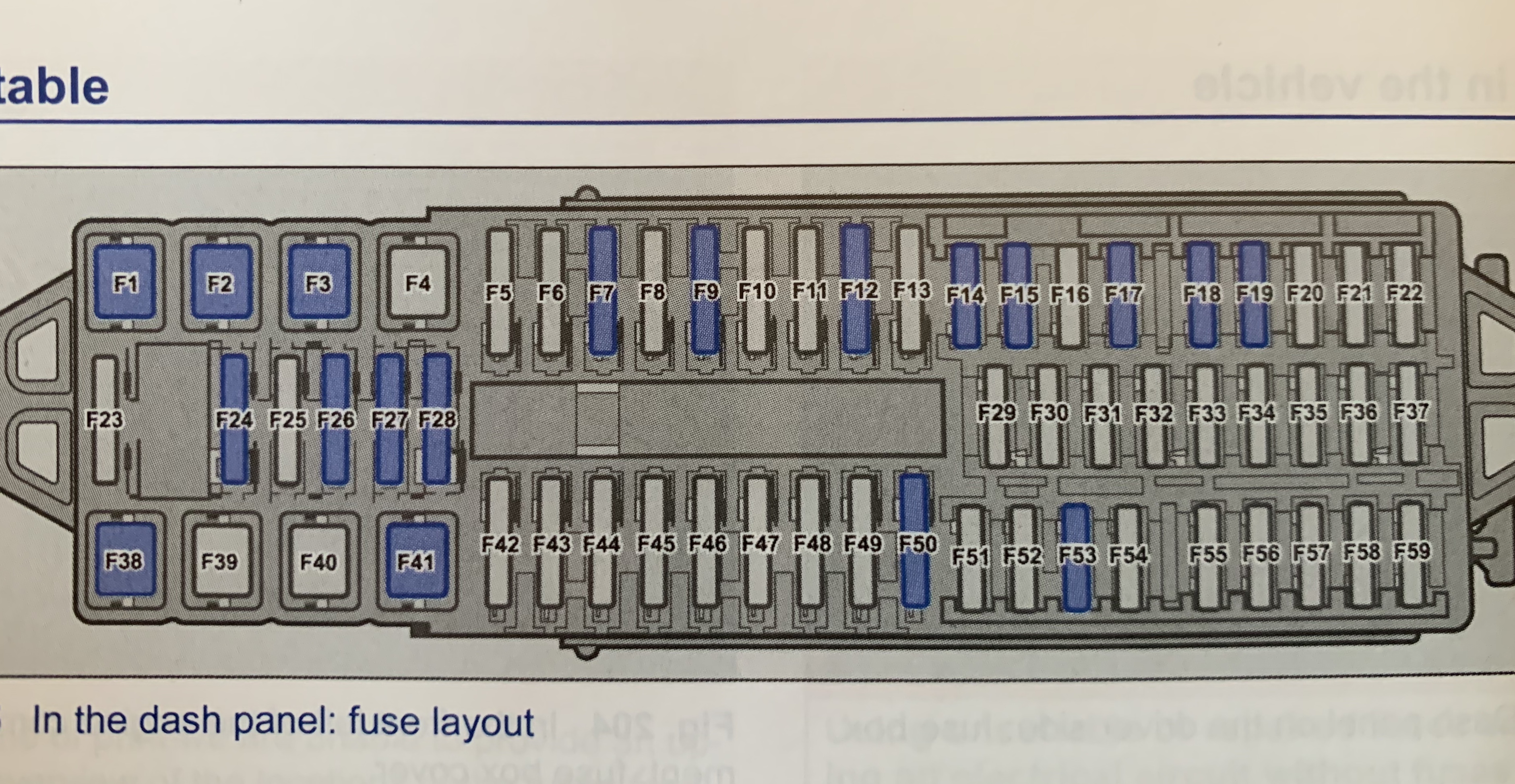

For the 6R, this is the layout of the fuse box (thanks to ciclo):

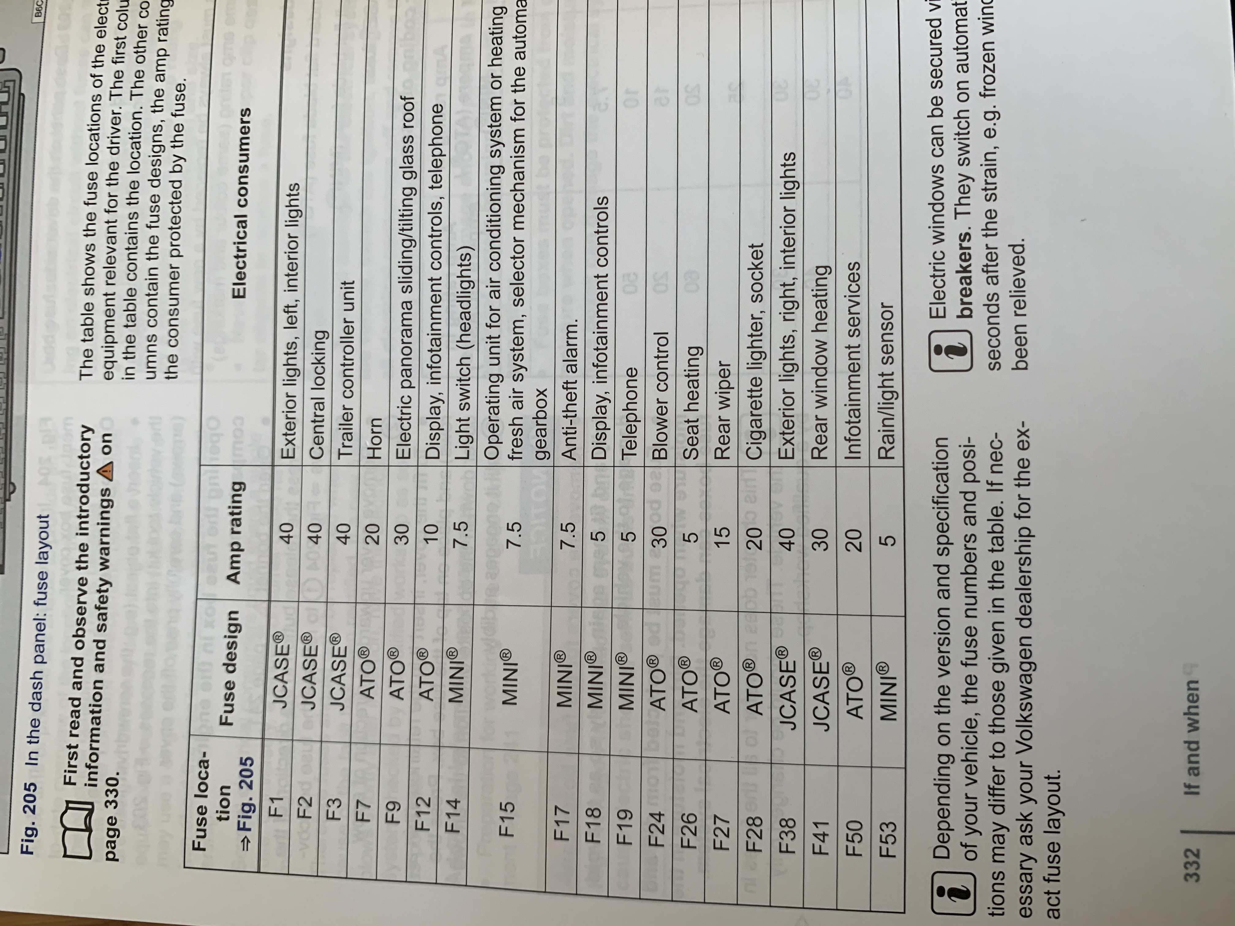

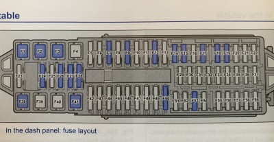

Hi. Please can you help me fix my daughters car. 1st time on here so apologise if I post in the wrong place.
My daughters polo 6R 2010 has 3 electrical faults which all appeared at the same time whilst a friend was fitting some lights.
Electric windows not working (stuck open and it keep raining)
Indicators not working (but hazard warning do work)
Windscreen wiper not working.
Do these have the same fuse or relay. Cant find any of them on the fuse diagram.
Posts: 6685
Re: Fuse overview VW Polo 6R and 6C
Does the ignition switch on?
I cannot think of a single fuse to cause this, perhaps the BCM is broken.
But I'd suggest to first check all the fuses below the steering one by one with a multimeter or, if there is not a multimeter, with a flash llight.
paul.goodman
Joined: Tue Jun 16, 2020 7:04 pm
Post by paul.goodman »
I re-checked every fuse and found fuse F11 had blown. Replaced it and now wipers, indicators and electric windows work. VERY HAPPY!! :lol:
Posts: 6685
Cheers buddy, happy it worked out.
