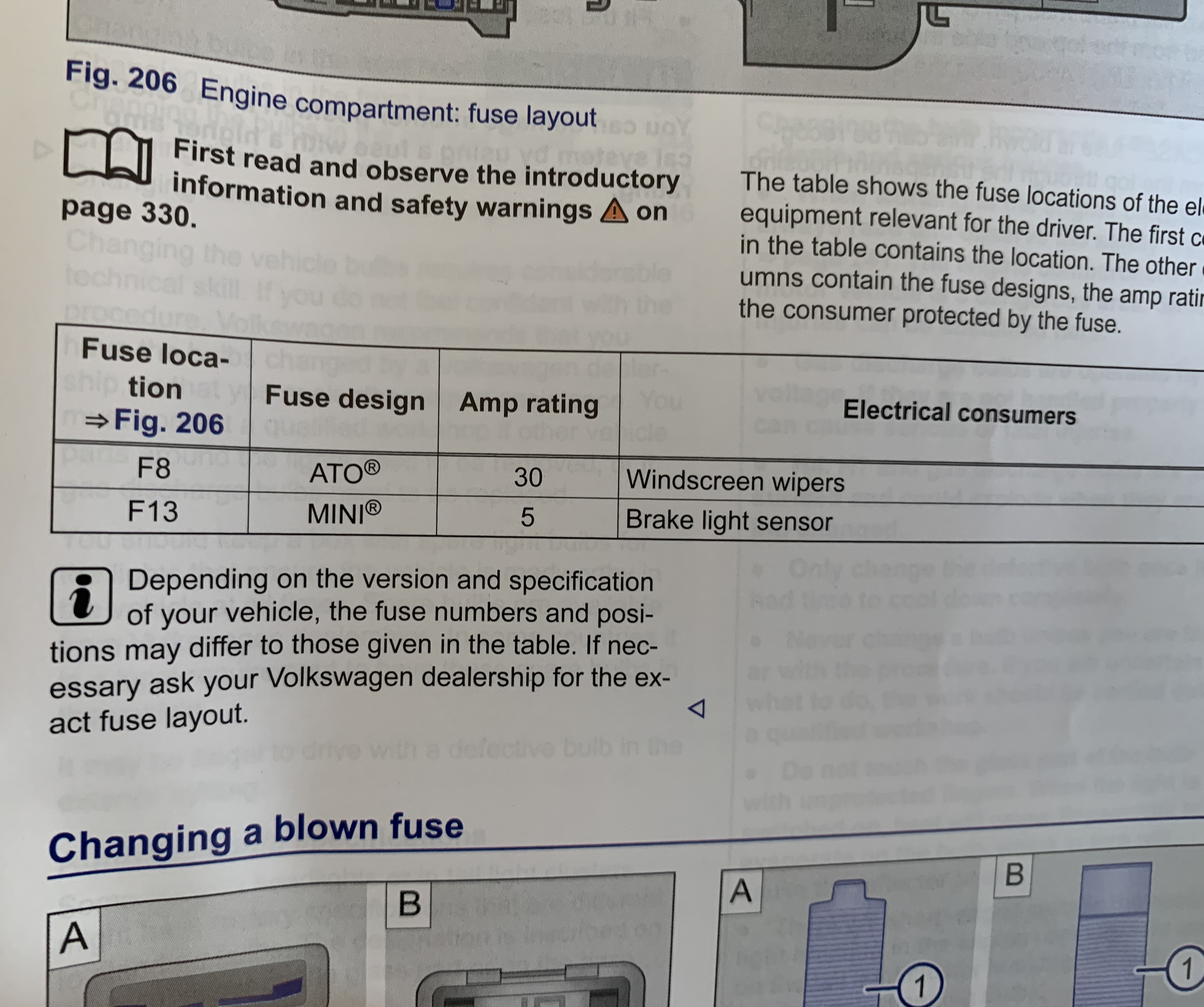

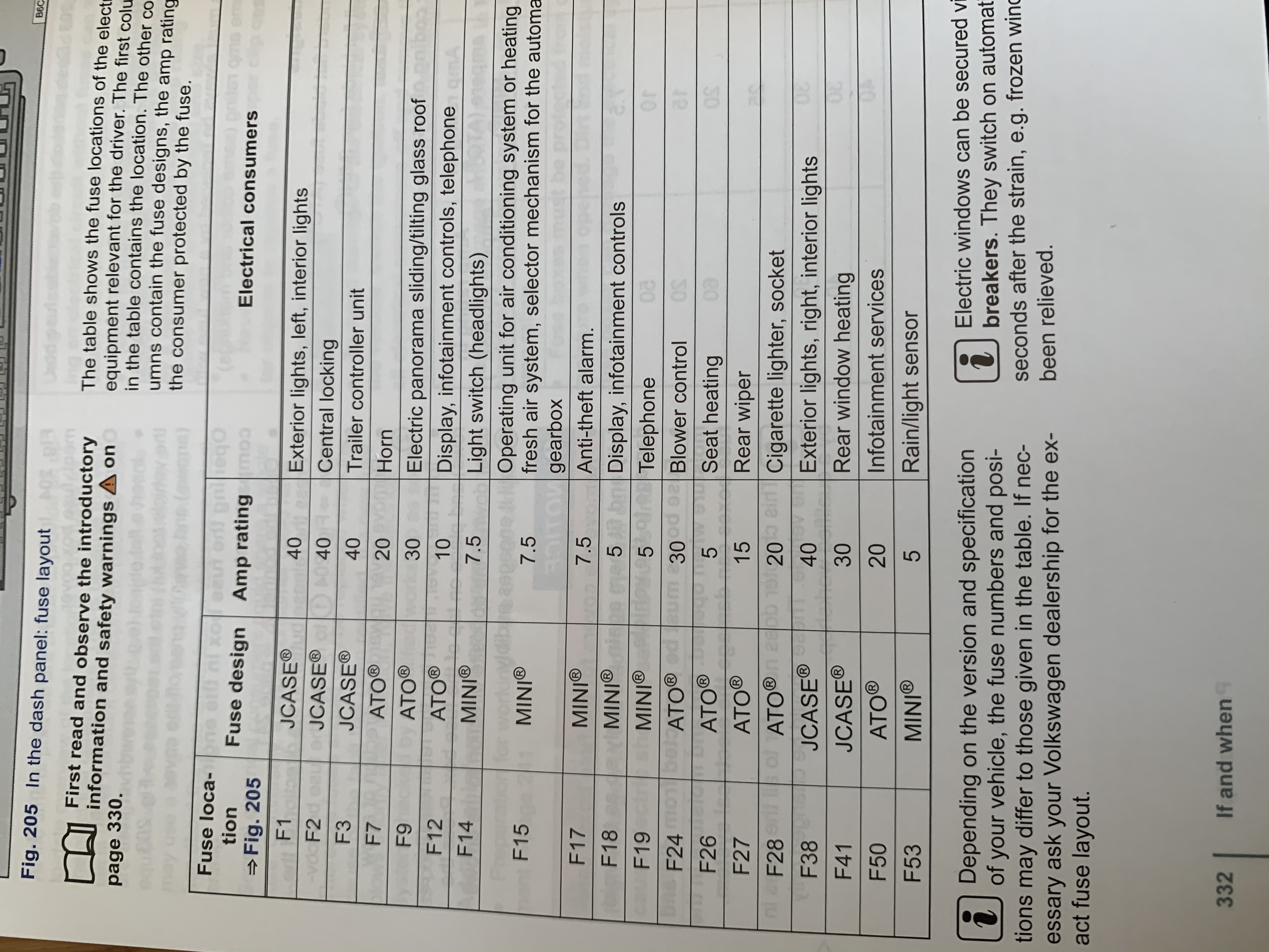

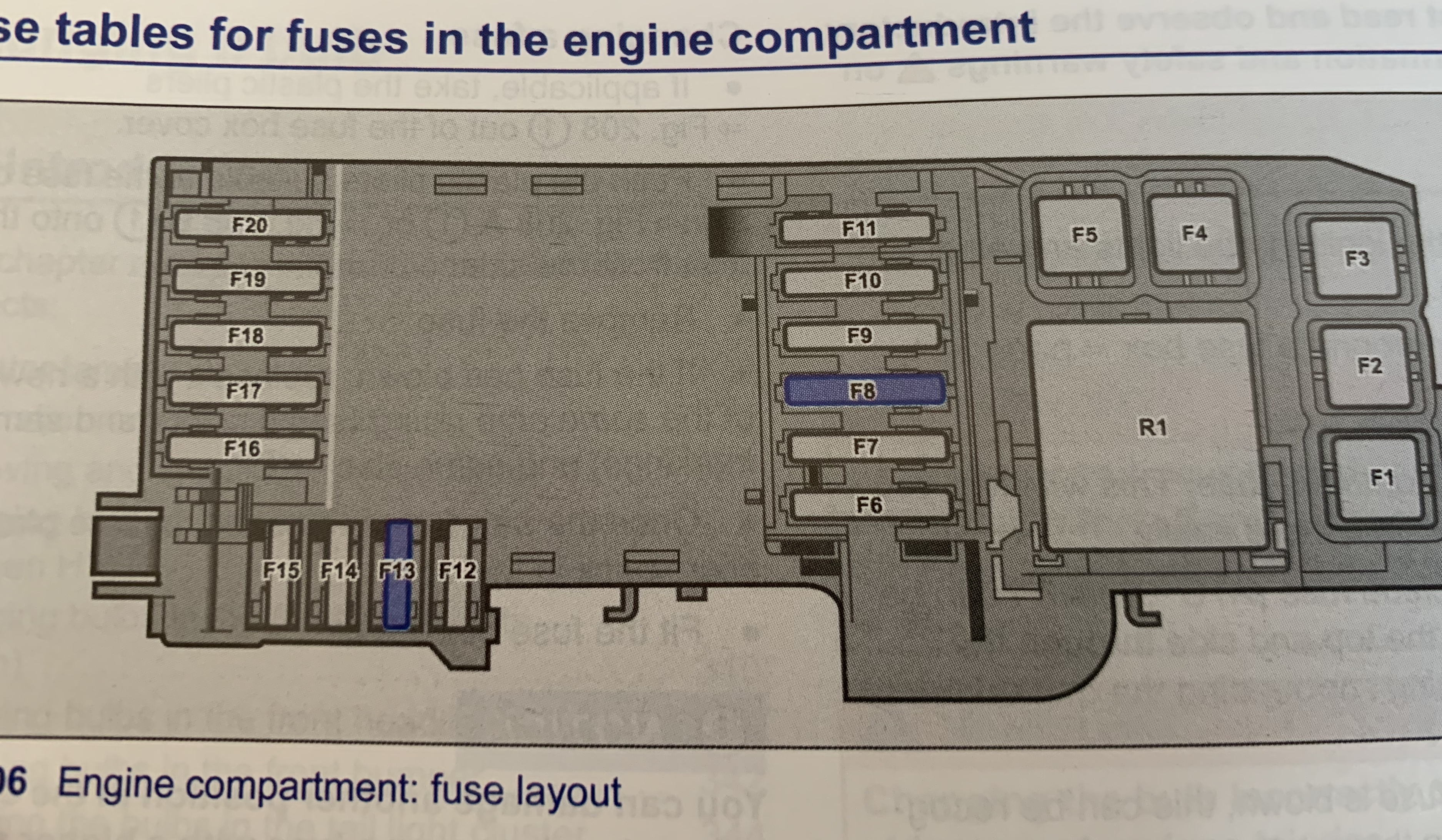

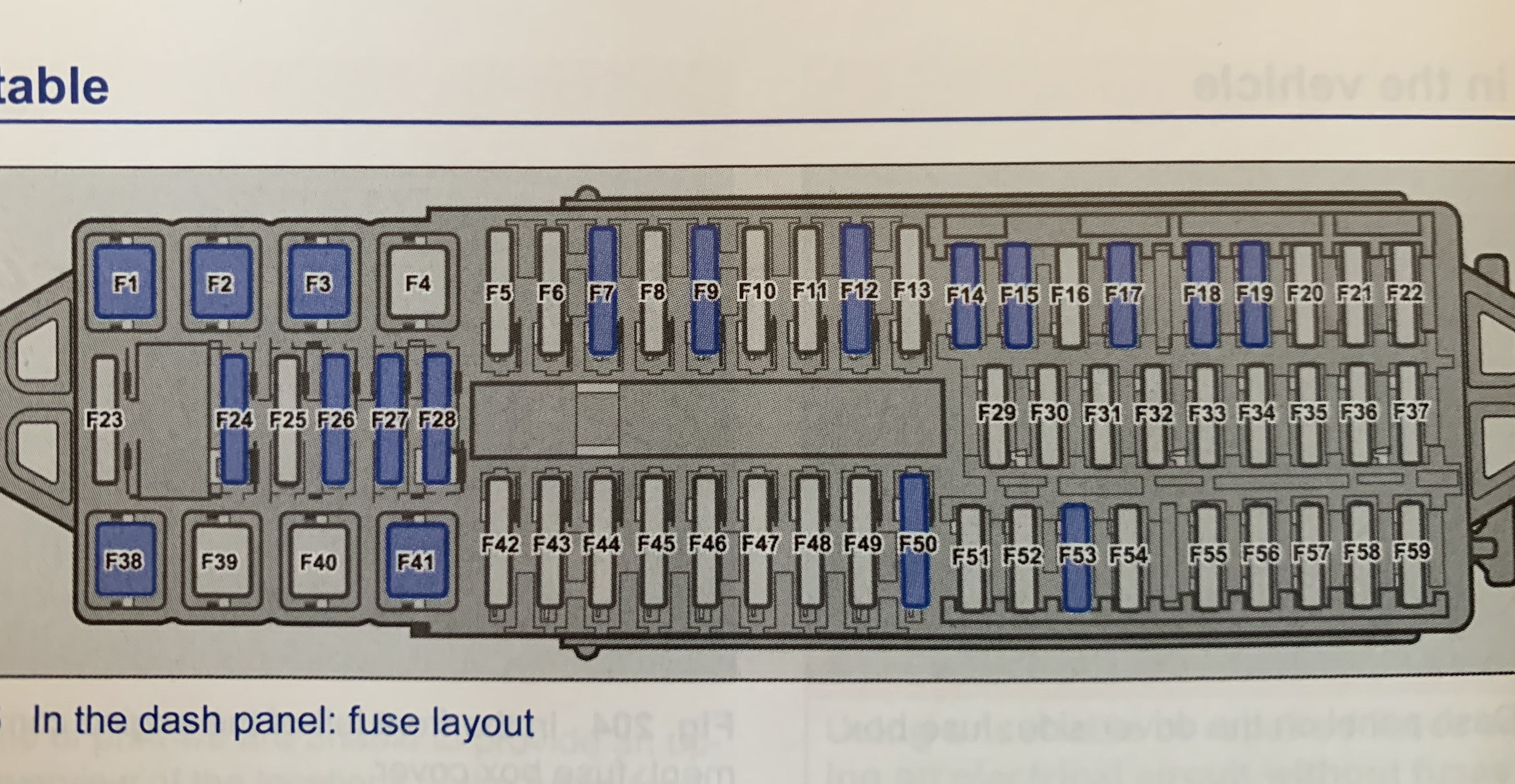

Re: Fuse overview VW Polo 6R and 6C
Post by Robbo770 »
2014 fuse illustrations for 6c motors
