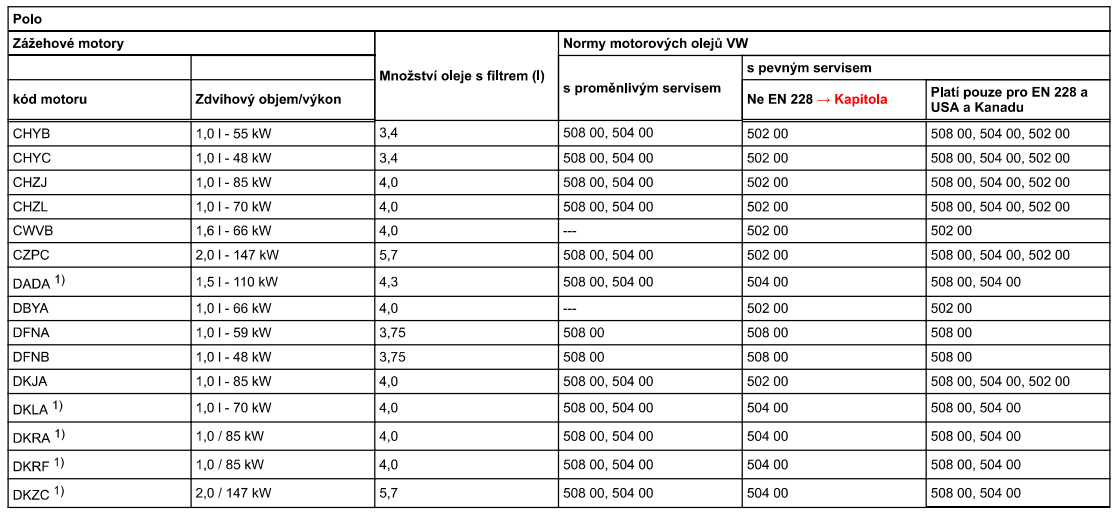

I think it is wrong oil for any new polo. This is picture from erWin. sorry it is in czech language. I looked a little and from what i found that magnatec is not VW 508 nor 504 norm.

Yeah you are right but in the manual says that if my car hasn't opf i can use 502 00 which is 5w40...how i can find if my polo has opf?

There is Euro 6 and Euro 6d. If your polo have Euro 6d then you have OPF for sure. New 6d norm came around september last year. Iam not sure about 1.0TSI before new EU norm.
