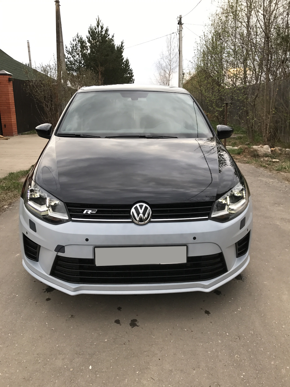

Keep in mind that this has never been done by factory on a WRC. That means you'll have to determine to location of the front holes yourself on the front bumper

i saw this:
on one russian forum, and one more thing:

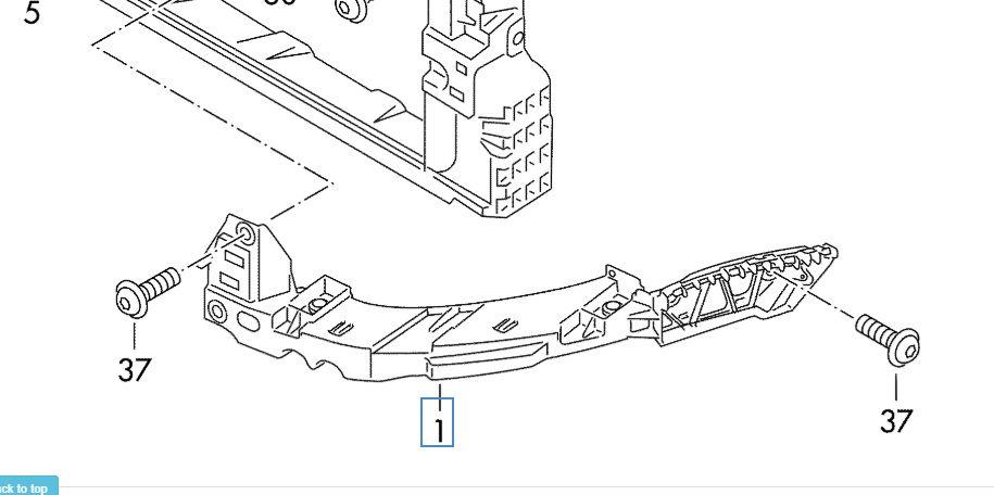

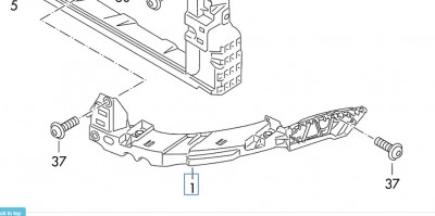

- also planing to install front WRC bumper, already know all part numbers, and do i need to replace the bracket for front bumper?

What do you mean by front bracket?

Re: WRC Rear bumper part numbers
I mean bracket for the front bumper...but i think they are the same

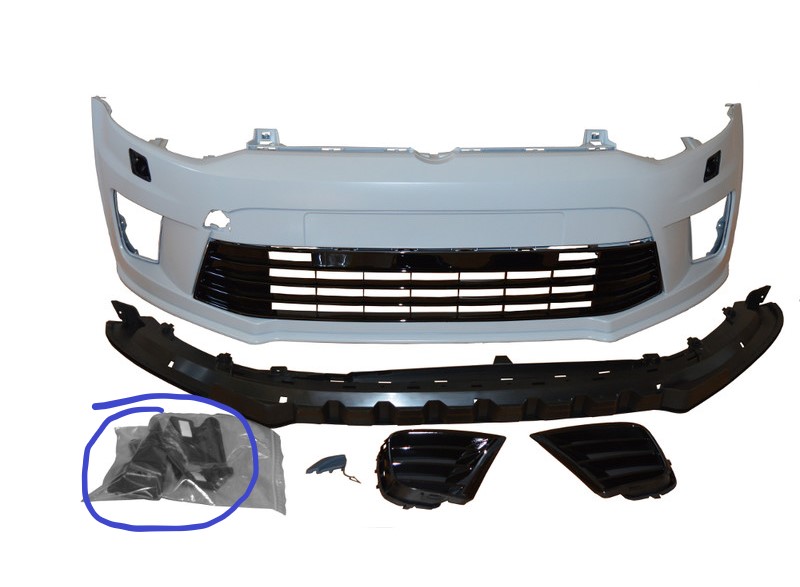

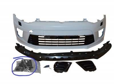

i saw this set: and wondering what is that in the bag?

I still don't quite understand what you mean by bracket. In the bag are the foam inserts that go on top of the metal inner bumper. You can keep the old ones.

my mistake: this is called "mounting for main beam headl"
According to Etka, this mounting is the same for all. One more wondering: what is the max rims size for ours polo's. I found that original WRC rims is with following specs: 7.5 J x 18" ET:46, PCD 5x100, so can i go on 7.5 J x 18" ET 42, PCD 5x100, without any modification ? or should i go with 7J x 17" ET 46?
