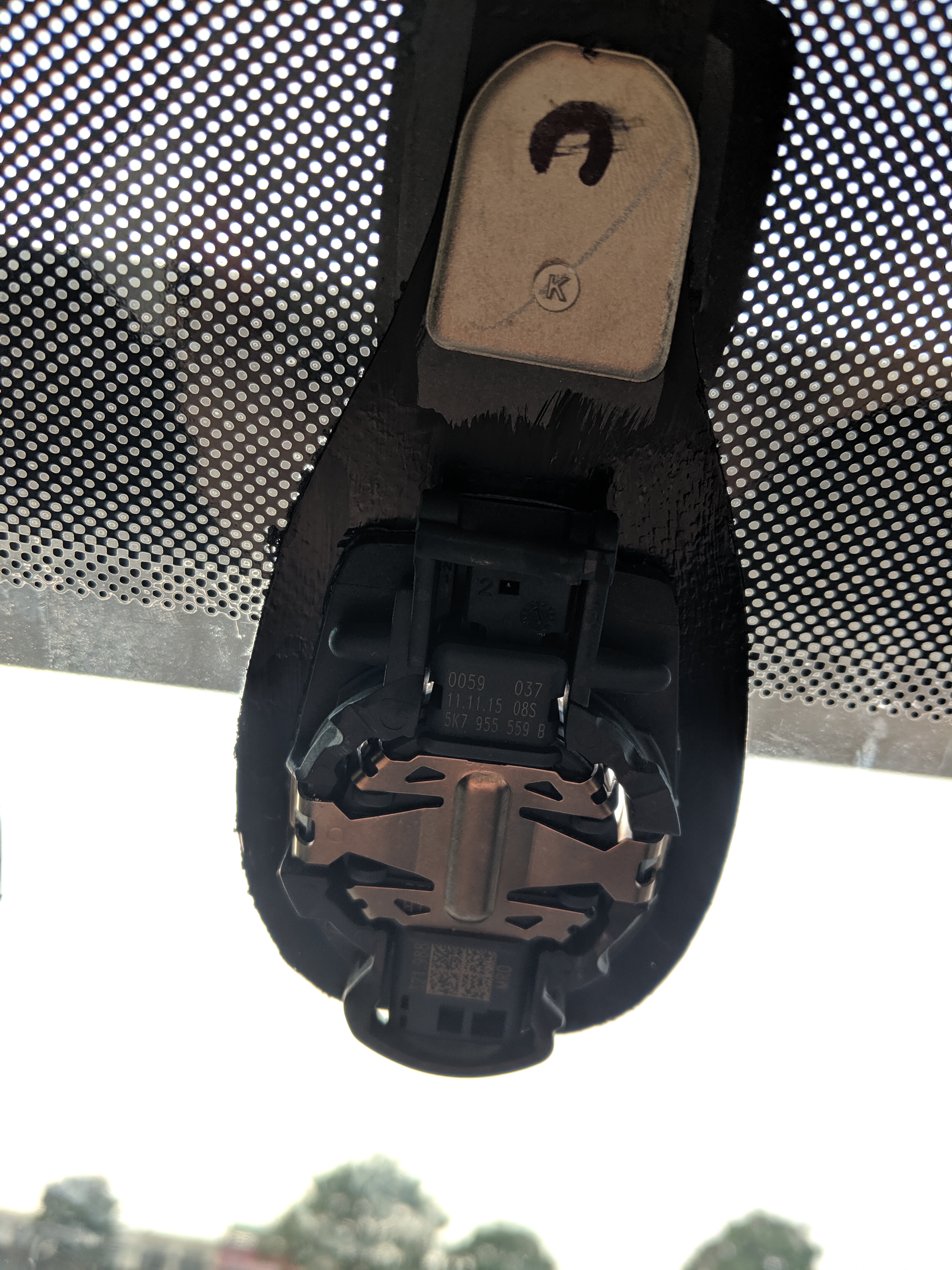

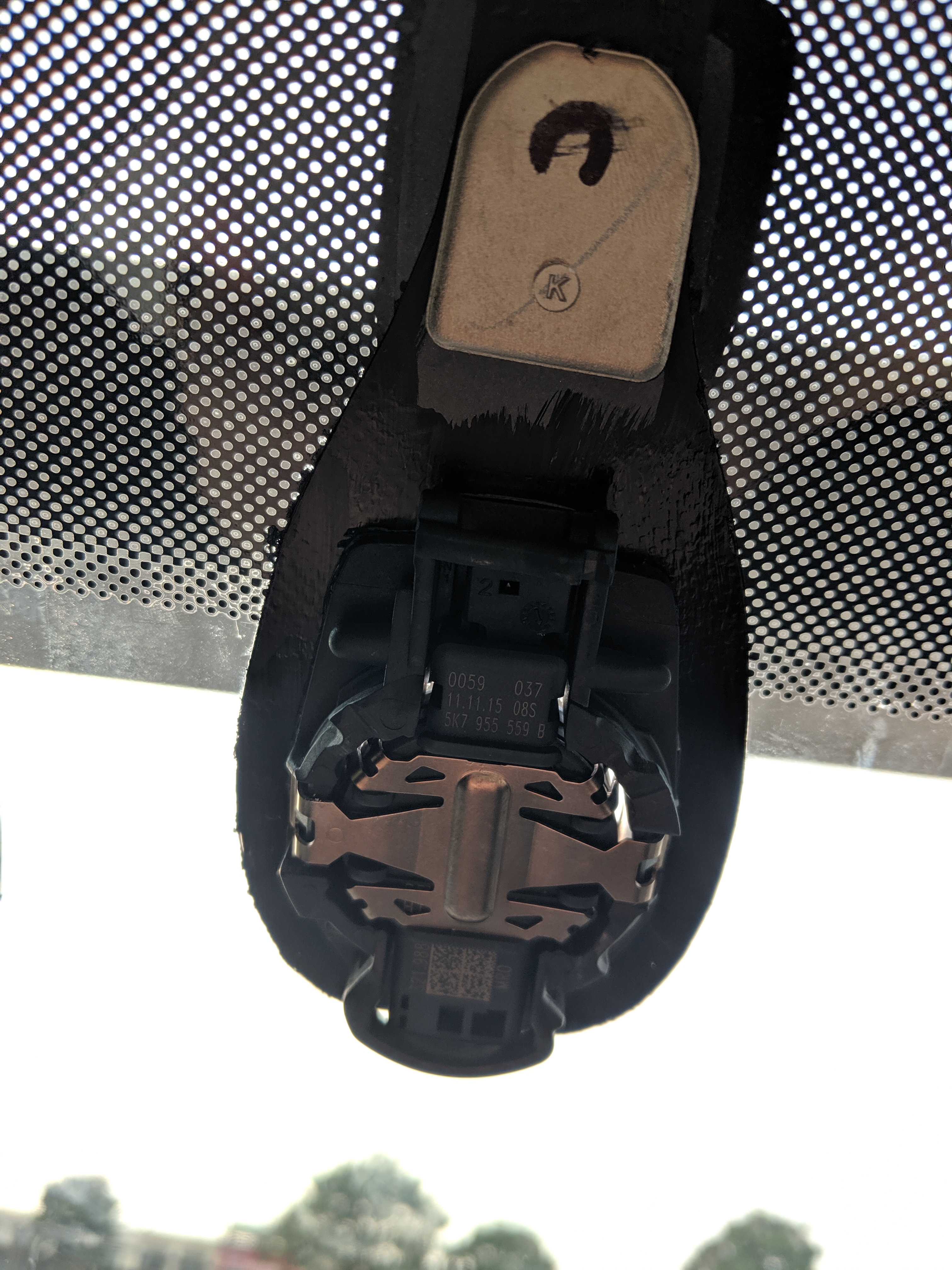

Jerryncg93 wrote: Mon Jul 08, 2019 11:13 am As the previous set of rls doesn't work very well, the seller has sent me another set of rls. This time it's 5k7 955 559b, but the sensor seems to be very dirty, may I know how can I clean it up?
What kind of glue should I use to paste the bracket to my windscreen? I'm planning to stick a black sticker with the shape of the cover then paste the bracket onto the sticker, dunno if it works?
can you guide me on this?
Posts: 8913
Re: RLS ,CH/LH , Auto lights , Rain sensing wiper & Auto dimming Rear view mirror on Vento
Clean the gel foil for the rain sensor with distilled/clean water.
-Do not use cloth, use your finger moistened abundantly with distilled water.
-Do not touch the gel foil with dry fingers.
-Prevent water from coming into contact with the electronic part of the sensor.
-Dry with air if required.
The procedure you have in mind to stick the bracket is not appropriate, it will not work. The black sticker can not hold the weight of the mirror.
Examples:
viewtopic.php?f=56&t=58703&p=502496#p502568
viewtopic.php?f=56&t=70545&hilit=slavik ... 90#p534599
Look for more information with your browser.
Primer and glue (2k).

Is the primer makes the area black in color? I can't find the original 2k glue here in Malaysia, perhaps i'll go for aftermarket brands for it.

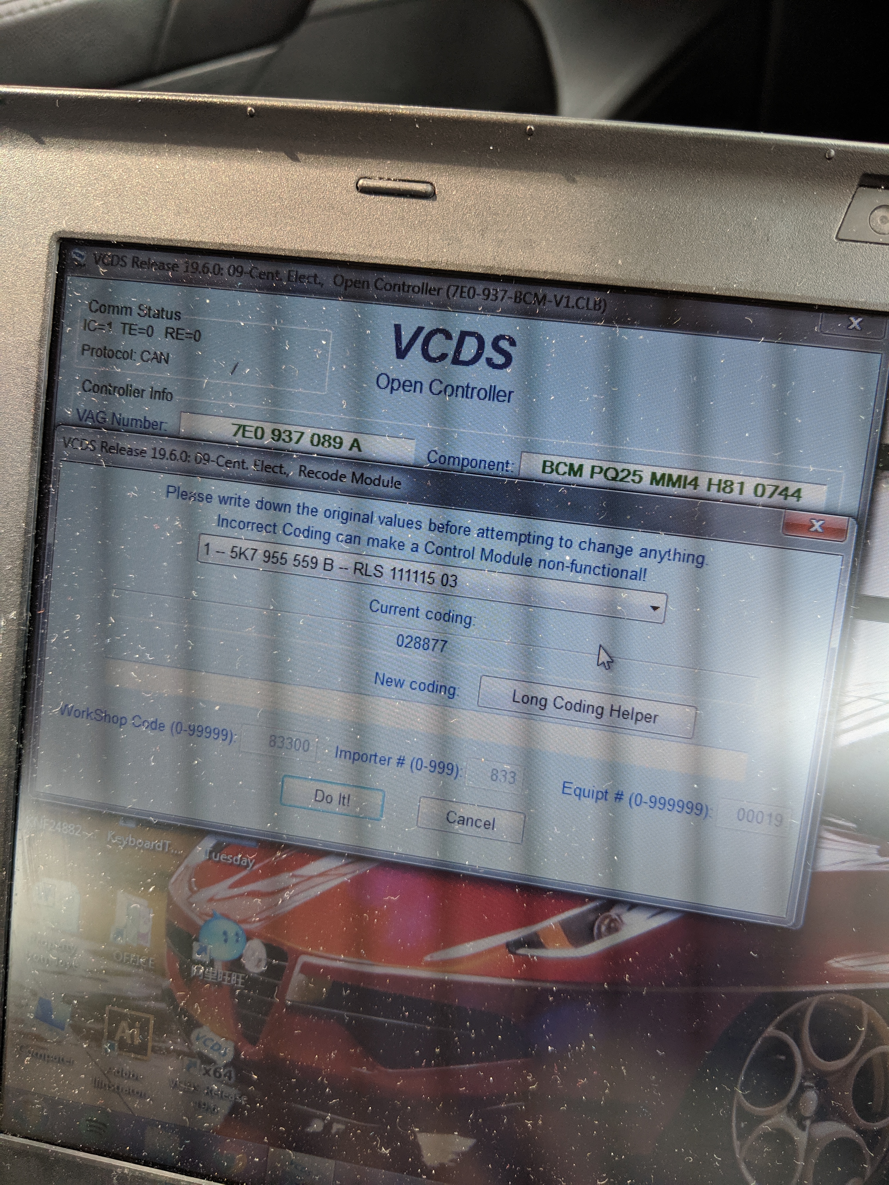

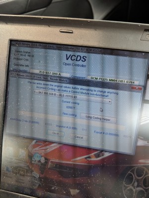

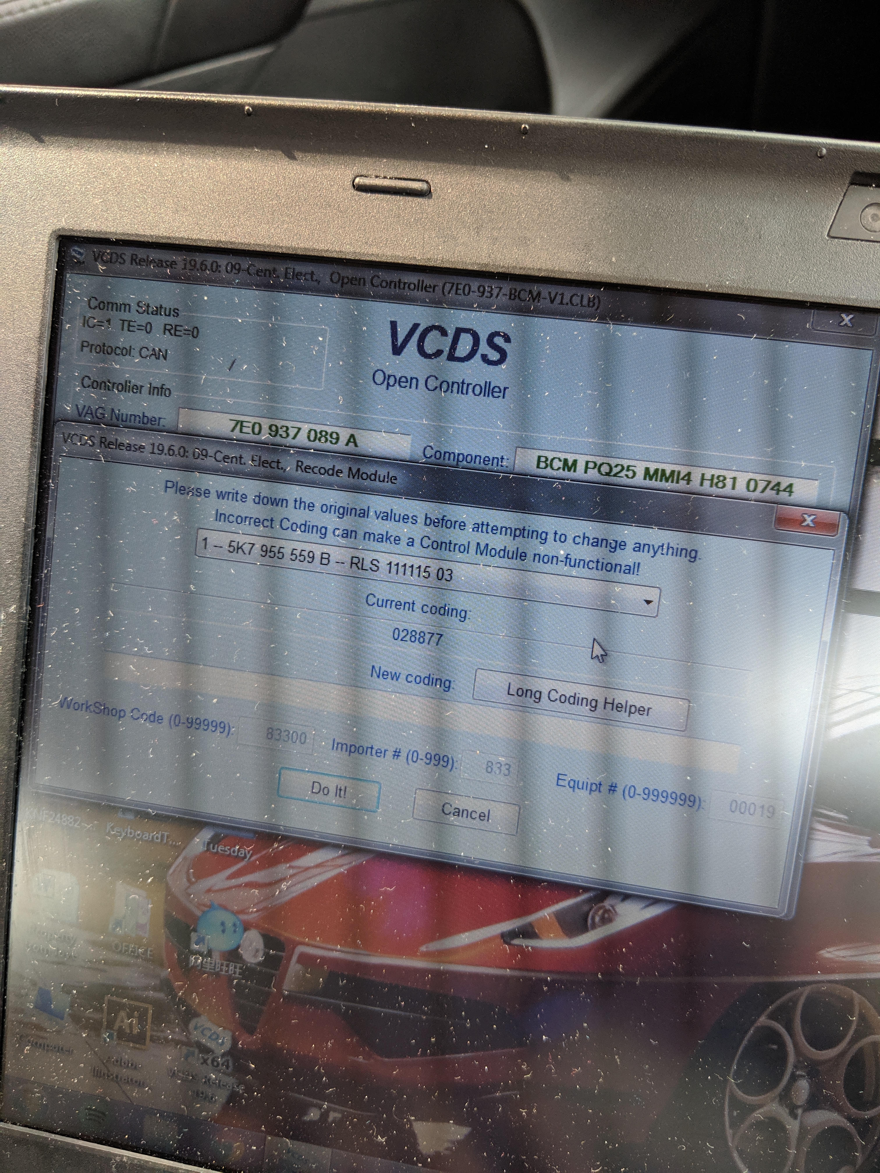

I've tried the coding 0728DD on the 5k7955559B rls, it says code accepted, but when I close and reopen, it remains the same coding as before. Is there any problem with my rls?
Also, when I put it on auto mode, the headlight will switch on, but the instrument cluster, and some other lights wouldn't switch on as the previous thread.

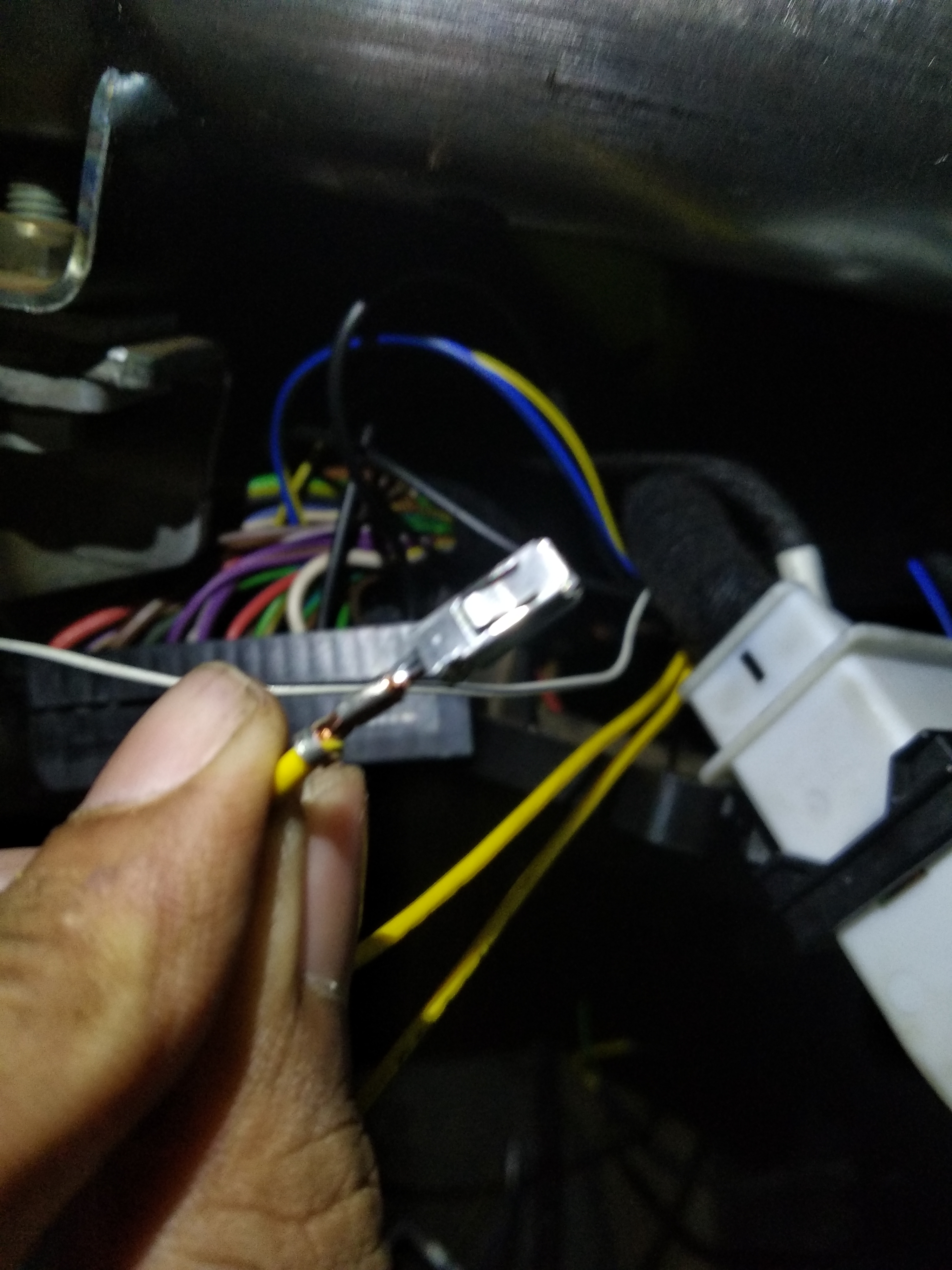

Hey ciclo how are you?
Due to floods in our city installation is delayed
Today we finished with all wiring, car assembly is in progress

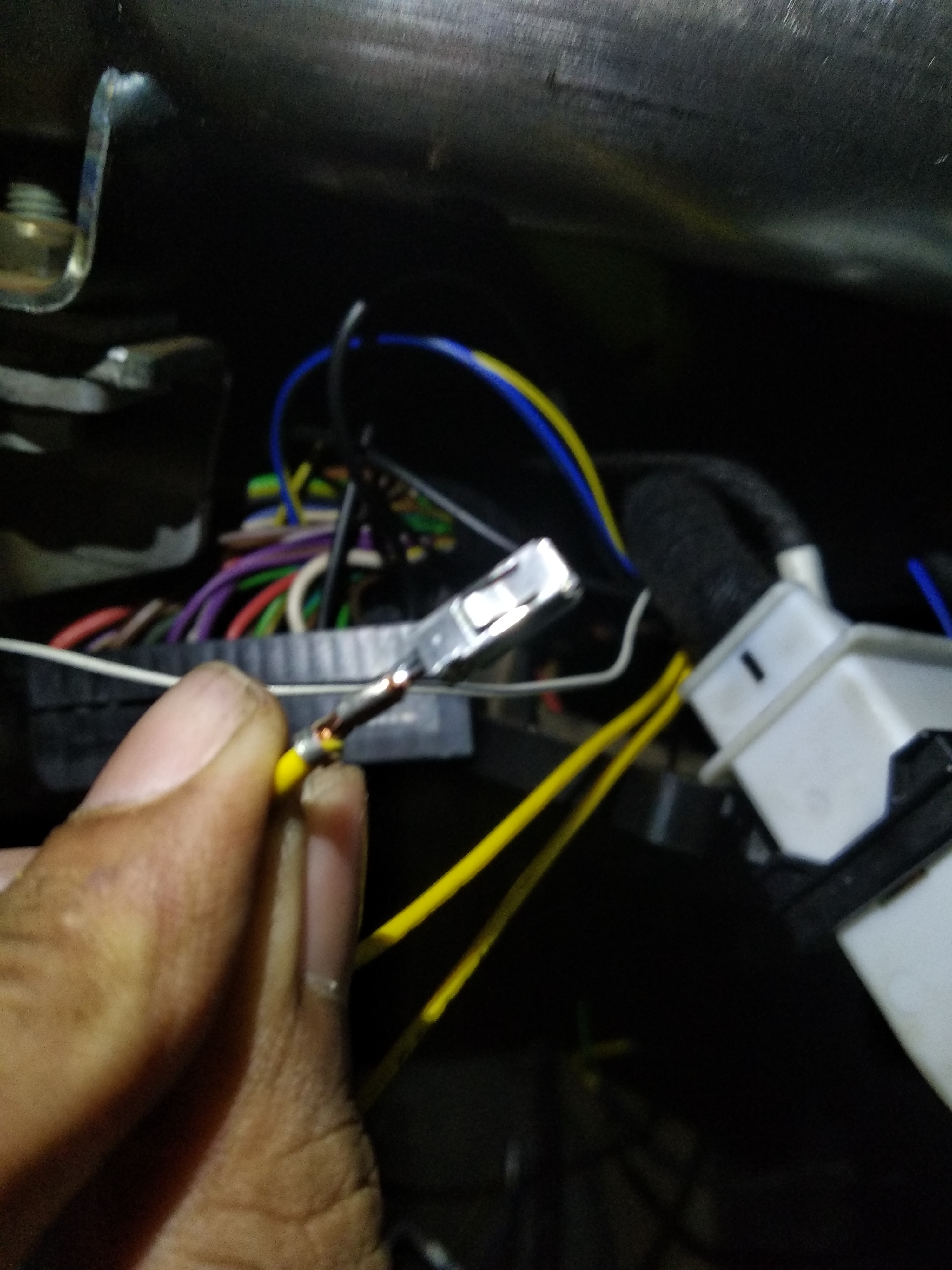

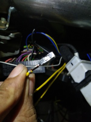

Few terminals of bcm are not getting locked in T73 Connector , I am attaching pic of the the terminal.
This terminal is not getting locked in T73
I am about to receive LED Light BCM, can I use regular BCM Max till I receive the led BCM?
If so what coding I should use to work led lights with BCM Max
Posts: 8913
Some reason is there for the terminals not to be blocked. No matter, with a cutter, slightly open the terminal locking tabs so that they perform their blocking function in the connector slot.

Hello Shardul, everything is correct regarding the electrical installations and coding mentioned.
Except:
- The CCS is activated in the BCM, but not in the ECU. :?:
- Please, can you explain to me why you have Byte0 Bit4 enabled in the Gateway?
I ask you my sincere apologies for the time it took to answer your request by email, I am trying to respond to all those emails that have a technical character.
