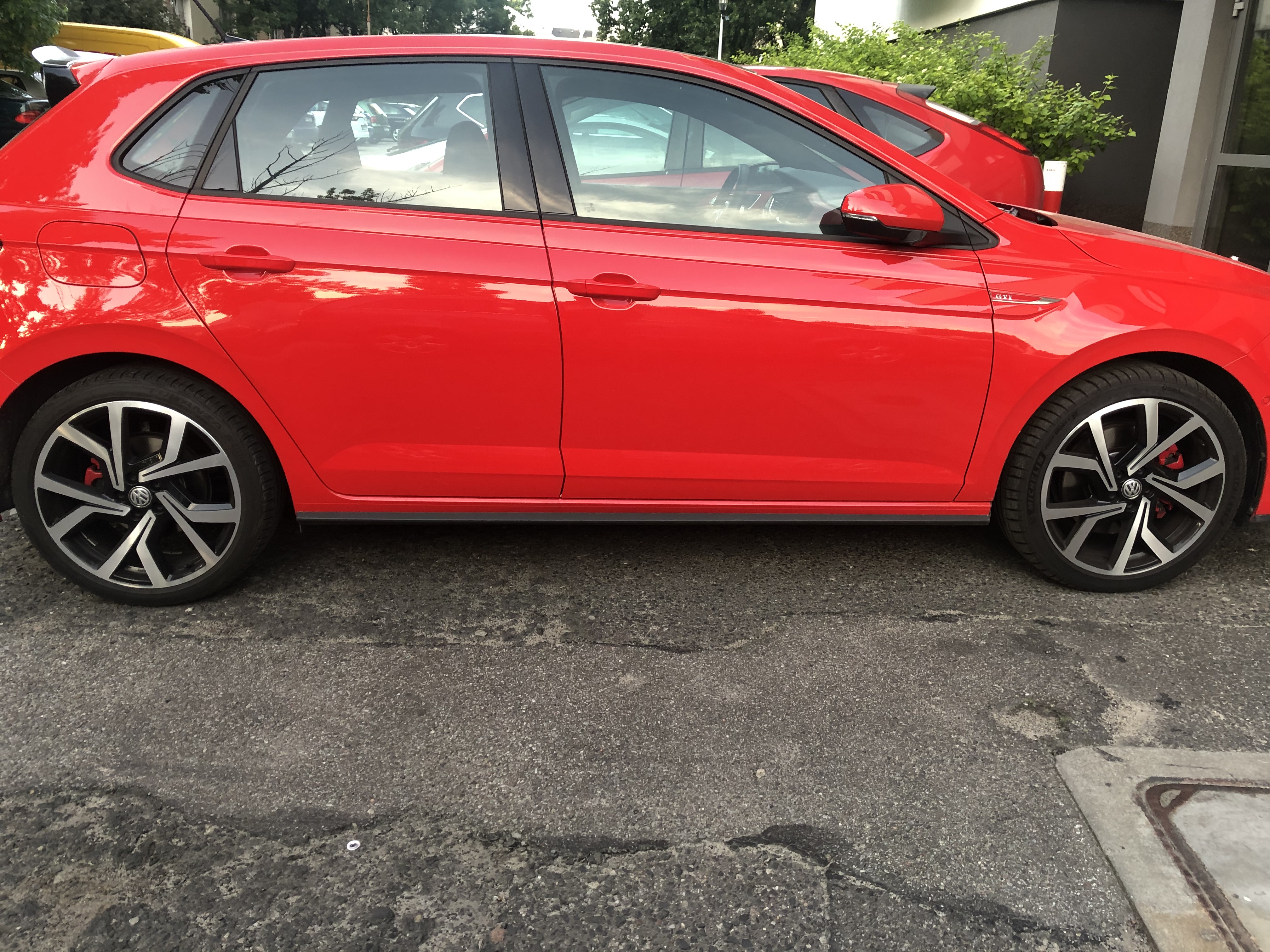

green justin wrote: Mon May 11, 2020 9:26 pm
fazzy wrote: Mon May 11, 2020 8:02 pm Just got mine.... :)
Hoping for some improvement :)
Can you post more pictures a meter away?
Missed your post earlier on...
But here it is.
An unusual picture :)
Front 225/40/18 Michelins PS4, rear 215/40/18 Bridgestone T001
