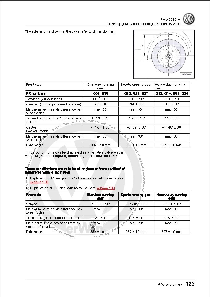

Its way out according to specs it should be -0.5 + - 0.5 so it should read anywhere between 0 and -1 getting some new tyres in a few months so I'll get it done properly I had the clutch done under warranty over 12 months ago do you think they could have moved the sub frame? It does look like the sub needs to go one way as one is side + and one --
