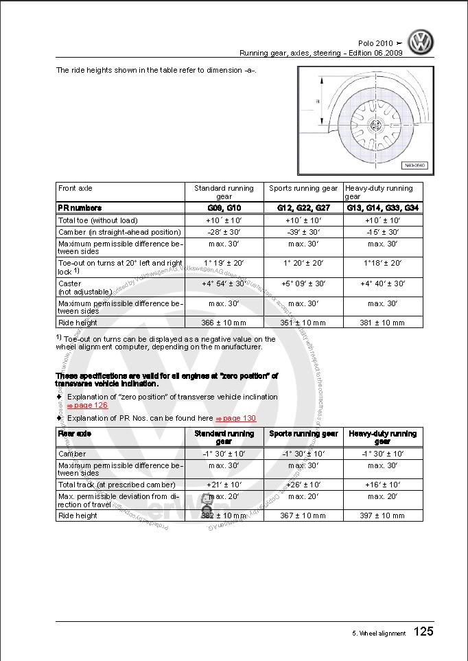

Its way out according to specs it should be -0.5 + - 0.5 so it should read anywhere between 0 and -1 getting some new tyres in a few months so I'll get it done properly I had the clutch done under warranty over 12 months ago do you think they could have moved the sub frame? It does look like the sub needs to go one way as one is side + and one --

I would have thought that only the LHS suspension leg needs to be released/removed to get the gearbox out, but if the workshop replacing the clutch chose a more radical approach to getting access to the gearbox, then that might explain why it now looks like the lower crossmember has been fitted back "over to one side slightly" and that your car now needs a full 4 wheel re-alignment check and adjust.
