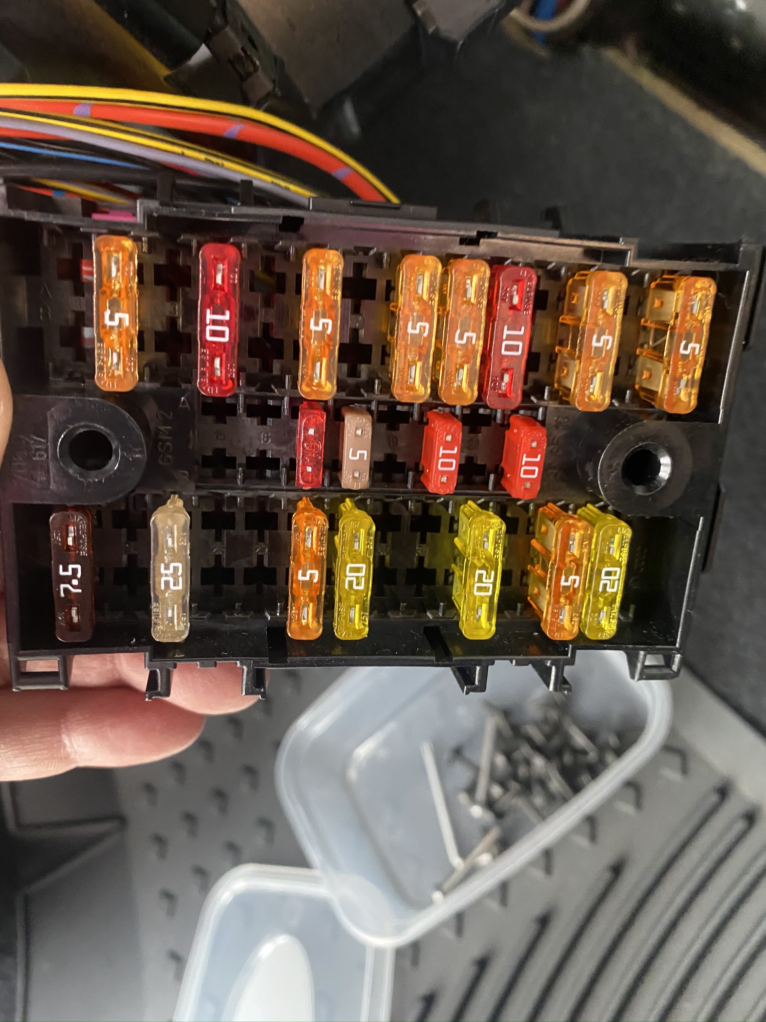

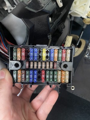

Fuse box A in ebox
New feed for +30 6mm wire fused 30amp Ran up original loom and fed through this grommet Fuse box SB Fuse box SC Kufatec loom for ALWR that will be modified to pick up left headlight at T10/T14 and shortened in places. (i think it is specific to left hand drive). ALWR unit (wrong one I think) Also have a kufatec loom for rain & light sensors but I think it is wrong but can be made to work.

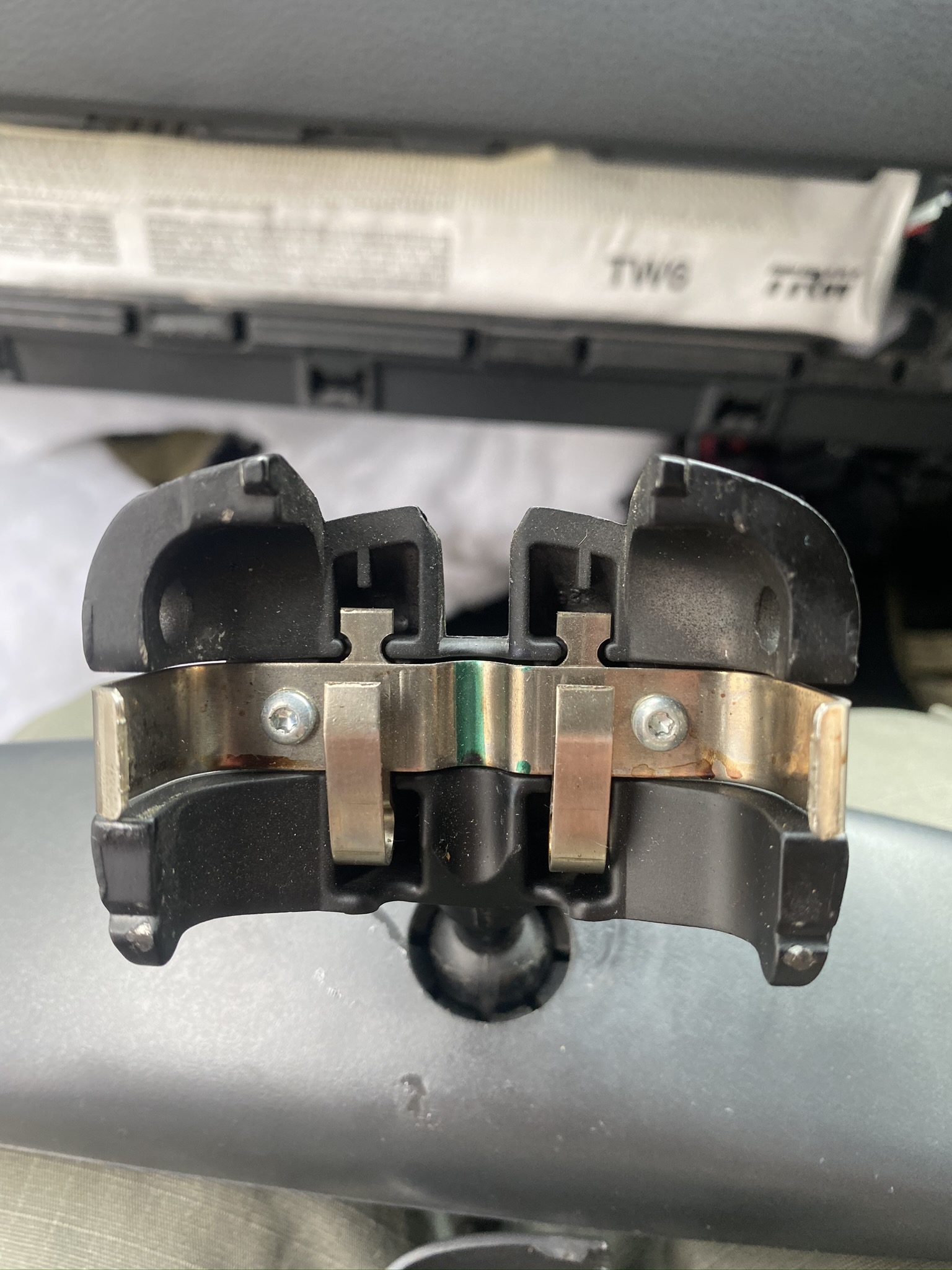

Also discovered I might have bought the wrong rear view mirror or I am missing another bracket from the windscreen. (Van has no back window in tailgate). I removed the cap from the existing mirror bracket on the windscreen but it seems something is amiss.

Because you want to update the auto dimming mirror, I imagine you want to install the auto lights in addition to the bixenon headlights.
My recommendation is that you follow the scheme for H4 for the manufacture of the wiring:
viewtopic.php?f=56&t=70736&start=45#p528663
Automatic lights means having the rain light sensor installed, which is installed in conjunction with the automatic dimming mirror.
There are two ways to install the new auto dimming mirror (+RLS):
- Or you can change the windshield with the appropriate retaining plate for the new mirror.
- Or you install the retaining plate on your current windshield.

Ok So got a little bit more done today,
Ran a new 6mm cable to rear of bcm area for extra +30 supply if needed.
Removed Battery Regulator from Installation list.
New terminal removal tools arrived and so far so good on the fuse box. It is fiddly but once you get the knack, its not so frustrating. Biggest problem was the pink locking device. Even though it has clicked out of the lock position it still needs levered a bit further while removing the terminal.
Thats me until next week as it is my sons birthday weekend.
Next job will be sort the new power input to the BCM and run all the cables through the bulkhead.
Thanks again Ciclo
