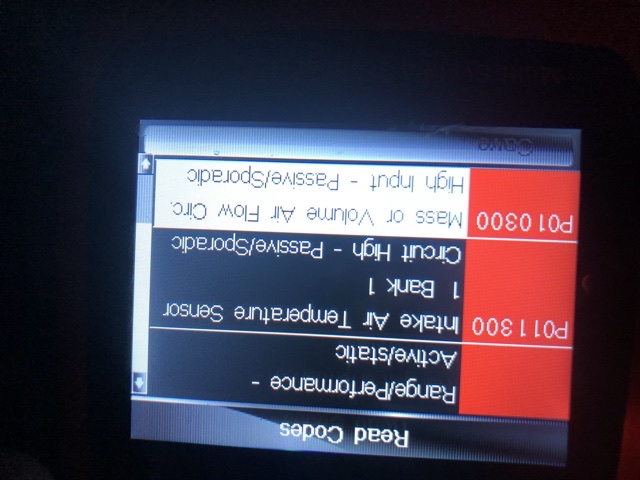

These are the codes I got my friend to check on his scanner

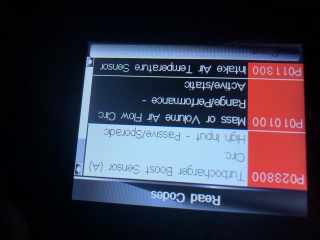

Re: P0101 code - MAF
Intake temp sensor is built into MAP senzor
- You have a fault for turbo actuator also, this makes csr sluggish loose power

These codes may have been previous ones stored on the ecu where I’ve unplugged and replugged stuff in over the past weeks as he cleared everything and went further into the ecu and other parts my first drive home without any lights.. Not sure if I’m over thinking things but it almost felt different to drive too, The idle after my 40min journey home also sounded so much smoother felt like it did a regen too, Fingers crossed I could do with some luck..
Hahahahaahahah OFC it will feel better with a clean MAF and MAP sensor, also you the can can feel rough under rengen if the egr system is clogged.
