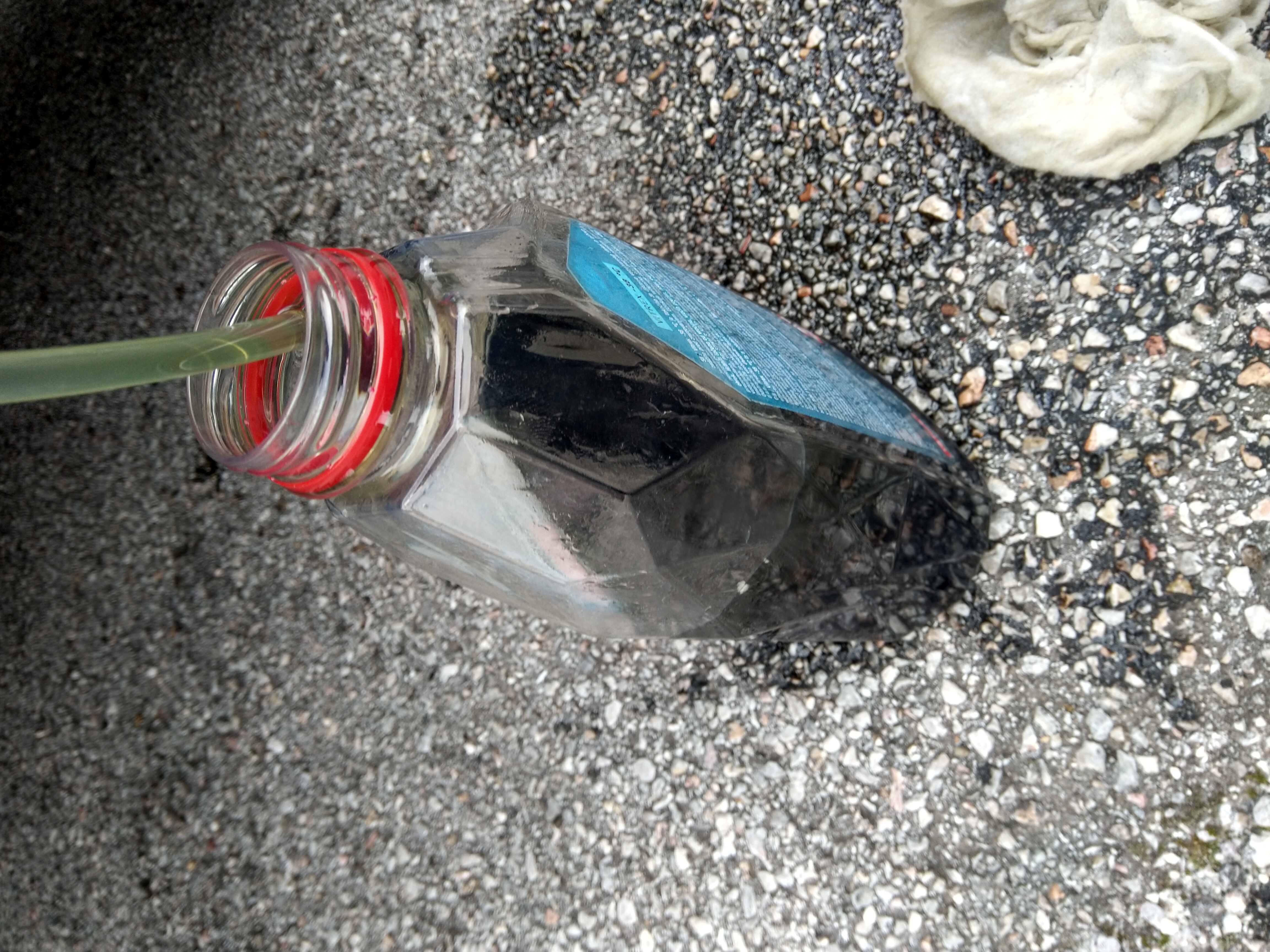

Well when it was -9 i sticked my finger in, and it wasn't frozen. Being it the cheapest option and fluid flush is a plus, can I just suction out the fluid from the bottle and turn the steering wheel to get the most of the fluid out?
Will 1l of fluid be enough?

If it's anything like the system on the 9n or 9n3 2-3L was more than enough.
Suck the old out, fill, lock to lock 10~ times, repeat until clear.
Re: Power steering pump battery
I have bled the system. Old oil was black. I have managed to suck out about 500-600 ml. Numerous lock to lock to get the most out. You need 1l of power steering oil.
I bought 2l, and did one "bleed of system/ flush" with car on jack stands.
Initial impression much lighter steering wheel like its coded for light car, and not for GTI ( in have it coded for GTI i like heavier steering).
We will see tomorrow if it does the trick, and I think it will. Feels much better.
Oil was pretty cheap 6eur for 1l, i recommend flush to anyone.

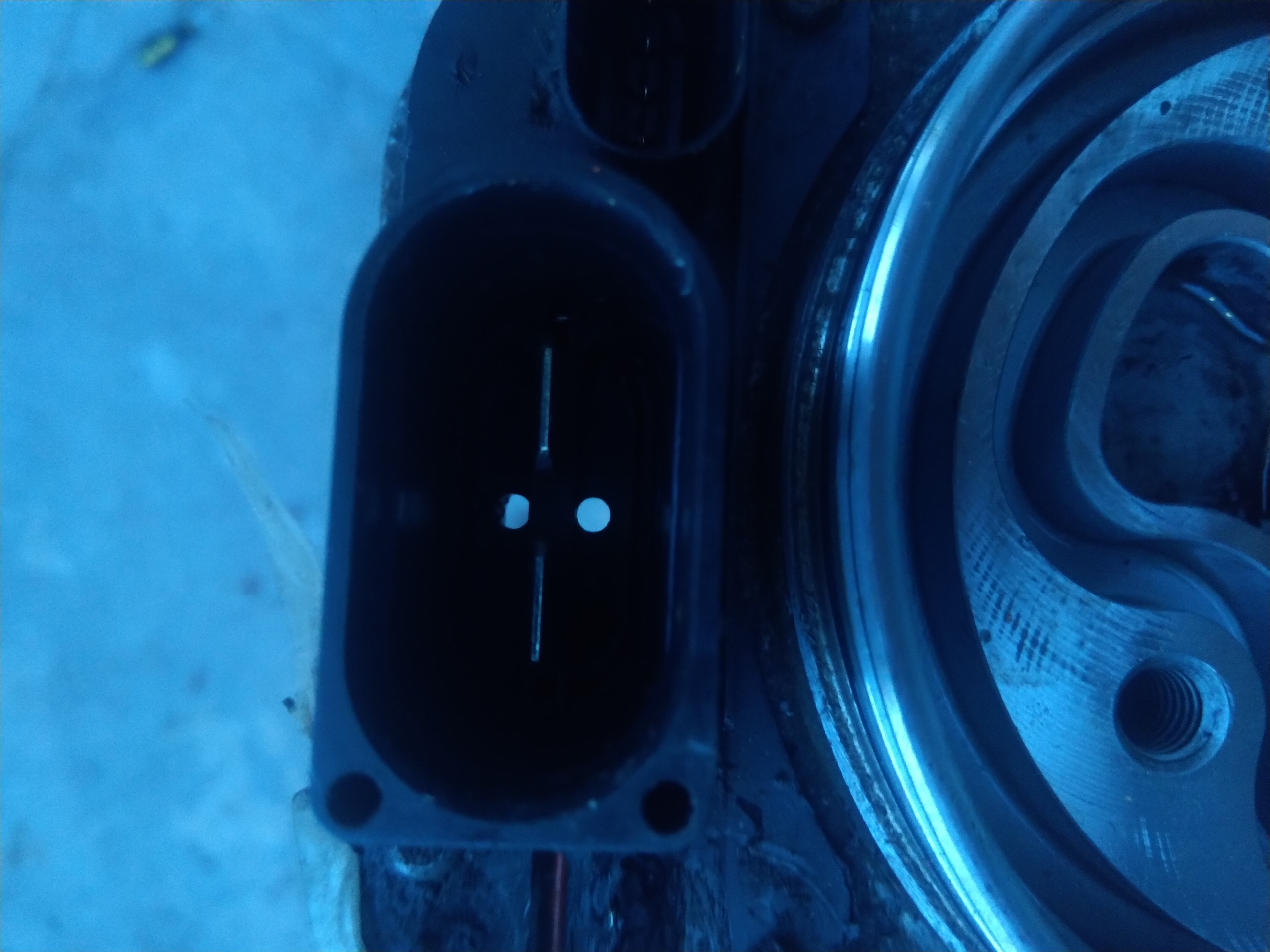

Mine pumped died, and i have replaced it.
For fun, I striped down my old pump. And guess what, these pumps are sabotaged from the start.
Why?
The large connector ( 12V and ground) has two holes! That lead directly into the el. Compartment. Meaning your transistor, capacitors will die. El.+ Water= party.
So people check your connector and do what ever you can to protect the connectors from water ingress! Water wont seep from side, its so hard glued/ sealed.
Why your oil becomes black, because metal parts are getting worn, and black particles stick to the metal parts of the pump, oil changes wont help it without pressure mechanical cleaning. Meaning this is in rack also etc.
Basically at the bottom i had a puddle of water.
