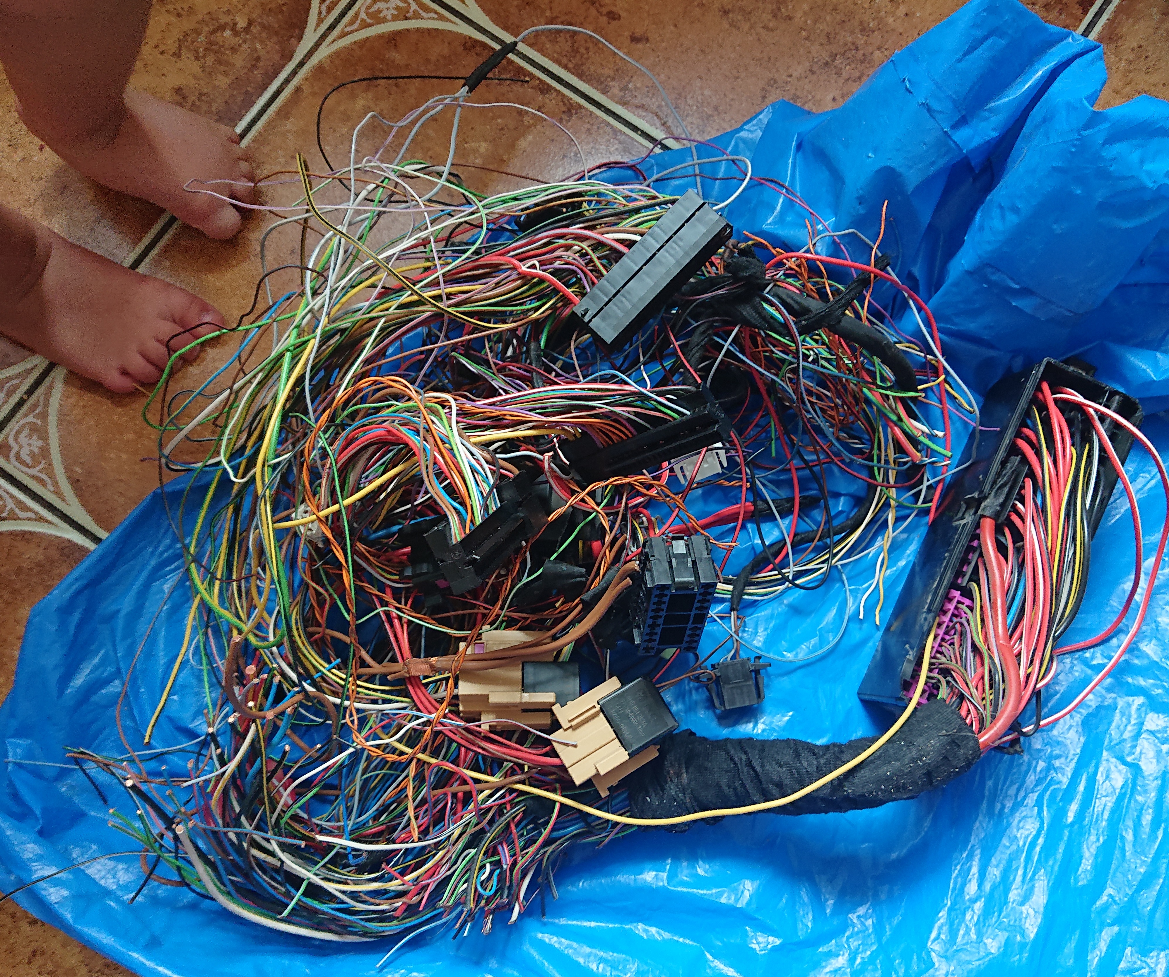

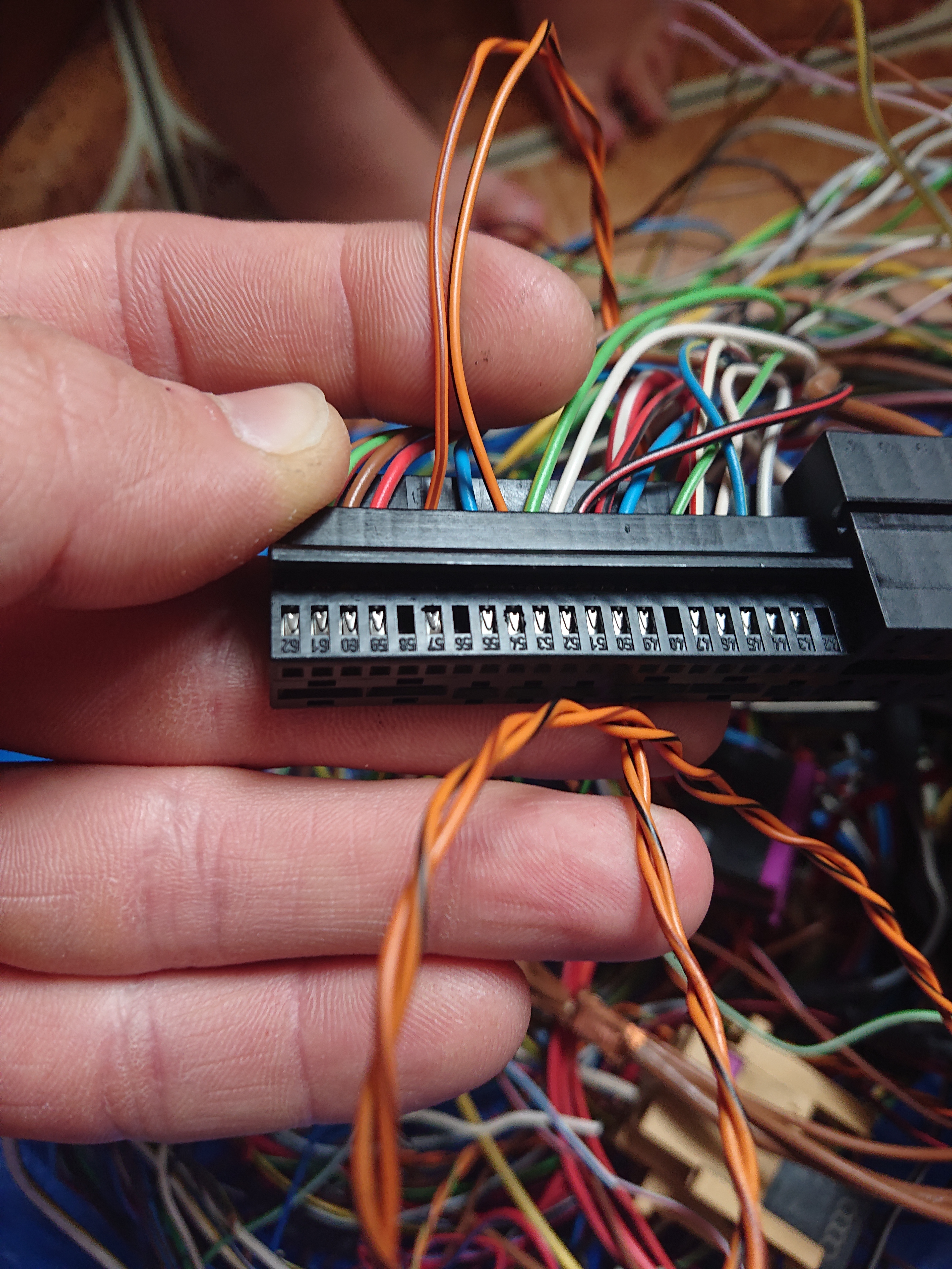

Ok Cyclo, in my free time I will try to understand it and we will come back to the topic on Monday 23.08, I do not know if my car has cables T73b / 57 to T32 / 29 and T73b54 to T32 / 28 because I do not have time to check it now, but looking at the wiring ibizy 6j5 2013, this is where the cables are connected
- DSC_0821.JPG (4.95 MiB) Viewed 7160 times
- DSC_0820.JPG (6.49 MiB) Viewed 7160 times
- Posts: 6695
Your car does not have these cables, only cars with BCM 090 will have them.
- Posts: 8988
+1iichel wrote: Wed Aug 18, 2021 1:23 pm Your car does not have these cables, only cars with BCM 090 will have them.
Those wiring looms will be perfect for our purposeKamilPL wrote: Wed Aug 18, 2021 1:01 pm ... looking at the wiring ibizy 6j5 2013, this is where the cables are connected![]()

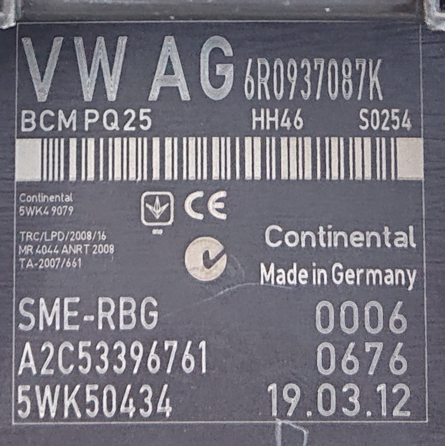

Hi cyclo, my cables are twisted, but there is no time for assembly, maybe I will find a moment today to cover it, on August 26 I will be posting info on whether the windows are working on 7h0937090 to go further with the work on ibiza
production of my ibiza 04.2012 BCM 6R0937087K Z11, 7H0937090 comes from Ibiza 6j5 03.2013

Cables T32 / 29 - -> T73B / 57, T32 / 28 ---> T73b / 54 when released, the car does not start the windows do not work
KamilPL
- Posts: 125
- Joined: Tue Aug 03, 2021 4:26 pm
- Drives: Seat Ibiza 6j1
- Location: Poland
Original cables T32 / 28, T32 / 29 removed and individually insulated, something wrong is my ibiza resistant to modification?
