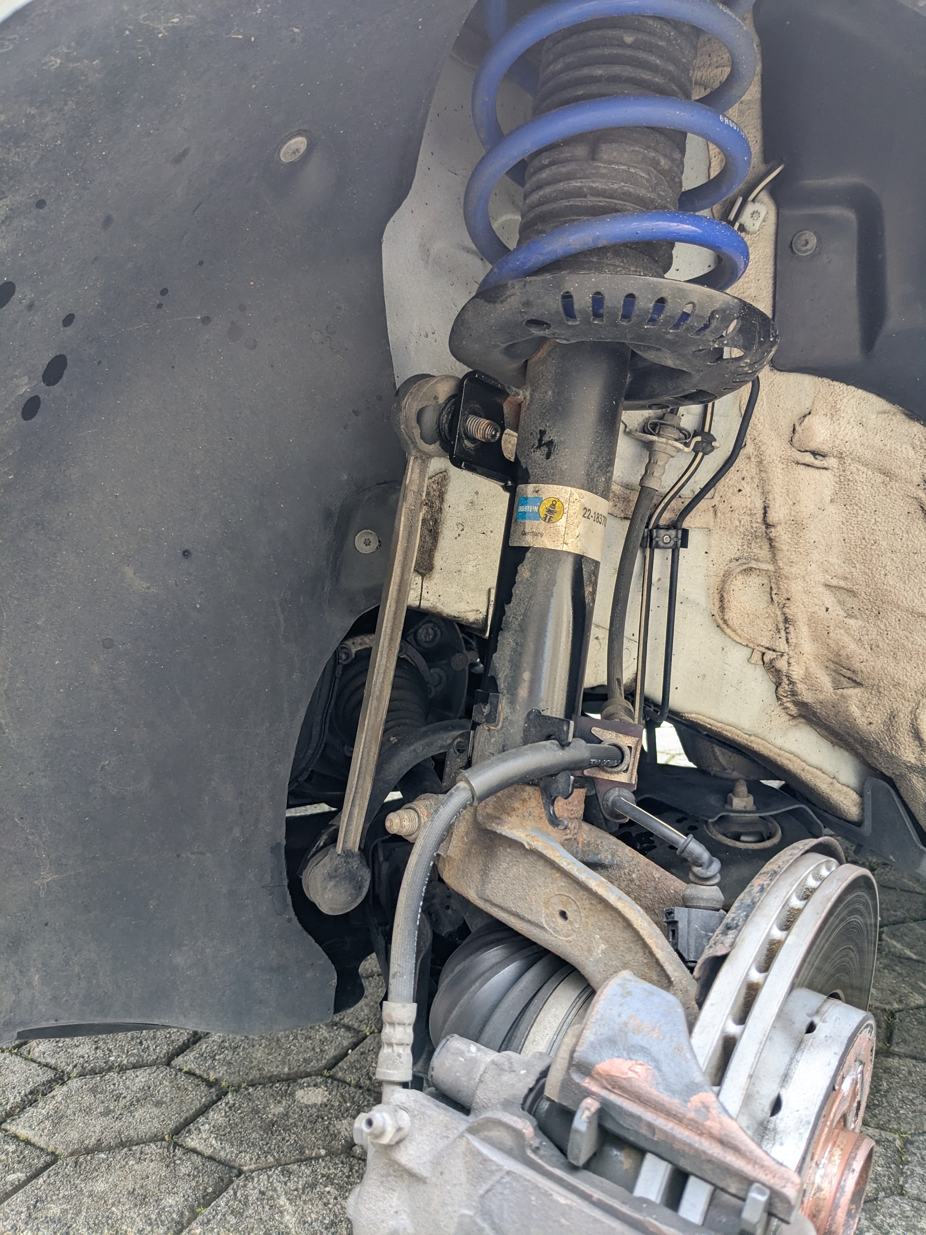

Hey fox,
It's been now over a year and 35000 km and more I'v lowered my daily polo.
The current setup is:
-Bilstein B4: standard, like OEM, stiffer and way more durable
-VW lowering sping: -30mm
Confort is good on highway and on good road with a smooth surface. However on rough roads, it's a bit more of a slap in the face.
But it's still okey to be honest.
My question is: if I change fore Bilstein B6, will I gain a little bit more confort since they are designed for lowering spring ?
Because, because I'm running B4 and so standard shock absorber, it means they are all the time compressed in low stop.
Photo of my setup during antiroll link replacement:

Did you fit shorter bump stops to go with the lowered springs?
If not you may not have very much travel before hitting the stops which will make the ride firmer than it should be.
I fitted GTI bumps stops alround on my son's car and it still wasn't great.
I now have Ibiza Cupra bumps stops on the rear, but can't find anything OEM that is shorter than the GTI ones for the front, so may just have to cut them down a bit.

The bump stops fit on the shaft of the damper on the front and rear of the car. The very short rear ones which I fitted were 6Q0 512 131 D, but there doesn't seem to be a similarly short front one.
If you've re-fitted standard length bump stops, the car will probably be sitting on them all the time which will make the ride harsher than it should be.
