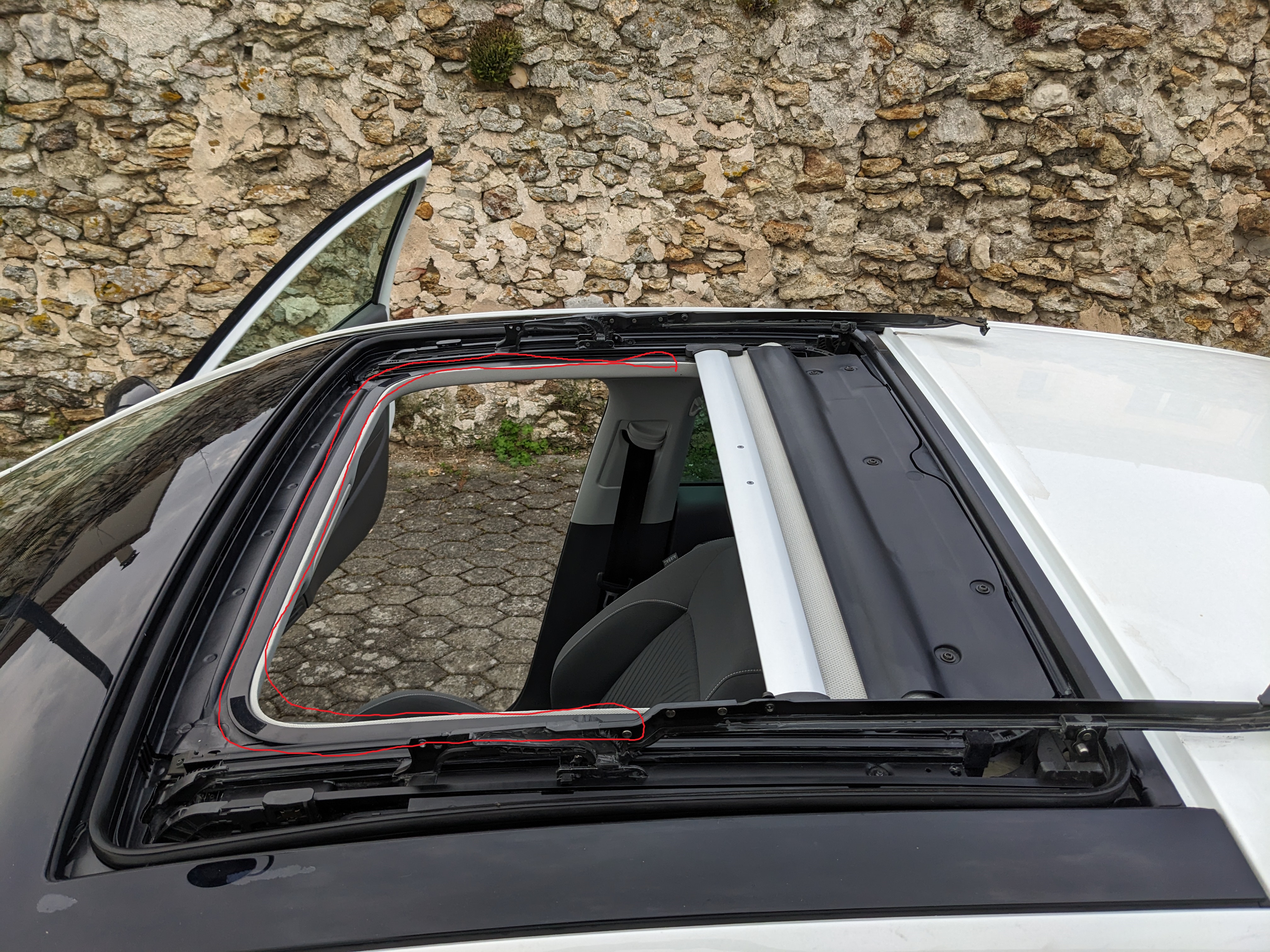

My only concern is about the trim that surround the sunroof:
This trim is between the sunroof fram and the headliner, maintained by clips.
Accordind to offical VW workshop manual, you just have to carrefully unclip it.
It try it, but it seems very hard.
Any tips ?

Leave out the careful part and just pull firmly

iichel wrote: Wed Jul 26, 2023 3:49 pm Leave out the careful part and just pull firmly
By "Leave out the careful part" you mean, no need to be gentle, just pull ?
Posts: 6694
Re: Headliner replacement
Exactly

Okey, It's because I don't want to ened up to replace expensive part as the sunroof frame for exemple.
You did remplacement of headliner by the past ?
Posts: 6694
I've done quite a lot of headliner replacements but also fitment of DAB and GPS antennas, for that the headlines must also be lowered.

Okey, I will try by pulling anf insert trim tool. It's really really tight
Posts: 6694
Yes that's true, it's very tight
