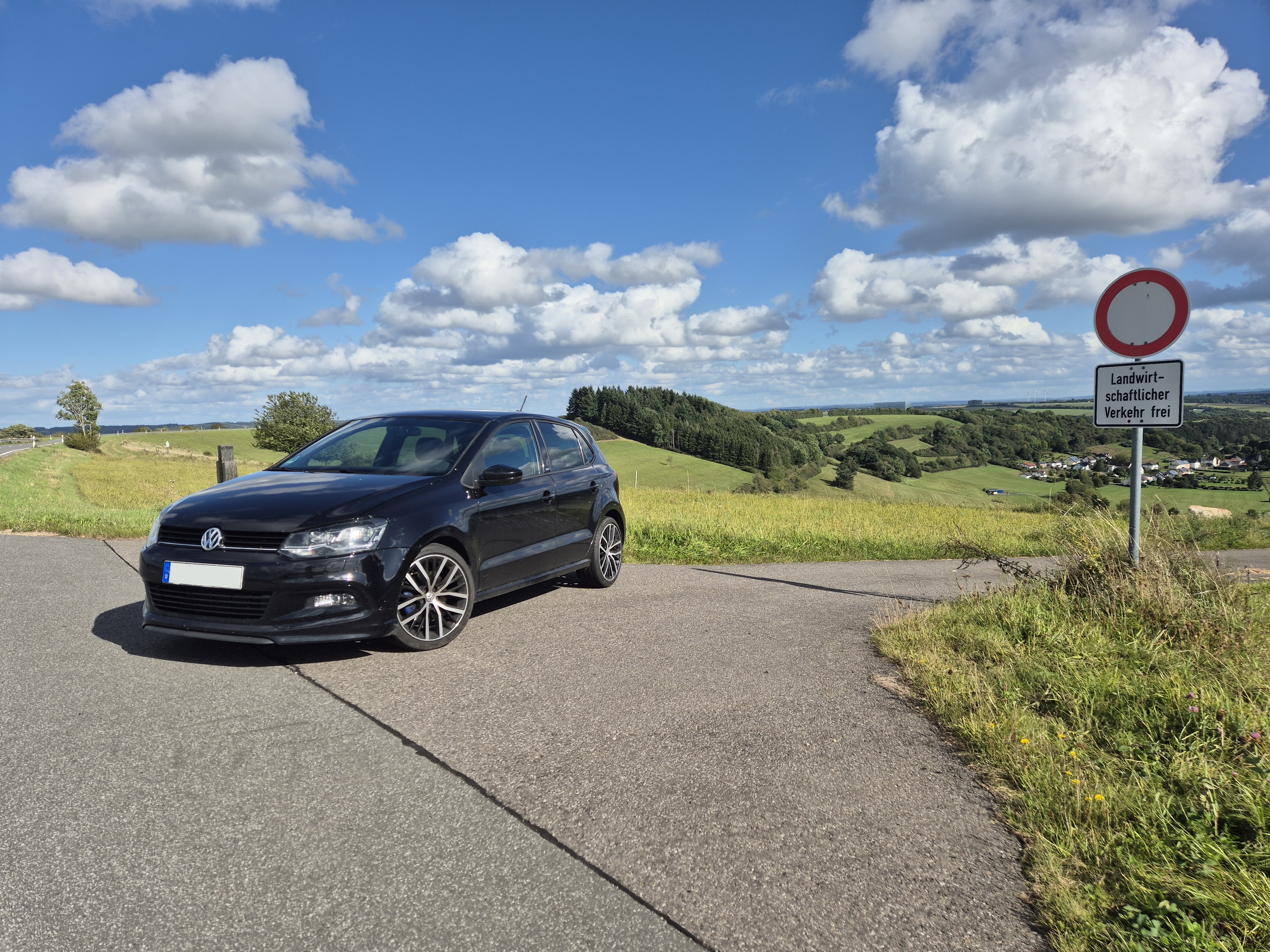

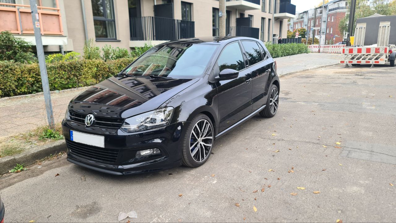

Alrighty, back again. :D
A little update about the state of my car. First of all: I finally got my bumper covers back from painting. Now I ask myself why the frick I didn't convert to R Line sooner.
And yes, I am very aware that it really needs the highline 6C grill. I have one. Somewhere. Can't find it. I apparently have too much stuff in too many places. XD
Secondly, I now had my new engine for around 5.000 km. And I LOVE it. You can drive it somewhat economical, but you don't want to. The power delivery is awesome! It has some small problems, to which I'll get separately, but overall, it has been a blast so far.
Thirdly, I finally found a reasonably priced ALWR control unit with index C. I haven't really had the time to play around with it, but as far as I can tell other than the need for a fresh set of parameters (which it will get this Thursday) it's fineish.
Also, a little outlook for the future: GT spoiler, widened sill panels and water deflectors are in the making for a completed BlueGT look. In the planning are also side assist (where I might need ciclo's help), TPMS and this exhaustion detection system thingy. Or maybe some light tuning? I don't know, but I sure will find a way to waste my money :D
So long

Hey you all! My little Blue-GT-swapped Polo recently survived a small 2500 km road trip through the southern parts of Germany. A nice opportunity to take some pretty pictures. Please ignore the absolute humongous amount of dirt on it! :D
Polo on the hill.jpg (7.99 MiB) Viewed 1281 times
Also, it was a good way to test it out some more. And of course, I found two mediocre problems:
