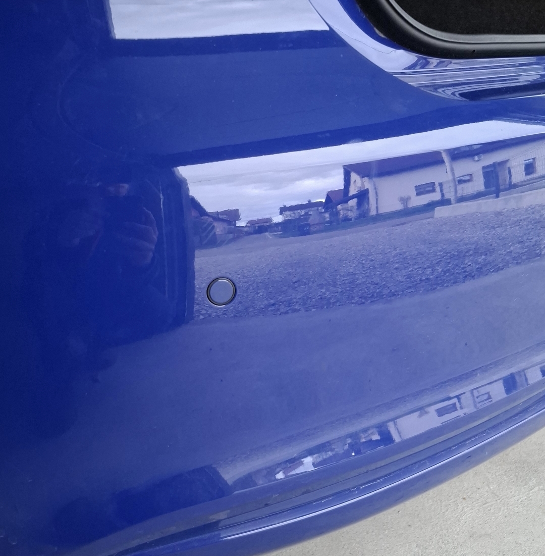

Hy..today is the day that rear bumber is finished. And the wires are setup for 4 senzors (moved around in the connector t12) with a new tool fhat arrived yesterday.
- Screenshot_20251108_124326_Chrome.jpg (160.58 KiB) Viewed 30572 times
- Screenshot_20251118_190438_Gallery.jpg (645.88 KiB) Viewed 30572 times

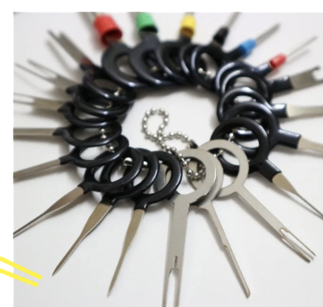

Double-check that you inserted the terminals correctly into the connector when swapping them. You need to be very precise when handling the contact terminals. Take photos of the connector where the wires were swapped and post them, or post a VCDS scan for a better understanding of what might be happening.Buci wrote: Tue Jan 06, 2026 2:22 pm Hy Ciclo..
