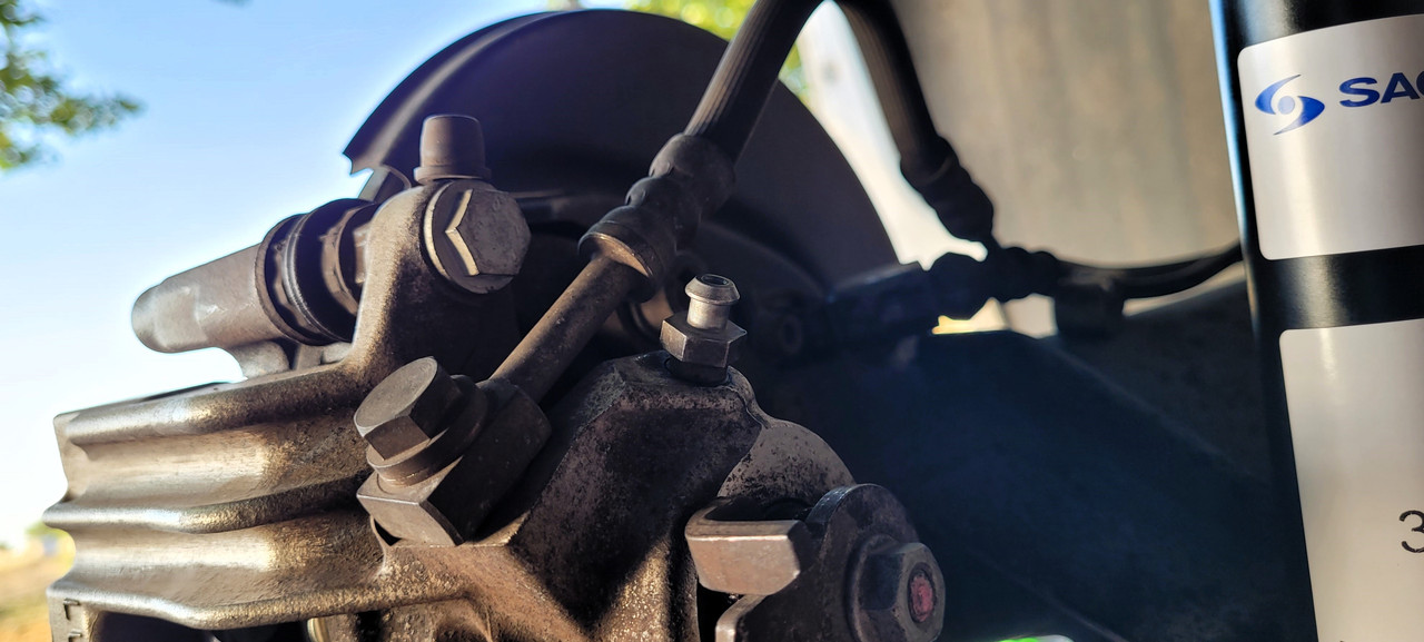

POLO 6R. 1JS rear shock absorbers and rear discs and pads installed.
- According to erWin. Torques, etc...
Highlights.
PTFE (Teflon) and Silicone Lubricants.
The factory 1JP shock absorbers showed their age. They were still functional and capable of reaching their full travel when compressed, but they were too easy to compress.
Regarding the rear brakes, nothing to add, it's an overdone, recurring topic on YouTube/internet.
The old parts went to the recycling point. During the drive, I did some gentle braking to allow the new pads and discs to bed in.
At the recycling point, I noticed that the UV coating on the Brembo discs looks very nice.

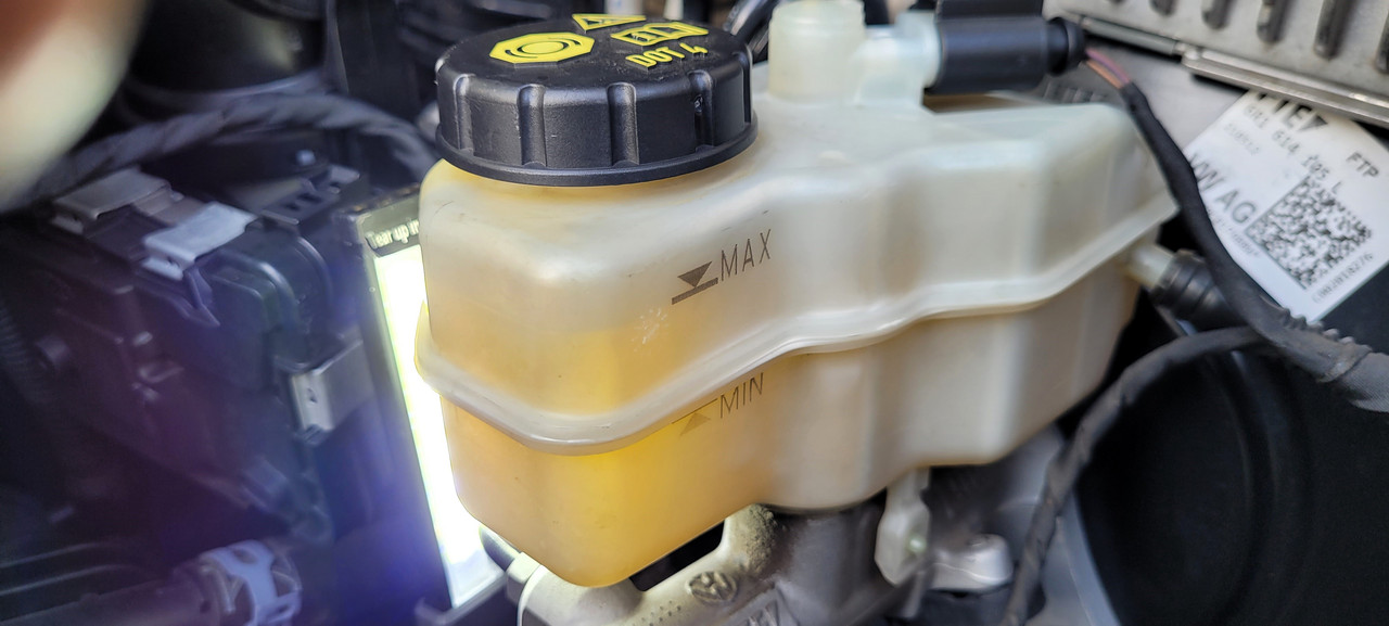

Before pressing the piston back into the cylinder with a piston resetting tool (e.g, prying with screwdriver), draw off brake fluid from the brake fluid reservoir. Otherwise, especially if the reservoir has been topped up, fluid will overflow and cause damage.
I had to remove 60 ml of brake fluid because the brake fluid was changed and set to max level at a VW dealership years ago when the brake pads were only half worn.
I'll be replacing the brake fluid in a few days...

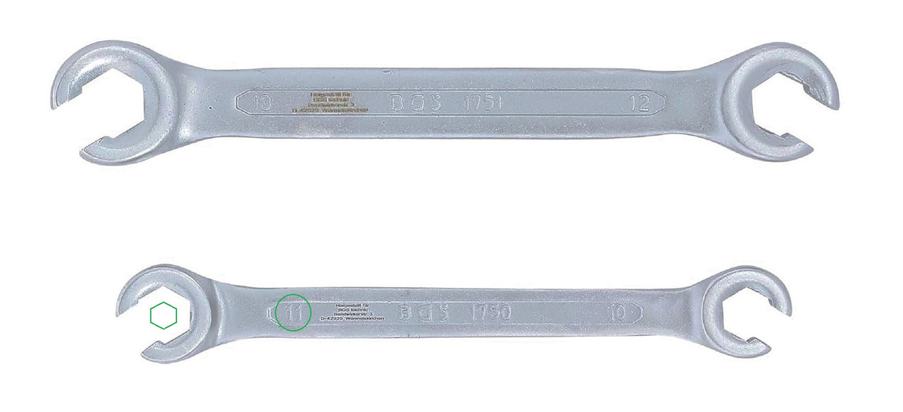

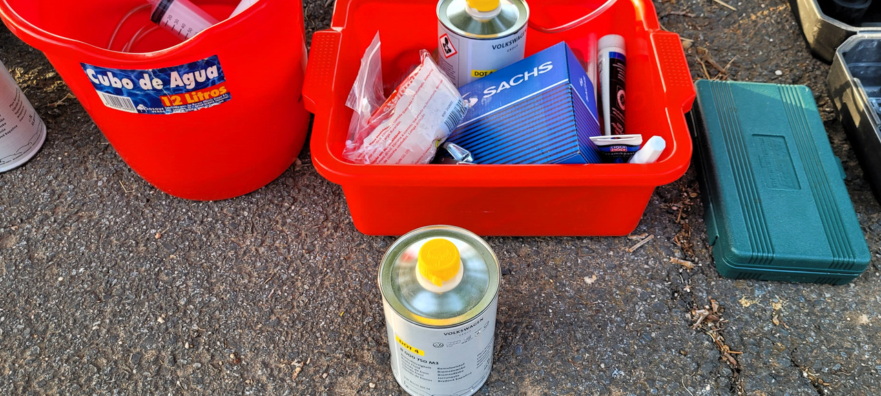

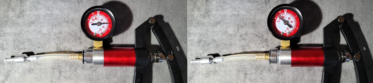

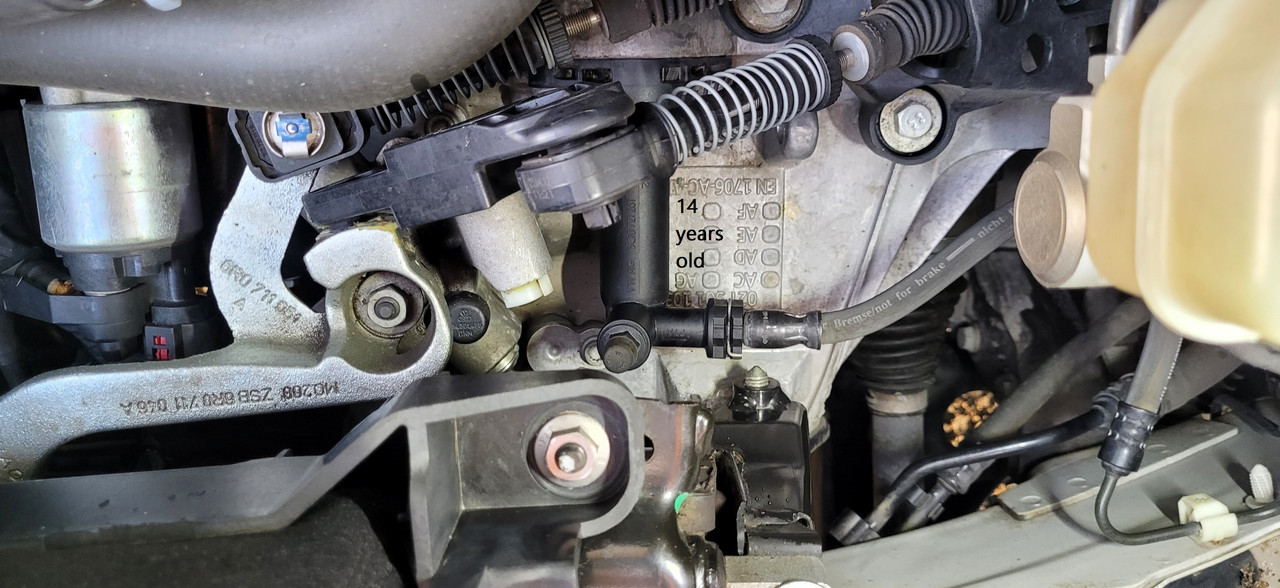

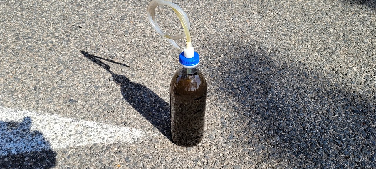

Some additional notes before replacing the hydraulic brake and clutch fluid.

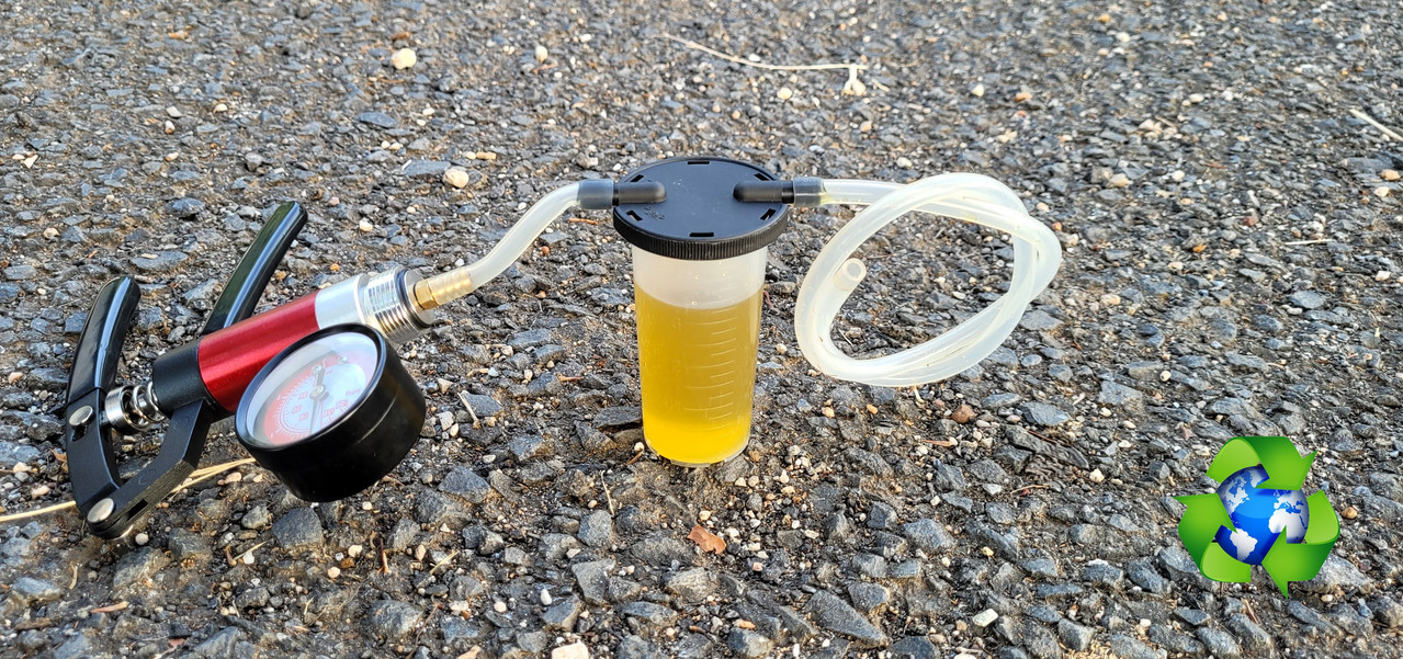

Is your bleeding system (pumps, VAS) capable of not contaminating the new DOT4 hydraulic fluid after doing a couple of bleeds?😄
approx... +/- 0.5mm
I prefer not to take the risk with a 14-year-old piece of plastic and have the vehicle become immobilized in the middle of nowhere.
Trying to avoid inaccuracies in brittle plastic nut/bolt/bleeder subjected to 14 years of constant thermal changes.🤔

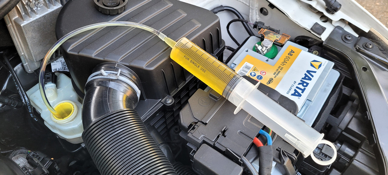

The brake fluid will be extracted/replaced by pressure/pumping using the one-way valve method, and the clutch slave cylinder fluid will be extracted/replaced using a vacuum system.
I leave you here a video that shows how to bleed the clutch in less than 10 seconds. Quick & Easy Method Explained!
:arrow: https://www.youtube.com/watch?v=DINu_uOrr5E
I would choose the optional part, cleaning is essential, as well as the final test.🤭
https://www.youtube.com/watch?v=RDsTeEiFFp4

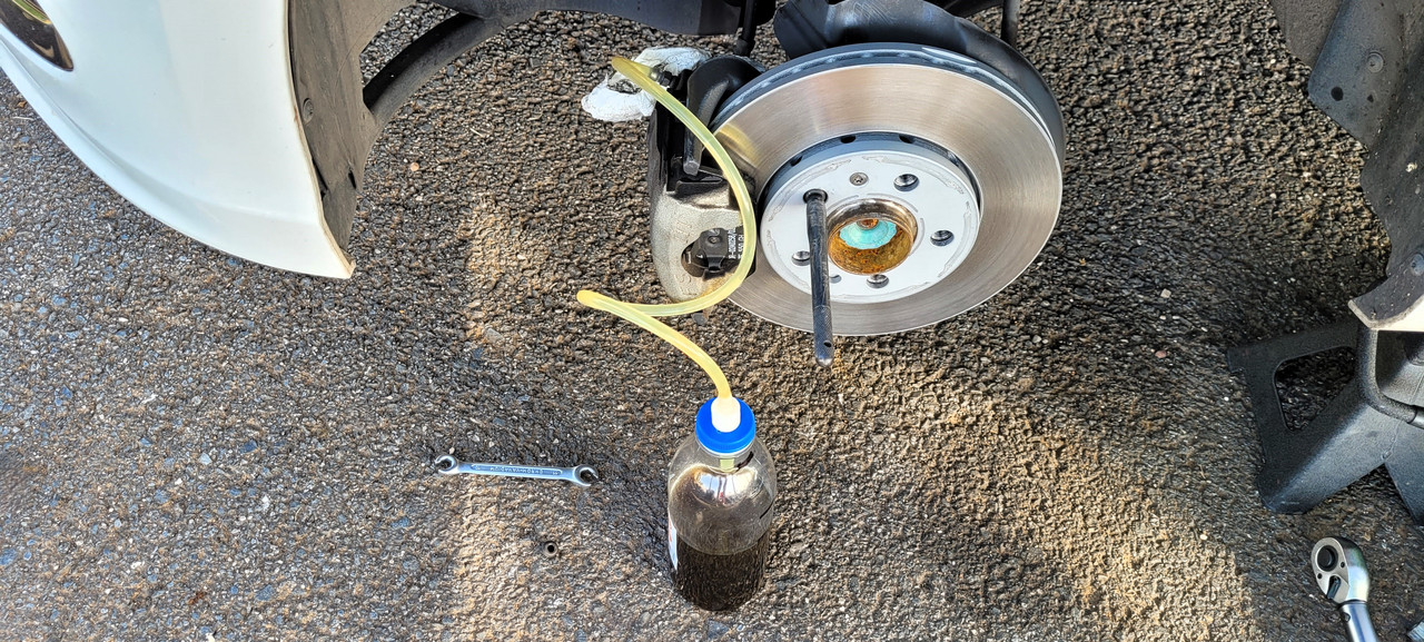

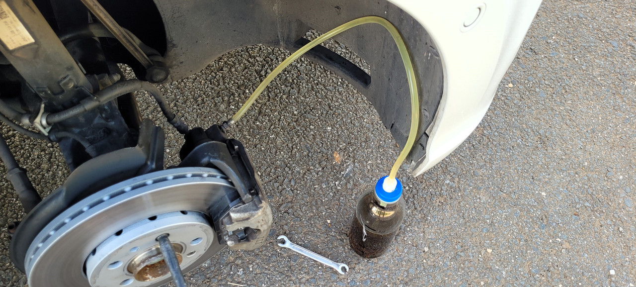

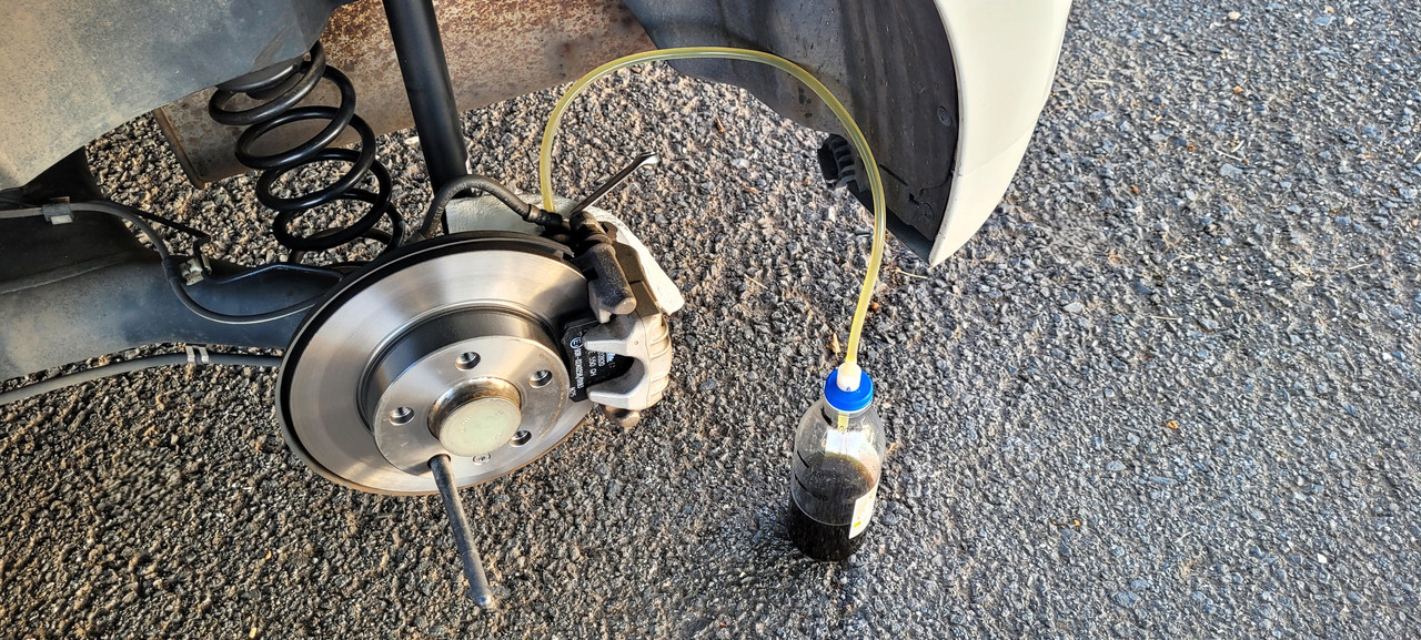

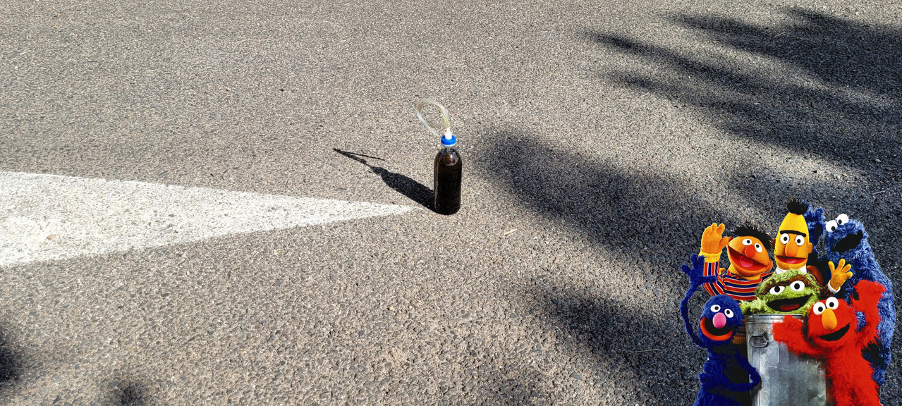

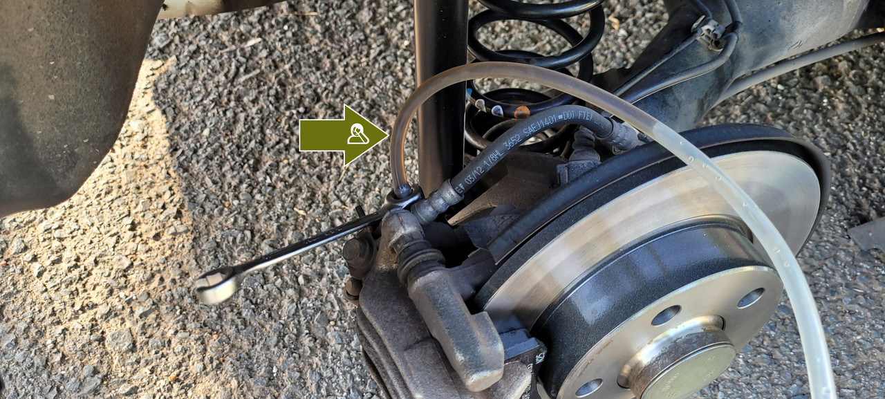

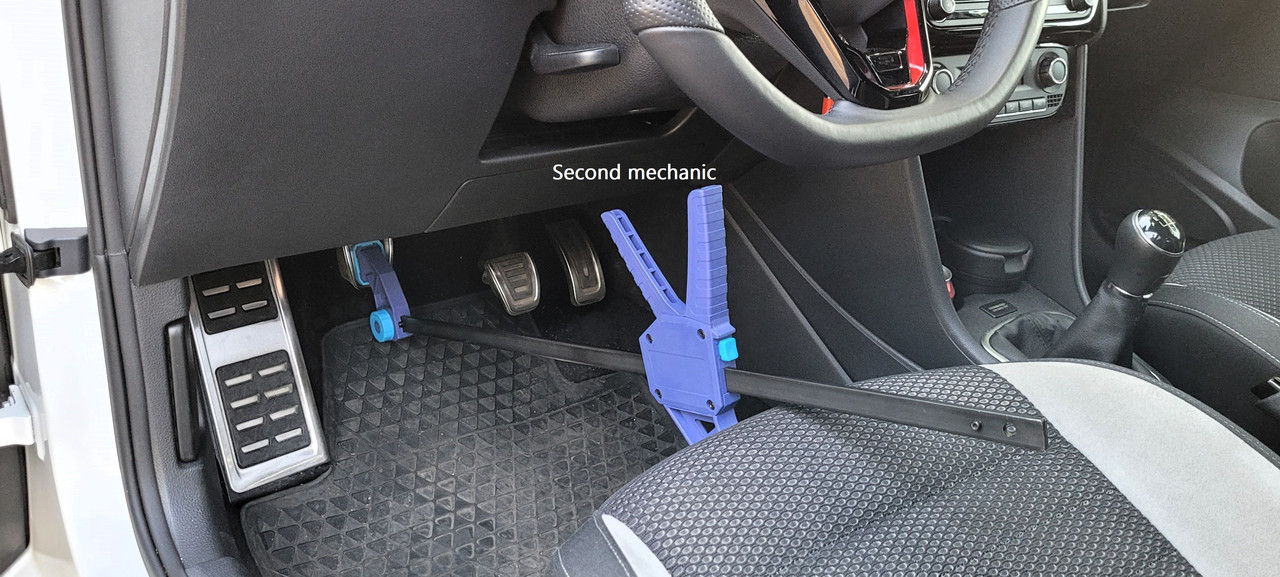

POLO 6R. Brake fluid replacement/bleed.
No comment.
RL
FL
FR
RR
Test:
It's essential to activate the ABS regulation two or three times. Do this on a track/road with loose sand/gravel to avoid unnecessarily stressing the tires and brakes.
Bleeding the brake fluid for the clutch slave cylinder will have to wait for a cooler day (below 35ºC 💦), or maybe I'll do it in the garage.
Have a good weekend everyone... without exception!

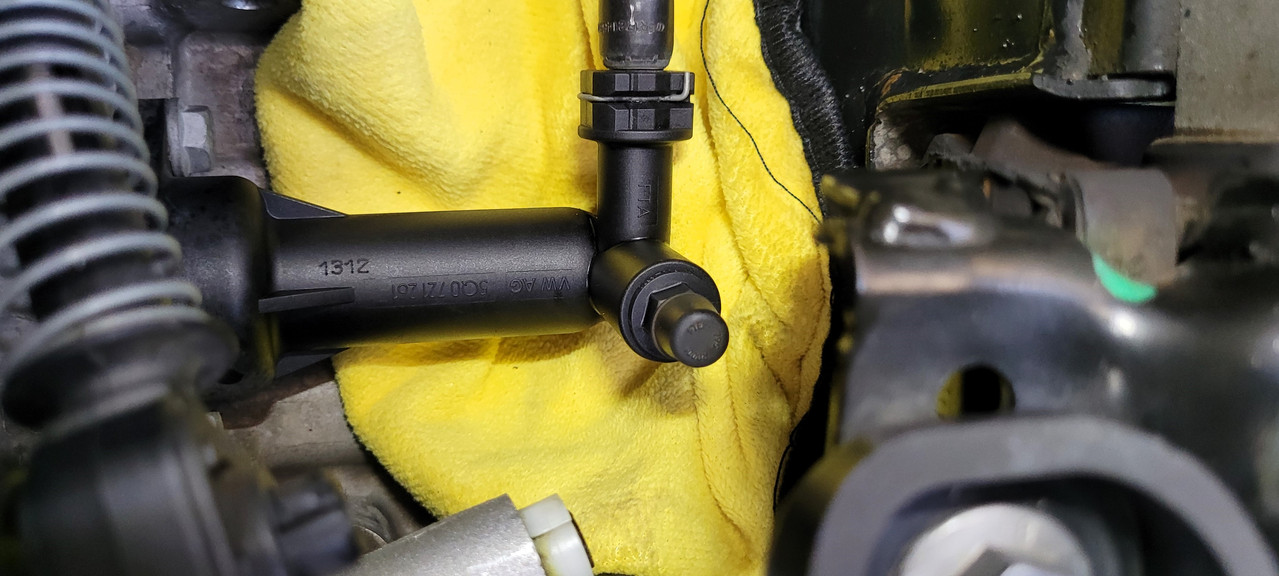

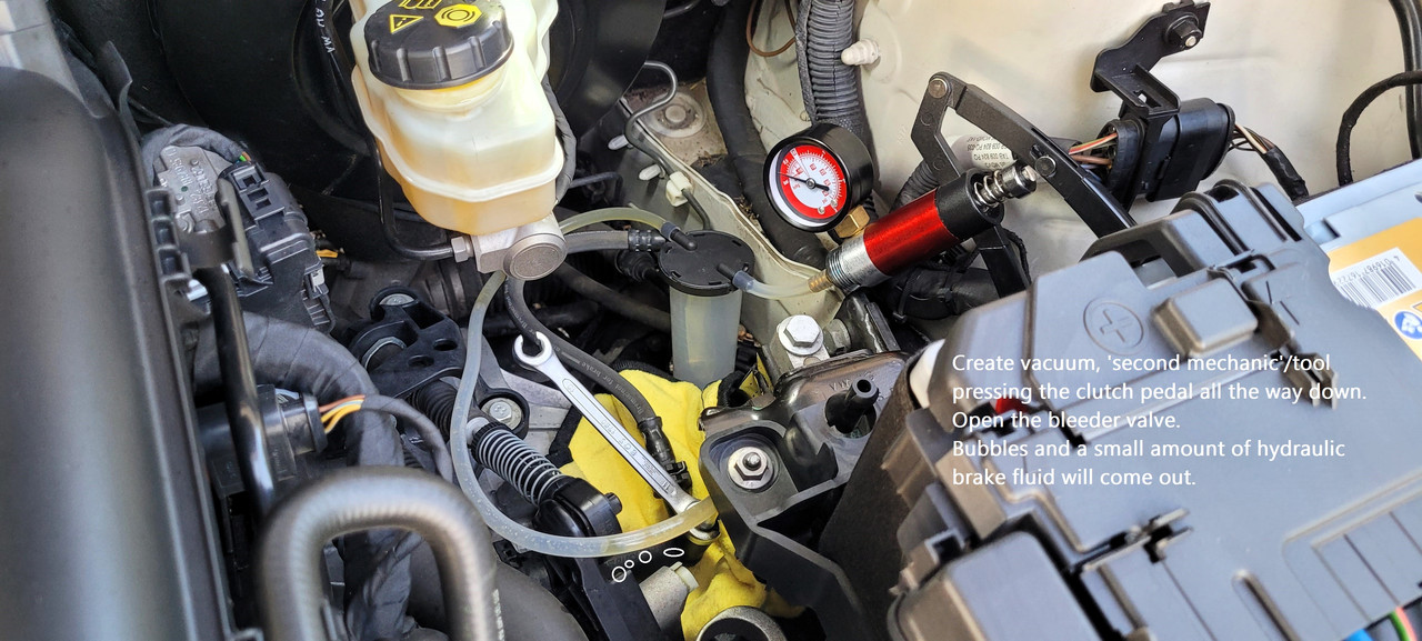

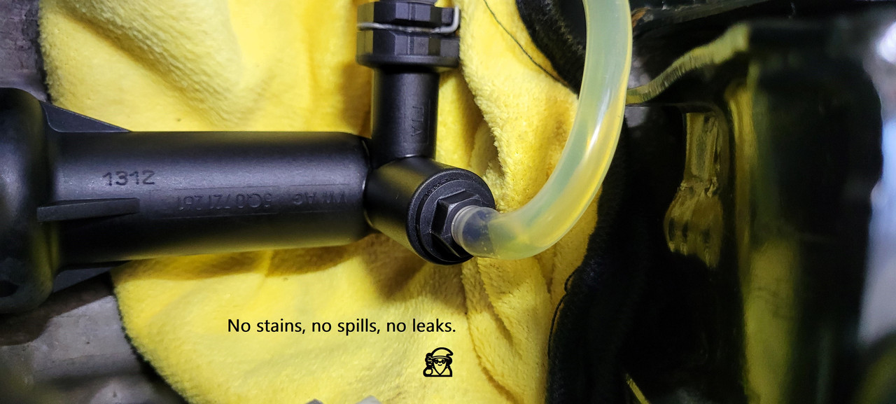

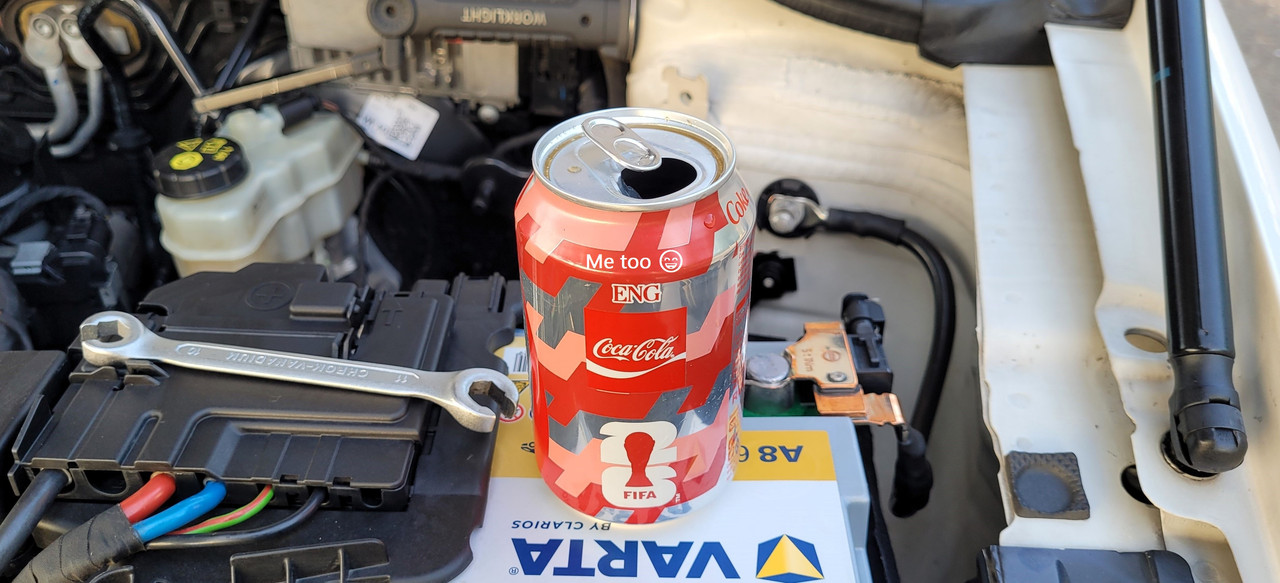

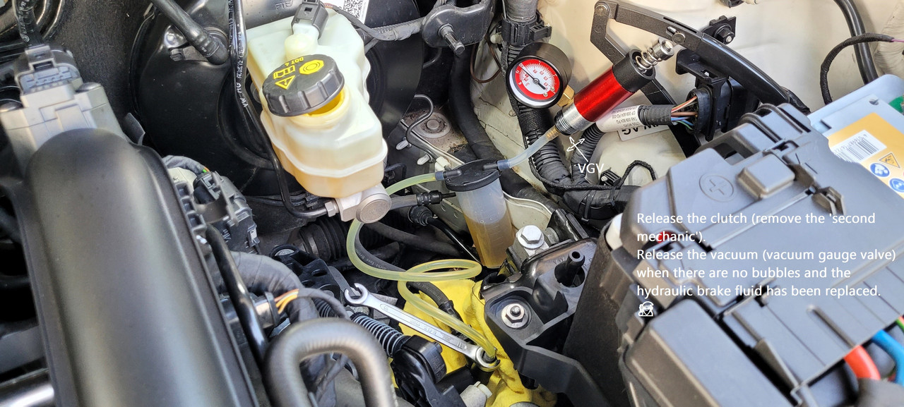

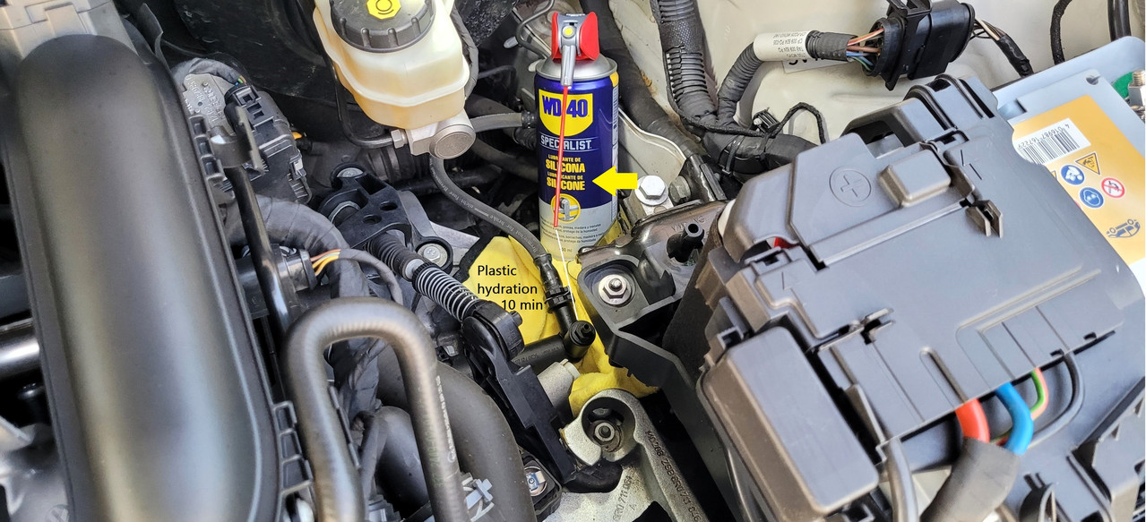

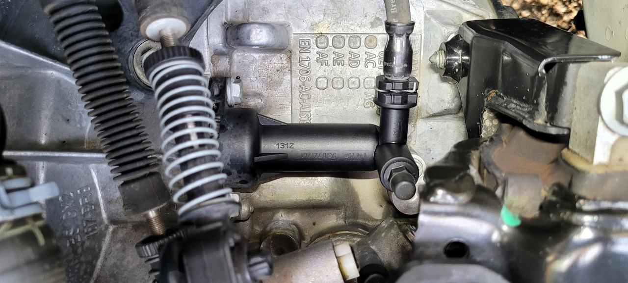

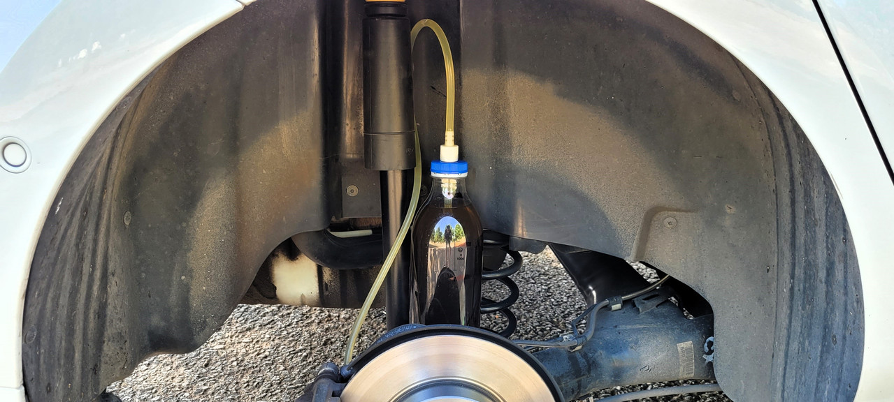

POLO 6R. Clutch slave cylinder. Hydraulic fluid replacement and bleeding (ciclo method).
A wonderful new day begins with extremely pleasant temperatures...
...it's possible some jerk will show up and ruin it.😁

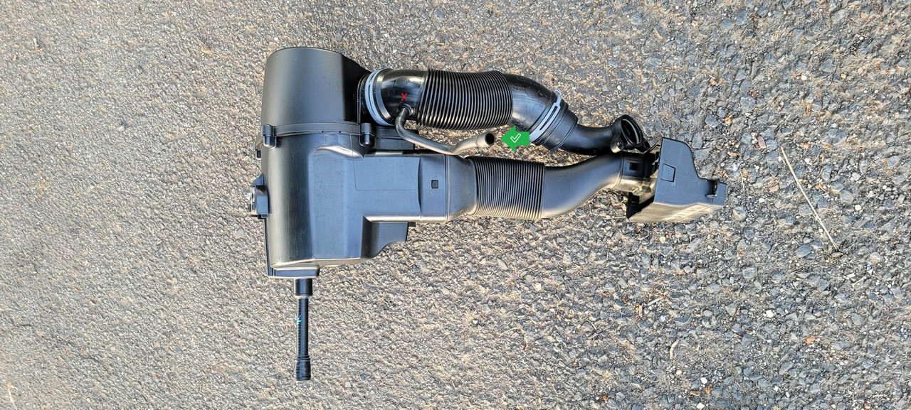

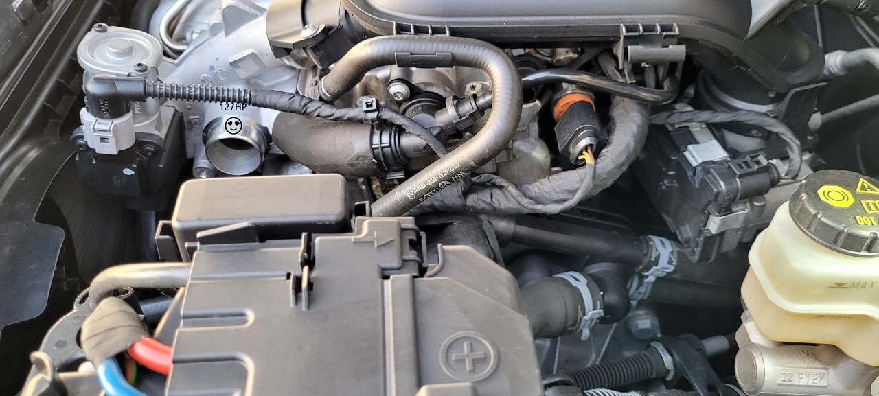

Remove the air filter box according to instructions in a previous post.
:lol:
The magic happens when you release the clutch, so pay attention!
No more efforts are necessary... ...
Now the clutch pedal feels like new, very smooth and pleasant.😎
