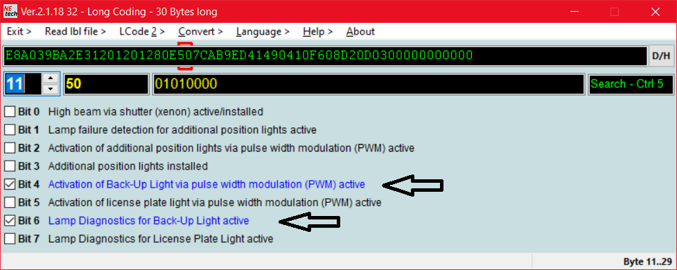

- Posts: 8992
Here is your current BCM coding without spaces between the hexadecimal-bytes, which is useful for verification using the appropriate software.
E8A039BA2E31201201280E507CAB9ED41490410F608D20D0300000000000
There are errors in the coding for the high beams and the dimmer.
If you followed the instructions below exactly for the H4 wiring installation:
viewtopic.php?p=528663#p528663
viewtopic.php?p=528735#p528735
This is the new BCM coding you should use:
E8A039BA2E31201201280E507CEB9ED41490610F608D24D1300000020000
and everything should work correctly,
Note: Before entering (copy-paste) this new BCM coding, undo any "custom" modifications or workarounds to avoid issues.
The electrical setup must be identical to the one described in the posts on page 4.

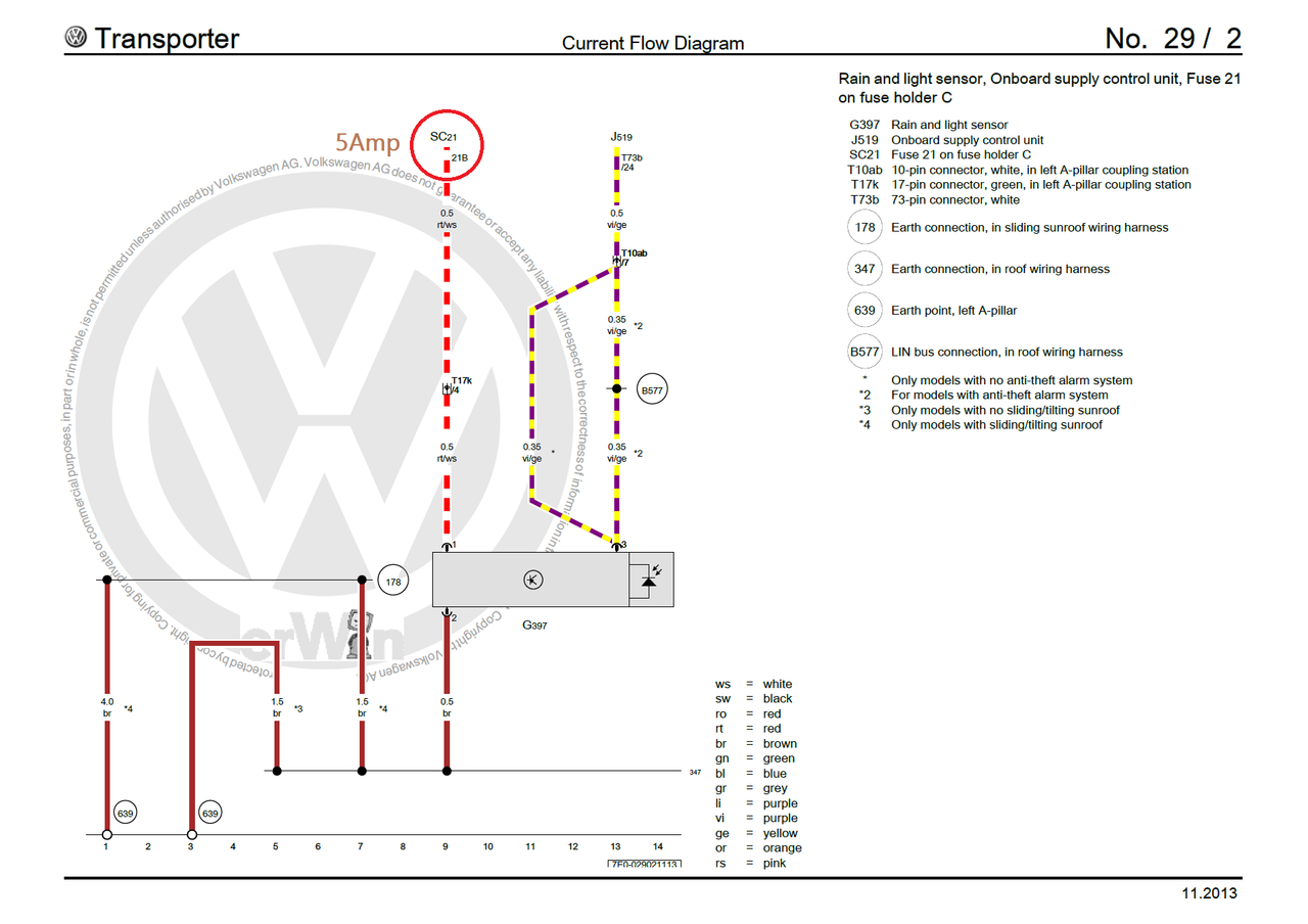

You can source the +30 power supply for the RLS from any fused +30 line. The RLS sensor has very low power consumption.
According to erWin, for the T5, it should come from the SC21 fuse.

Ciclo, thank you, you’re the best.
The code you provided fixed the problems with backlighting and the high beams.
In byte 11, I unchecked bits 4 and 6, which fixed the problem with the reversing camera.
Unfortunately, my VCDS doesn’t have descriptions for all the bits – for example, bit 4 of byte 11 – and from byte 22 onwards, I’ve practically no bit descriptions at all… hence the problems with correct coding.
There’s also a minor detail which isn’t particularly significant, but it intrigues me. ‘Coming Home’ works correctly, i.e. semi-automatically. However, ‘Leaving Home’ didn’t work and still doesn’t.
I didn’t mention this earlier.
As suggested, I’ll connect the RLS according to the diagram provided, which will allow the windows to close automatically when it rains
Gracias, Amigo
Gracias, Amigo
- Posts: 8992
The "Leaving Home" function will work once you have the RLS correctly connected.
The "Coming Home" function depends on your choice (via stalk), but the "Leaving Home" function depends on the RLS (via remote).

Thanks,
Connecting the RLS to +30 will probably fix the problem.
Because at +15, the RLS doesn’t have a continuous power supply.
Gracias
Gracias
