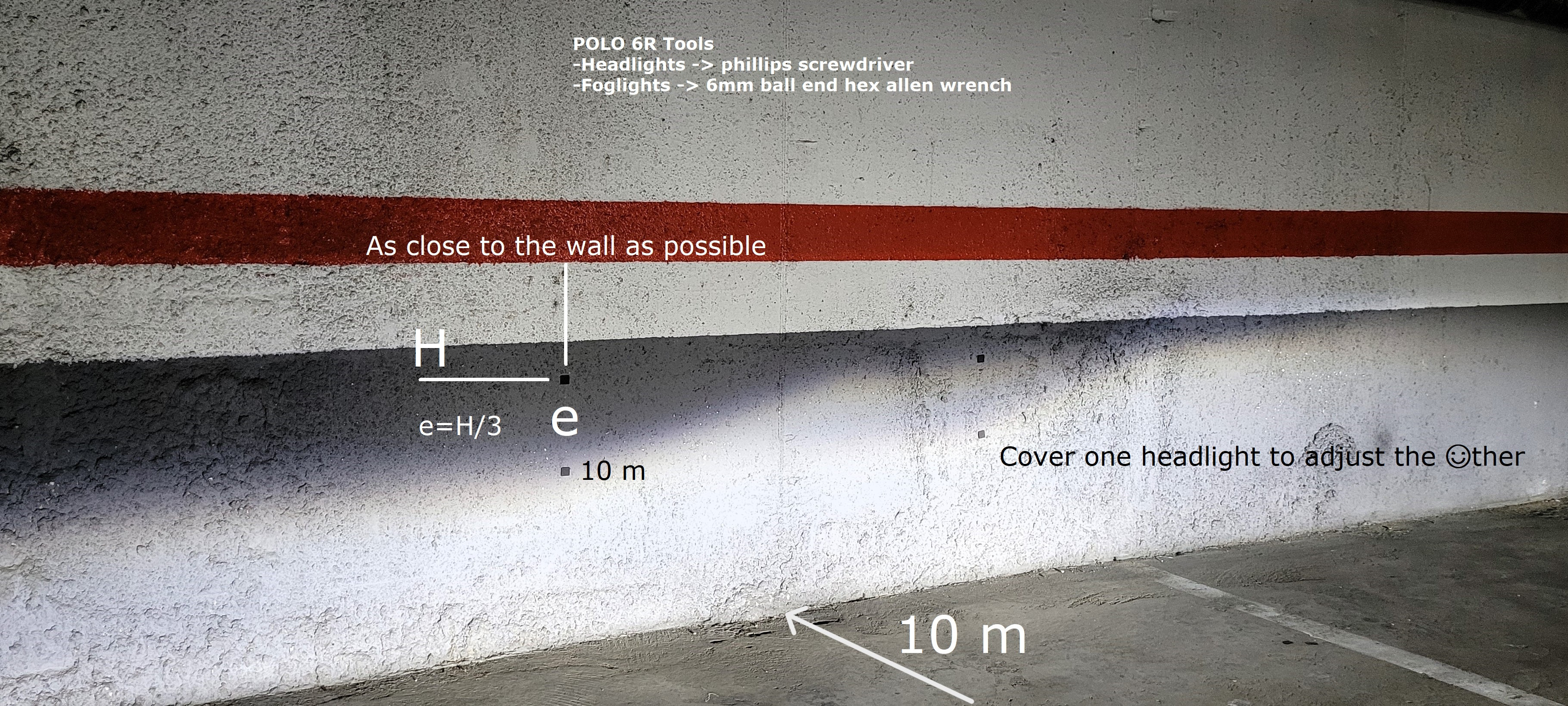

POLO 6R. Headlight Range (J431) 6R0907357'C' Installed.
Context: viewtopic.php?p=610837#p610837
Highlights.
VCDS.
Basic Setting. Calibration.
:arrow: viewtopic.php?p=609340#p609340
