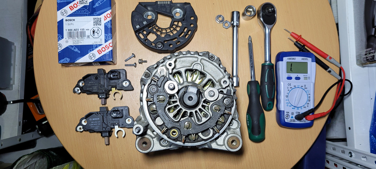

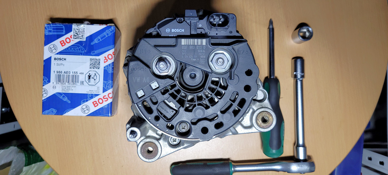

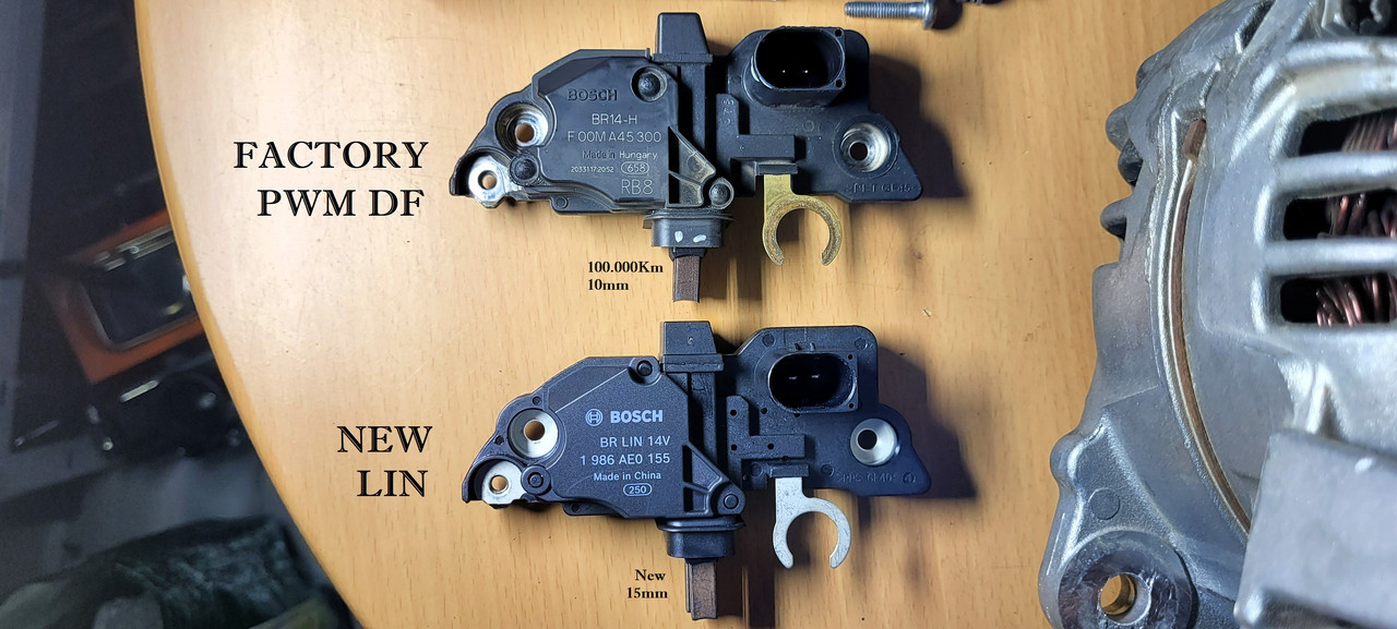

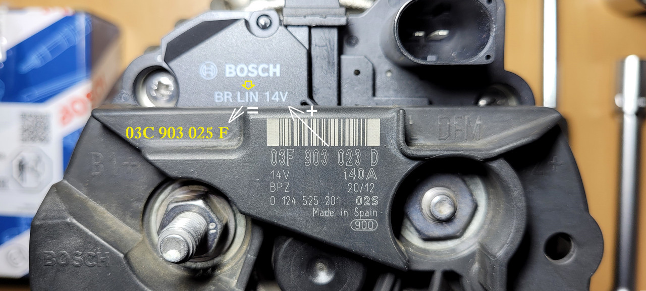

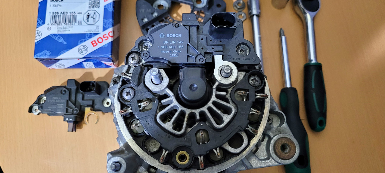

Small task. Factory 140A Alternator Conversion
Previously (READ): :arrow: viewtopic.php?p=610290#p610290
Replacement of the voltage regulator for PWM and DF signals with a voltage regulator for the LIN signal.
ℹ- I haven't tested it, but it should work perfectly. I'm keeping it in the garage storage room in case I need it in the future.🤗

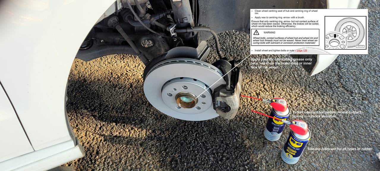

Some notes before replacing the brakes, brake fluid and rear shock absorbers.
Previously: :arrow: viewtopic.php?p=610353#p610353

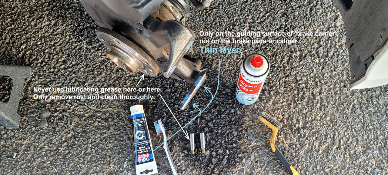

Use the right lubricants in the right places. The misuse of lubricating greases in modern brake systems is widespread.🤦‍♂️ There are even places where lubricating greases should not be used.
Don't overuse lubricating greases, more isn't better. the layer should be thin, 'TRANSPARENT', not like you're spreading butter on toast.😄
Read installation manuals to learn about the big mistakes you're making... workshops, etc.

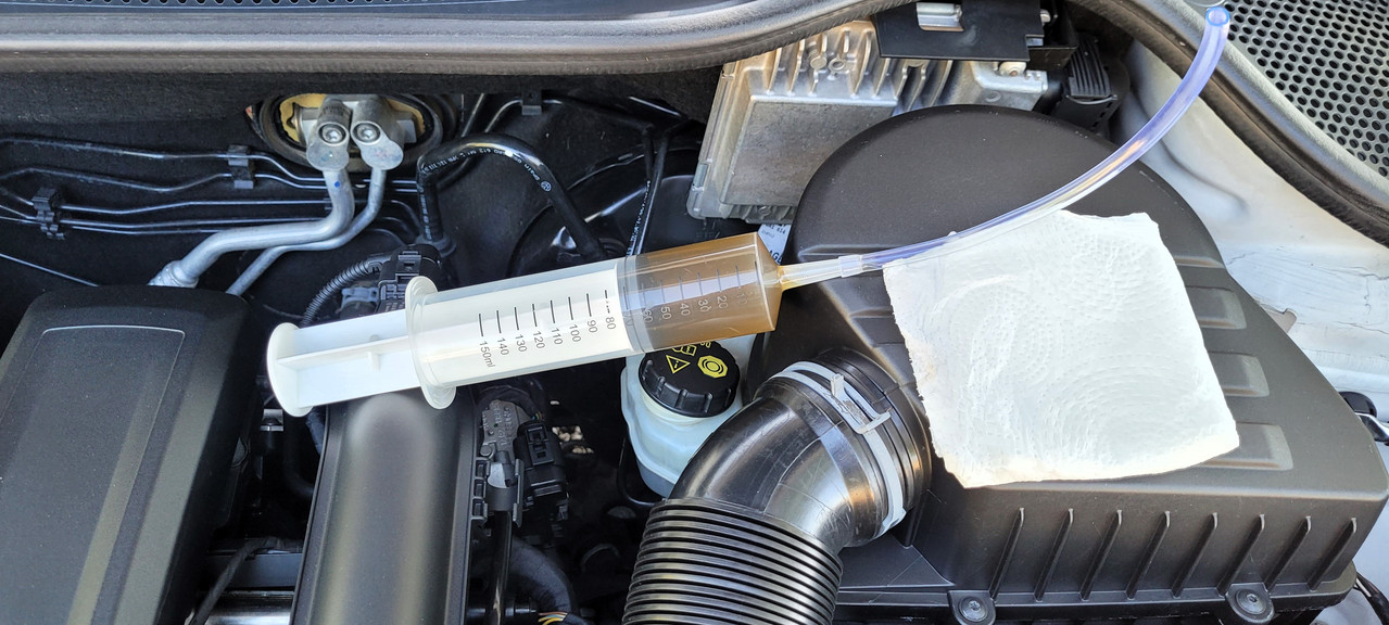

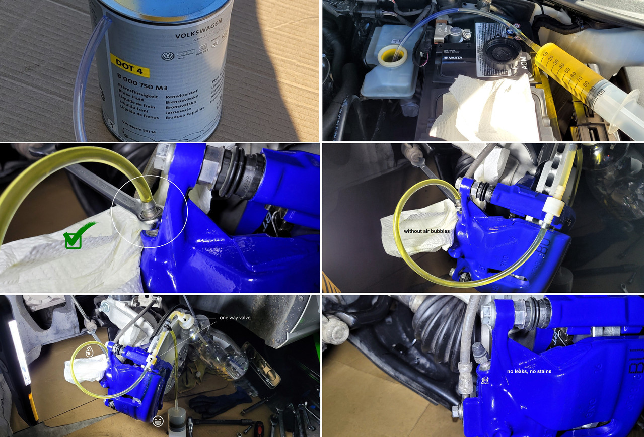

Example of brake fluid bleeding/replacement in our Golf with one-way valve.💎
The key is to prevent air from entering the system and not to use those rubber couplings (expensive or cheap) that attach to the bleeder valve, or by opening the bleeder valve too much.

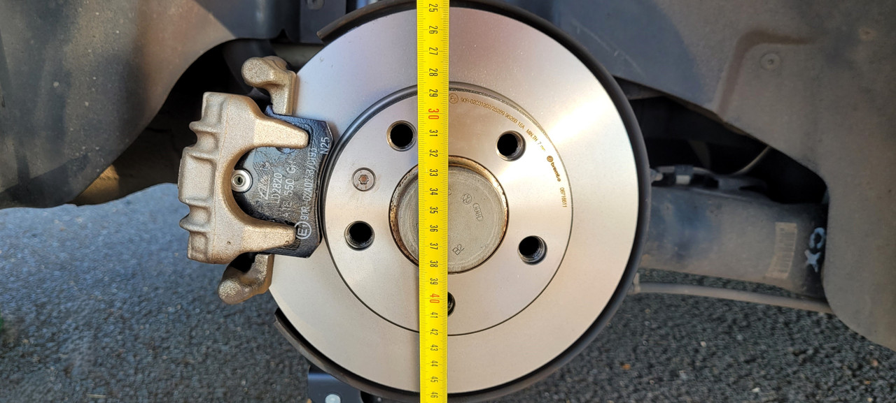

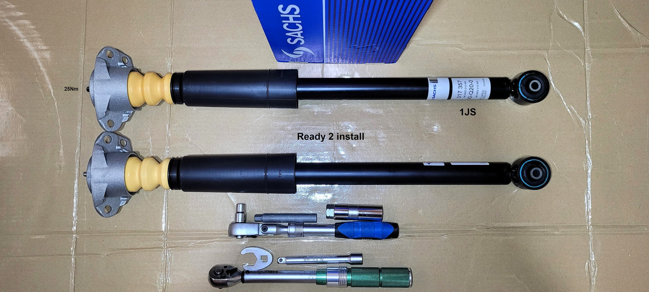

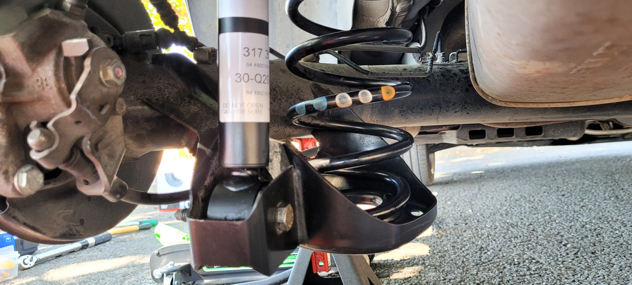

POLO 6R. 1JS rear shock absorbers and rear discs and pads installed.
- According to erWin. Torques, etc...
Highlights.
Related :arrow: https://www.youtube.com/watch?v=Md8MhKuA3-w :arrow: viewtopic.php?p=603171#p603171

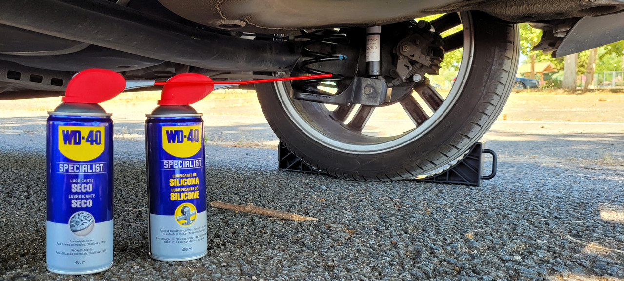

PTFE (Teflon) and Silicone Lubricants.
The factory 1JP shock absorbers showed their age. They were still functional and capable of reaching their full travel when compressed, but they were too easy to compress.

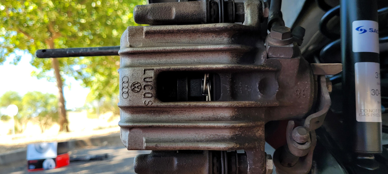

Regarding the rear brakes, nothing to add, it's an overdone, recurring topic on YouTube/internet.
The old parts went to the recycling point. During the drive, I did some gentle braking to allow the new pads and discs to bed in.
At the recycling point, I noticed that the UV coating on the Brembo discs looks very nice.
https://www.youtube.com/watch?v=FfnVHF1gdBo

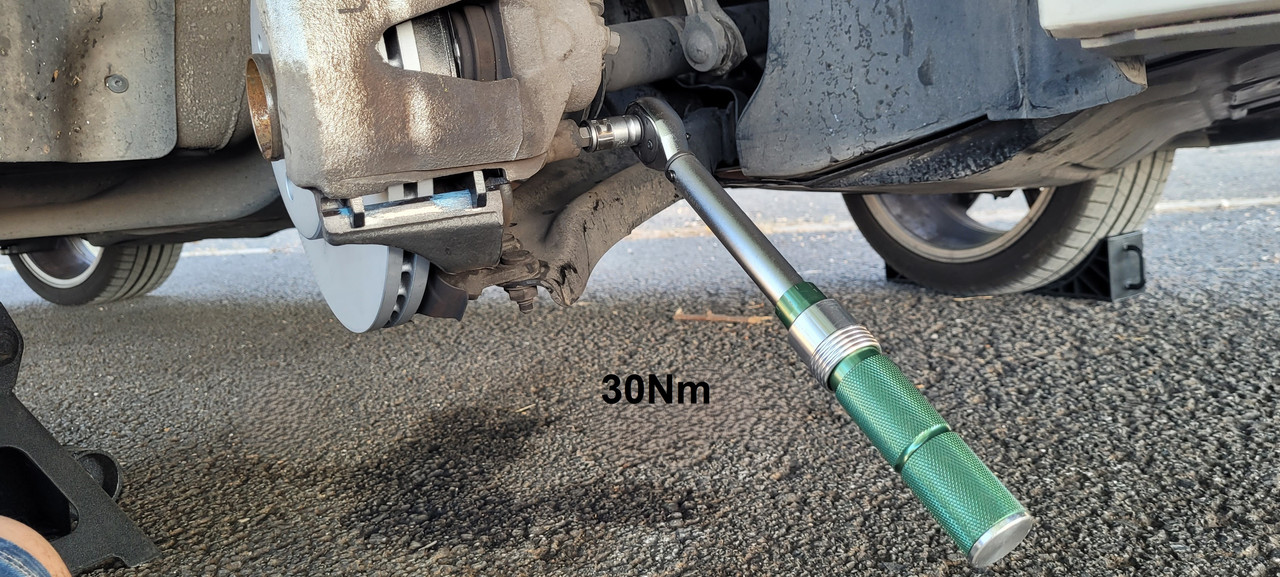

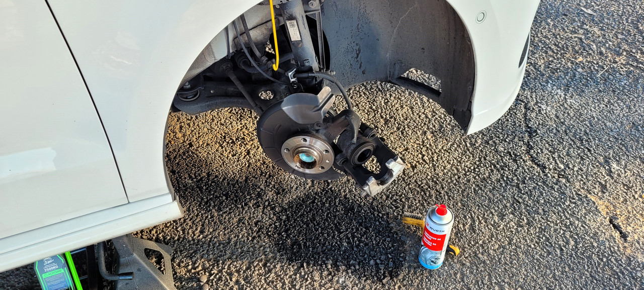

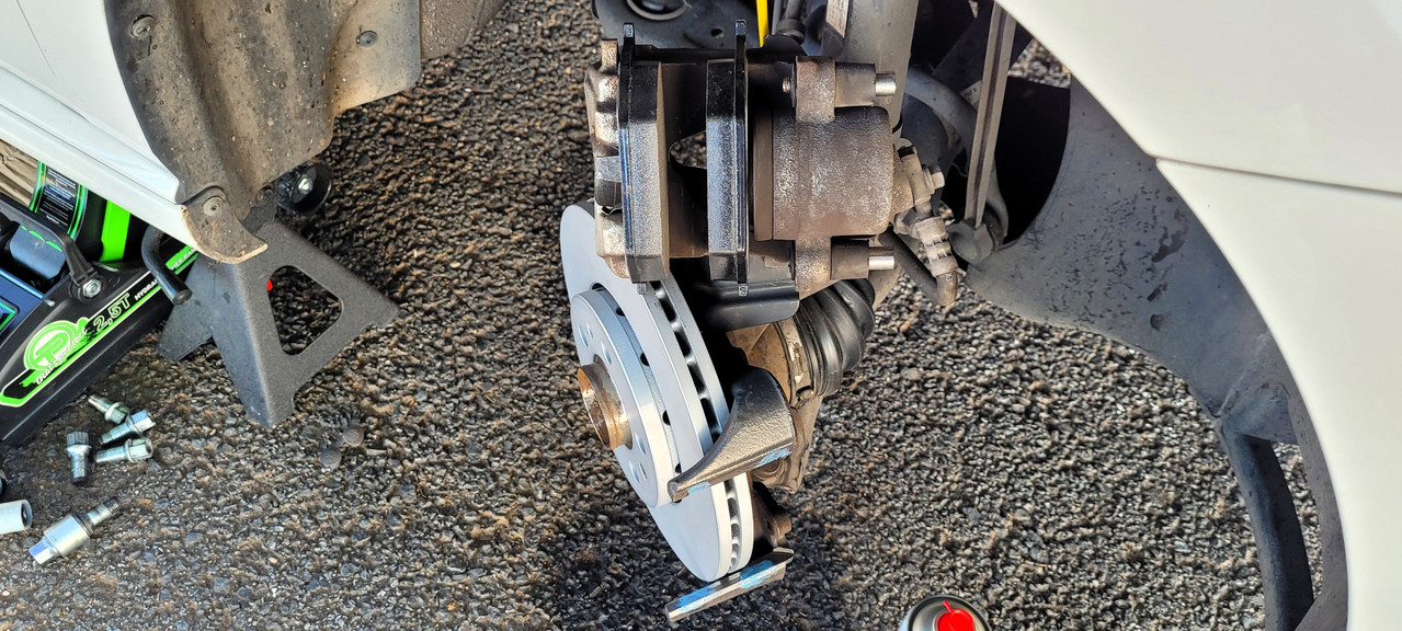

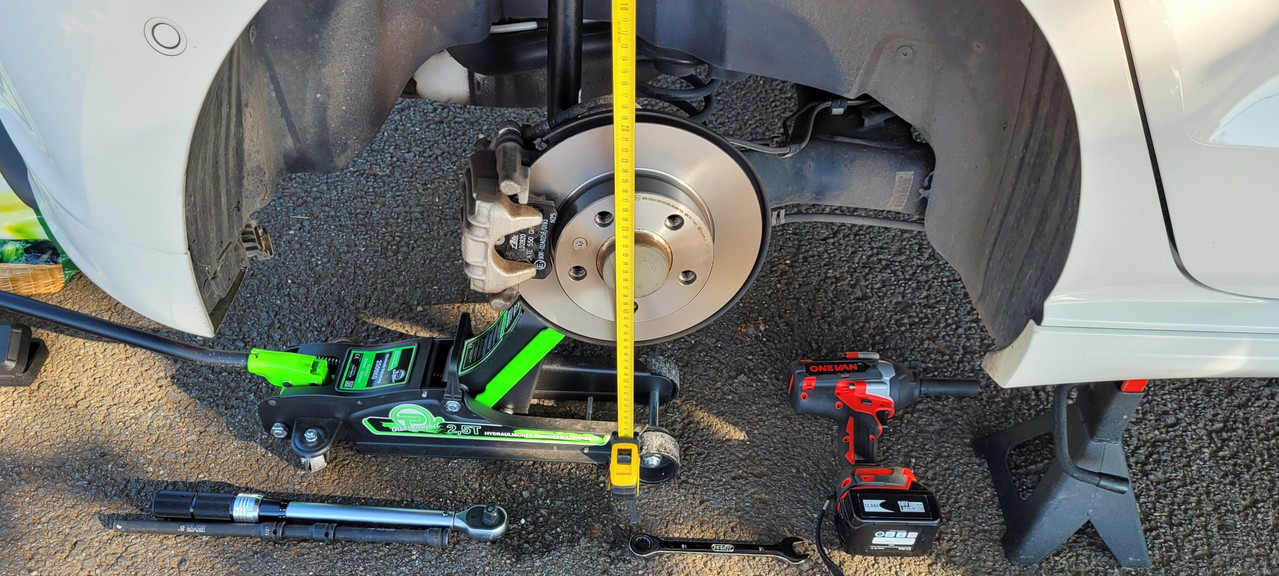

POLO 6R. Front brake pads and discs installed.
A good video tutorial: :arrow: https://www.youtube.com/watch?v=TQKMp6AQJYg
Note:

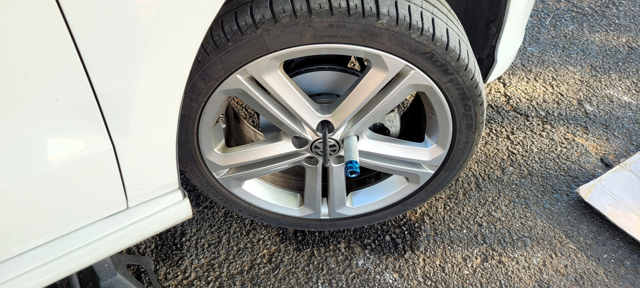

Before pressing the piston back into the cylinder with a piston resetting tool (e.g, prying with screwdriver), draw off brake fluid from the brake fluid reservoir. Otherwise, especially if the reservoir has been topped up, fluid will overflow and cause damage.
I had to remove 60 ml of brake fluid because the brake fluid was changed and set to max level at a VW dealership years ago when the brake pads were only half worn.
I'll be replacing the brake fluid in a few days...
Installation. Highlights.
Caution! New ATE brake discs have a protective coating that must be worn down by the pads during the first few kilometers. Once this coating is worn down, braking performance will improve. The new ATE ceramic brake pads then leave a transfer layer on the disc for proper operation.
I took the used parts to the recycling point, but this time I did a longer test drive to properly bed in the front and rear brake pads and discs, transfer layers, etc. Naturally, the improvement is total in terms of braking, and especially in the new behavior of the rear shock absorbers. Now, cornering in roundabouts and tight turns feels like a brand new car. The handling is also excellent in normal or sporty driving on any type of road, without sacrificing comfort.😎
On one of the next summer days I will be replacing the brake and clutch fluid to complete the unscheduled tasks.😊
Happy weekend to everyone... without exception!

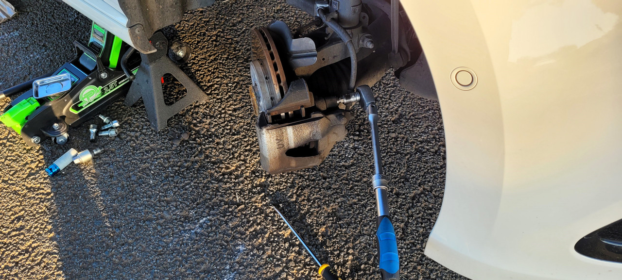

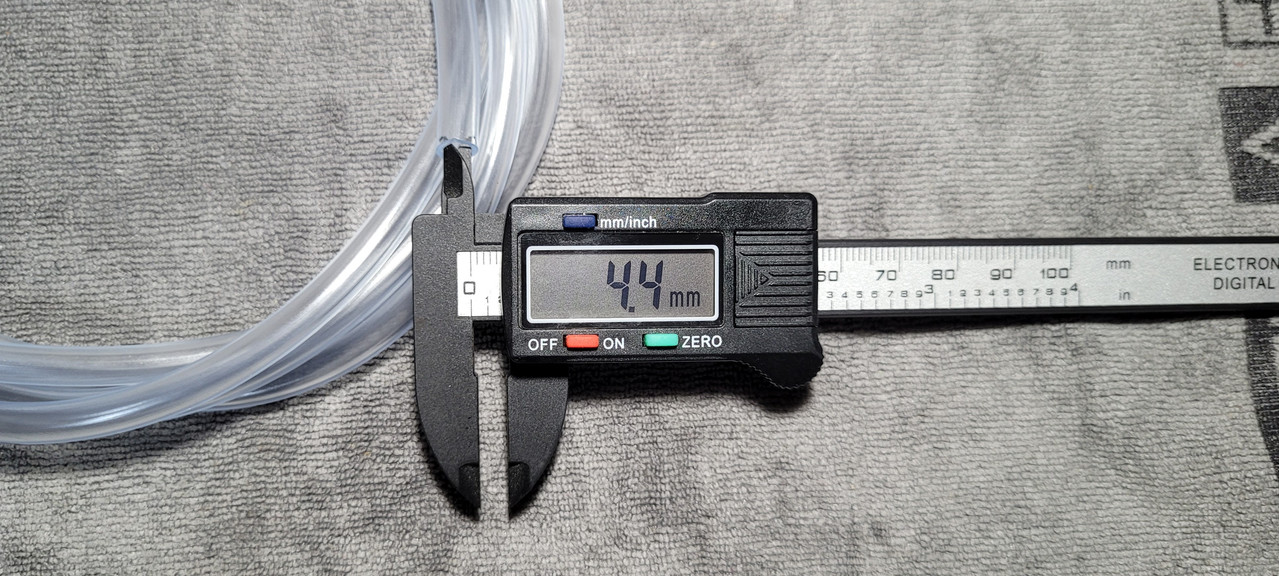

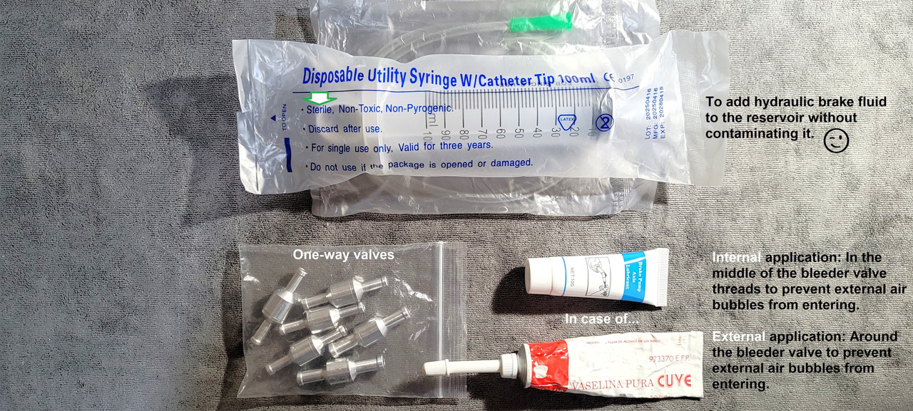

Some additional notes before replacing the hydraulic brake and clutch fluid.
Is your bleeding system (pumps, VAS) capable of not contaminating the new DOT4 hydraulic fluid after doing a couple of bleeds?😄

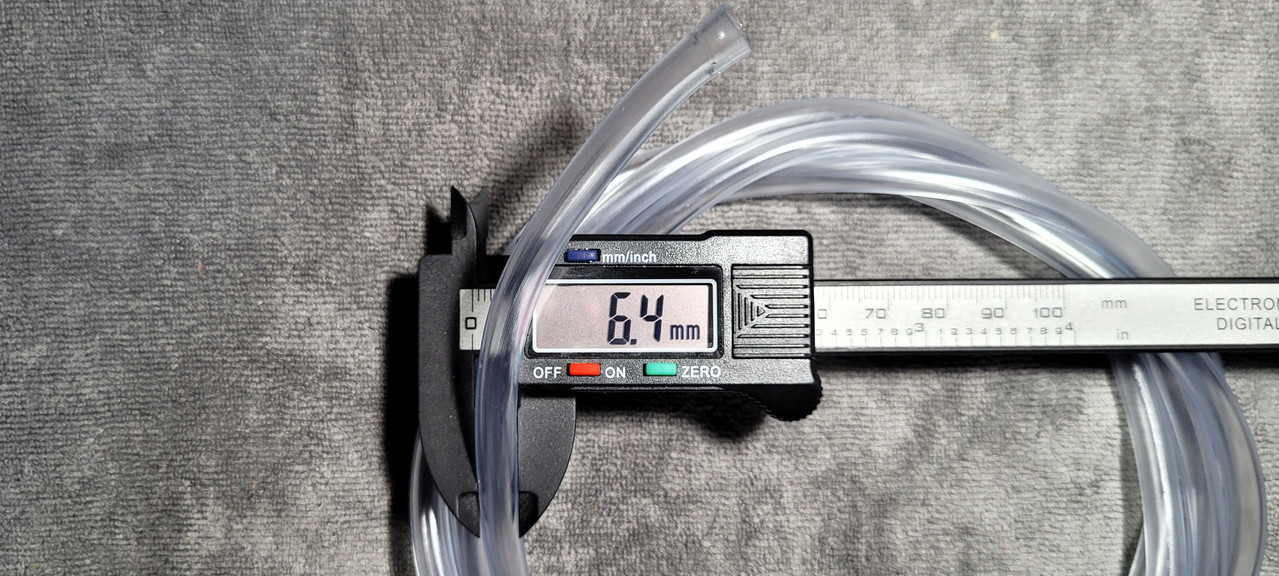

approx... +/- 0.5mm
I prefer not to take the risk with a 14-year-old piece of plastic and have the vehicle become immobilized in the middle of nowhere.
Trying to avoid inaccuracies in brittle plastic nut/bolt/bleeder subjected to 14 years of constant thermal changes.🤔

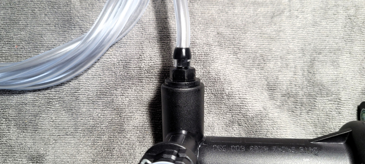

The brake fluid will be extracted/replaced by pressure/pumping using the one-way valve method, and the clutch slave cylinder fluid will be extracted/replaced using a vacuum system.
I leave you here a video that shows how to bleed the clutch in less than 10 seconds. Quick & Easy Method Explained!
:arrow: https://www.youtube.com/watch?v=DINu_uOrr5E
I would choose the optional part, cleaning is essential, as well as the final test.🤭
https://www.youtube.com/watch?v=RDsTeEiFFp4

POLO 6R. Brake fluid replacement/bleed.
No comment.
Question for VOLKSWAGEN:
How old do you think this brake fluid is?
Possible scenarios:
- The brake fluid was contaminated by the VAS pressure testing machine at the VW dealership where I ordered and paid for the replacement.
- The brake fluid used by the VW dealership is not the recommended type.
- They didn't change the brake fluid but charged me for it.
Any other scenario is IMPOSSIBLE.
...you already know, the future is for those who deserve it...
RL
FL
FR
RR
Test:
It's essential to activate the ABS regulation two or three times. Do this on a track/road with loose sand/gravel to avoid unnecessarily stressing the tires and brakes.
Bleeding the brake fluid for the clutch slave cylinder will have to wait for a cooler day (below 35ºC 💦), or maybe I'll do it in the garage.
Have a good weekend everyone... without exception!

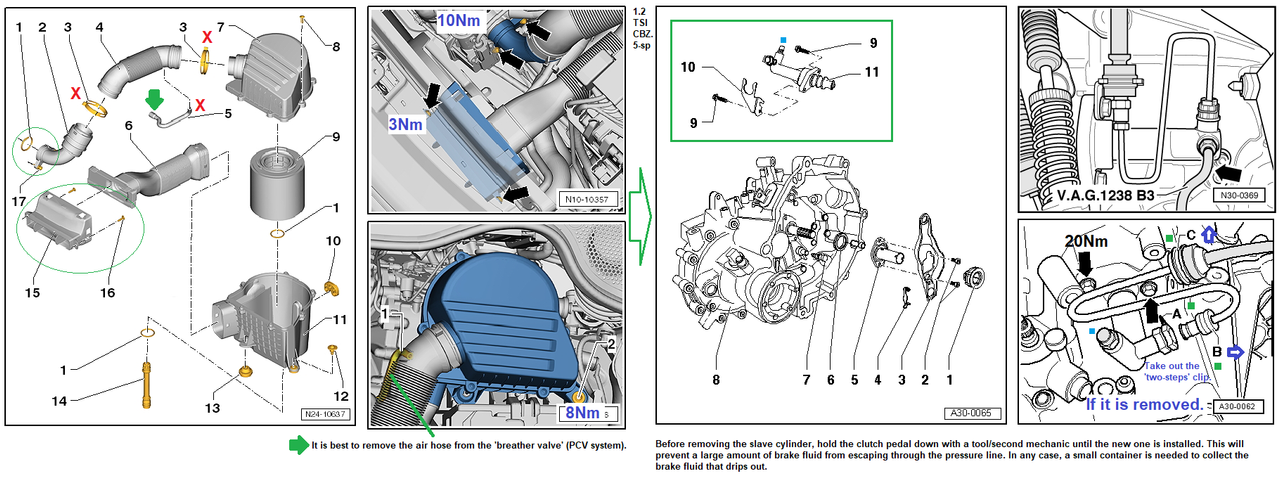

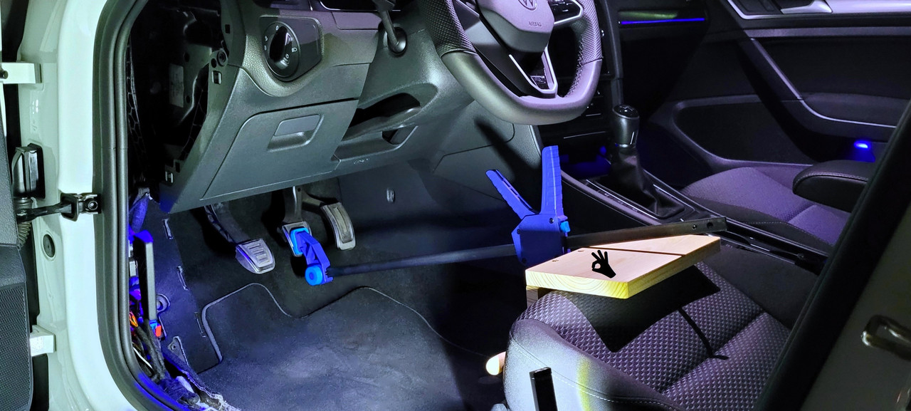

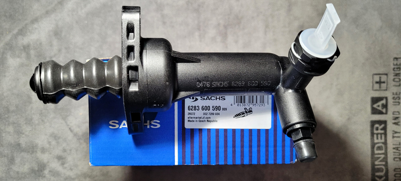

POLO 6R. Clutch slave cylinder. Hydraulic fluid replacement and bleeding (ciclo method).
A wonderful new day begins with extremely pleasant temperatures...
...it's possible some jerk will show up and ruin it.😁
Remove the air filter box according to instructions in a previous post.
Note: Plastic permeation, so that a native English speaker can understand it... without going into detail about the potentially super vague terms they use.👨‍⚖️
:lol:
The magic happens when you release the clutch, so pay attention!
No more efforts are necessary... ...
Now the clutch pedal feels like new, very smooth and pleasant.😎

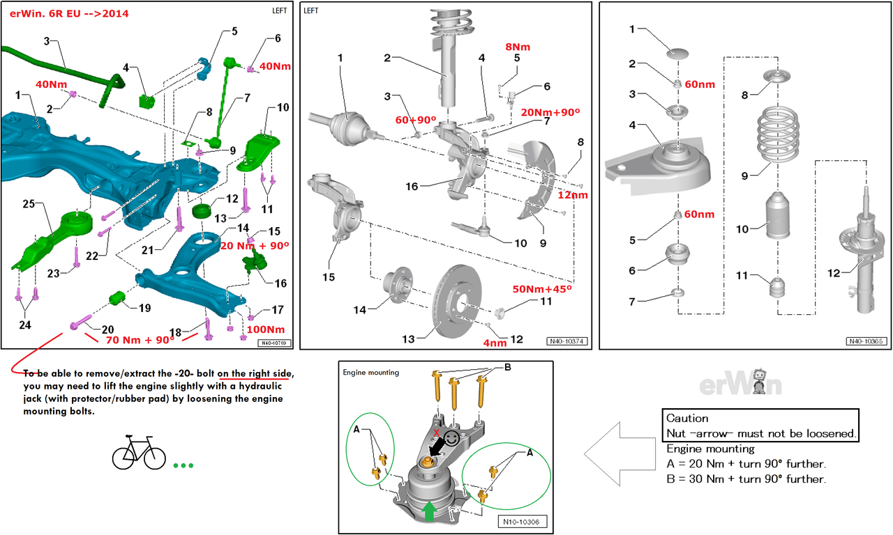

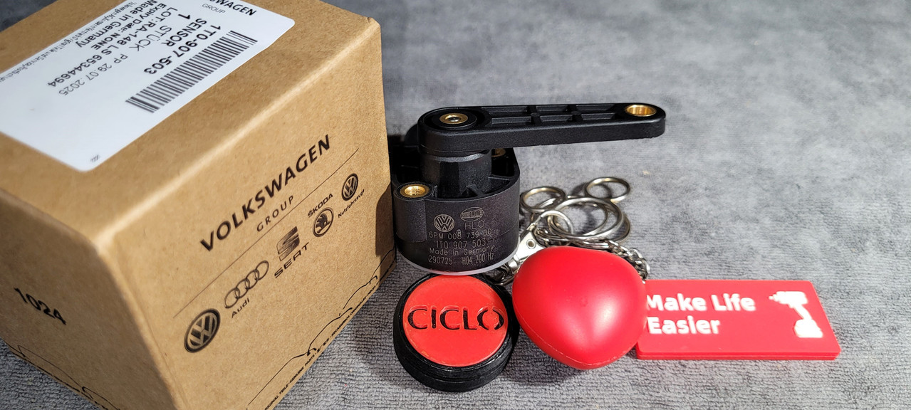

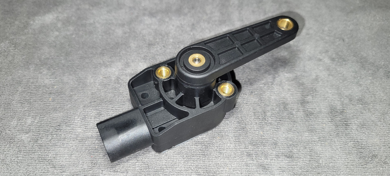

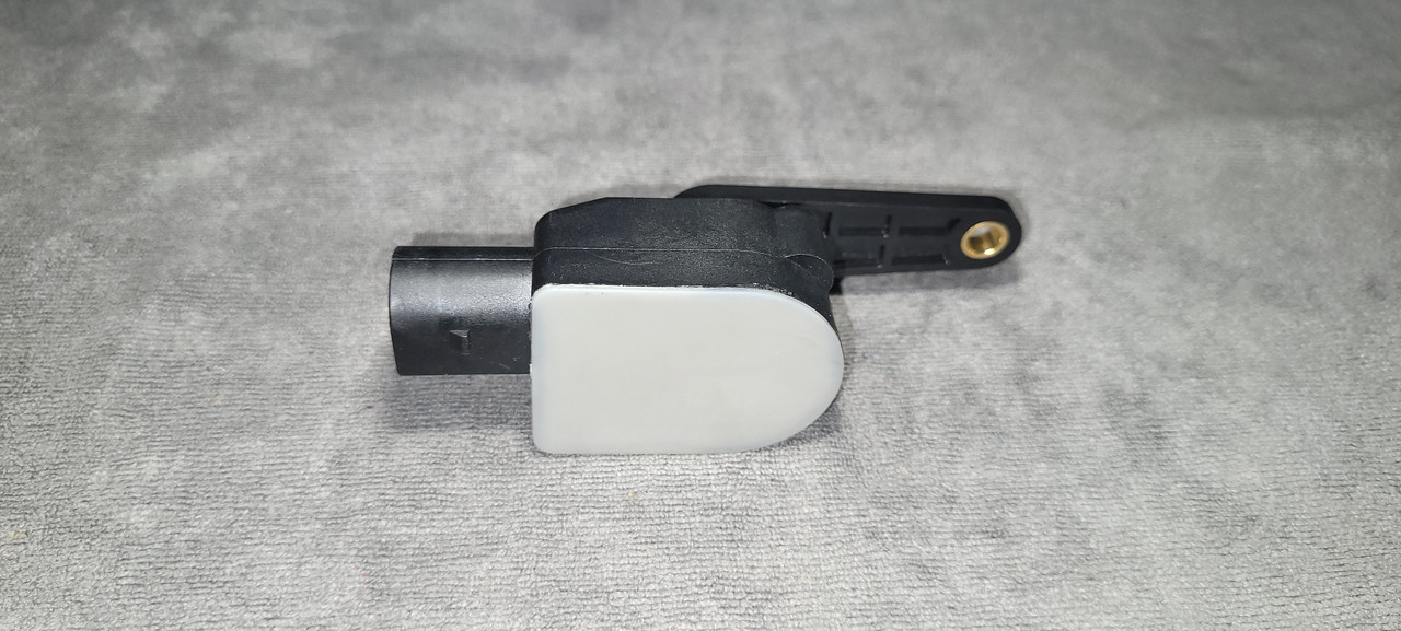

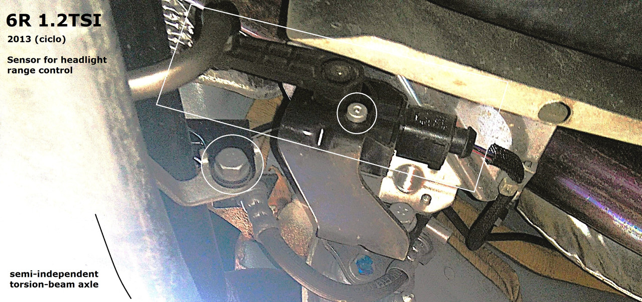

To close the loop on the unscheduled tasks:
- Replacement of front shock absorbers, control arms/suspension links, anti-roll bar links/coupling links, and swivel joints.
Images of the front shock absorbers and springs ('Sport', not GTI) of my 6R 1.2 TSI R-line from the factory:
It seems that the shock absorber protection bellows came loose from the plastic fastening adapter.
With 100,000 km / 14 years, they still feel in very good condition. During the brake replacement, I verified that there are no signs of play in the suspension components or cracks in the rubbers.
I estimate that we will enjoy another 100,000km with our 6R, so it would not make sense to change these parts at 150,000km when the rubber parts and other elements have high wear.
These are the parts from the VW supplying manufacturers that I am going to change:

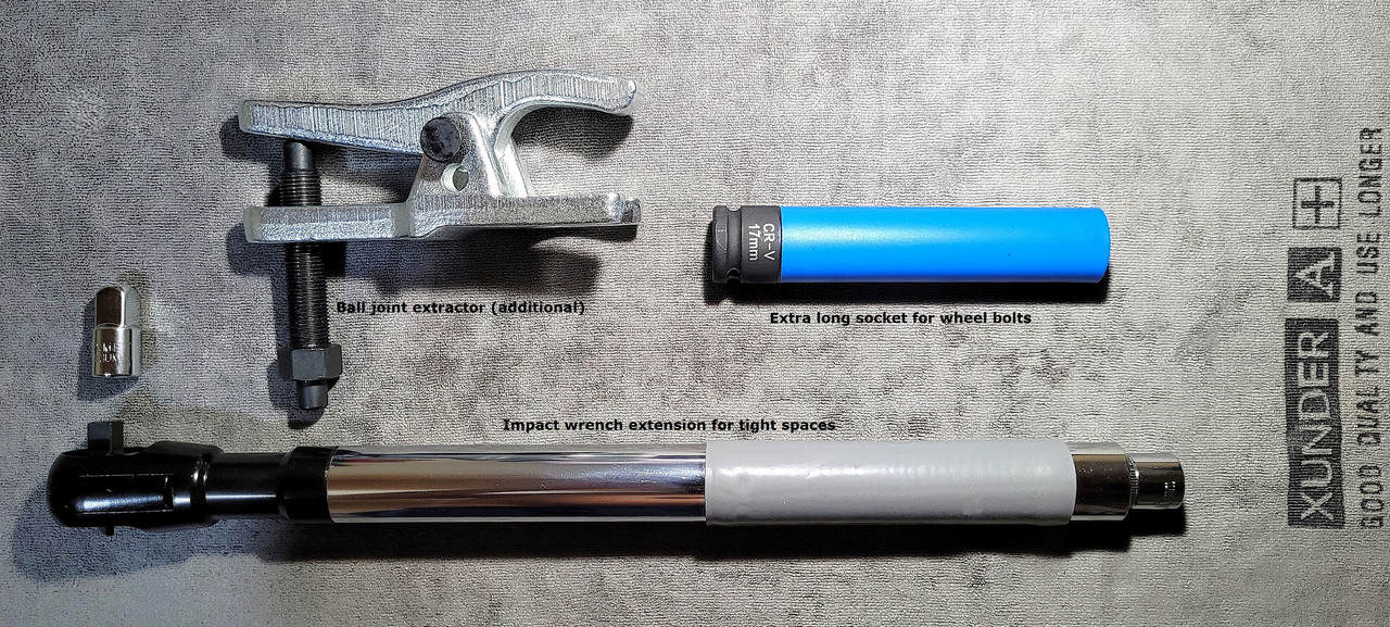

To ensure that the work is divine/spiritual and not earthly, bolts with angular torque/tightening should always be replaced.😊
I don't know the best time to install these parts. I have other jobs going on with vehicles that aren't mine. Family members and 'associates' are taking advantage of my vacation to use me as a simple mechanic.
I'll install them following erWin's instructions and take pictures of the key moments, that is, pictures of how not to use hammers or forks to remove ball joints during these tasks. :lol:

Since I'll be working on the rear torsion-beam axle to remove the rear springs to apply additional anti-noise measures, I'll remove the connecting bolt between the torsion beam and the headlight range control sensor, thus avoiding damage to the sensor's lever assembly.
For this reason, I've decided to buy a new sensor, to have on hand in case the factory sensor doesn't work correctly after reinstallation.
Main reason: these parts develop a certain way of working over time, that is, the way they wear out... and, a small mismatch during reinstallation on a sensor with 14 years of use —eg, due to tolerances in the joints or bolts— can cause malfunctions. This happened to me in our Golf, the headlight range control sensor (DCC-rear axle) was electronically fine, but it was randomly malfunctioning due to 'mechanical' issues after reinstallation (VCDS, ODIS, etc).
Other candies.😊
I have a set of BGS ball joint extractors, but this new extractor will allow me to choose how to proceed with removing them.
The temperatures are starting to be wonderfully favourable to begin the process of installing the front shock absorbers, etc... , but first I have to finish the project of installing the new sport springs on the Golf (in progress 😍, I will finish soon) to fine-tune the DCC suspension setting according to the dataset.
