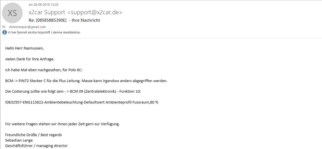

But i need the exact pin number or from where can i take the power, so is the anyone in here who can tell where to take the wire from?
