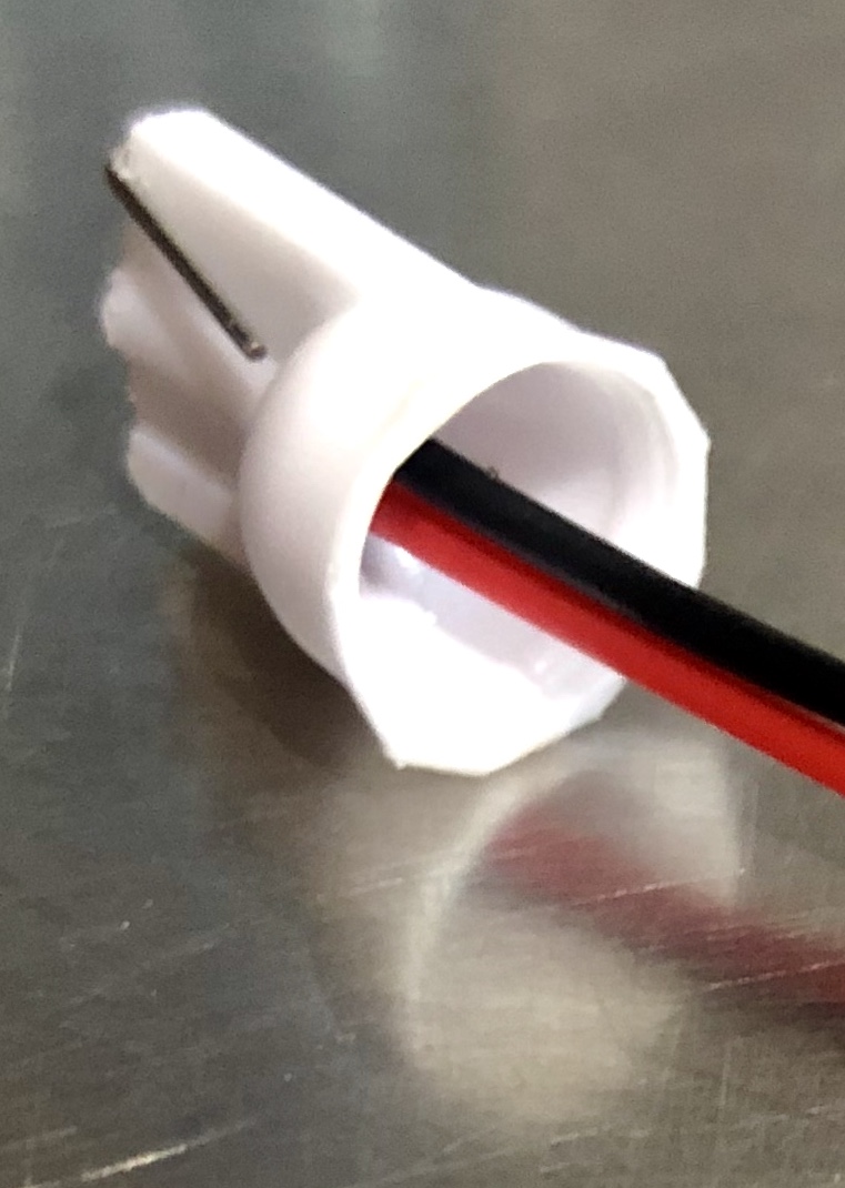

I would like to install a 1 metre led white strip an the inside of the trunk. Would I need to keep the led strip power under 5w?
Is it enough to connect directly to the bulb or is a resistor needed?
I found a T10 W5W LED Bulb Light Wire Harness Adapter on amazon:

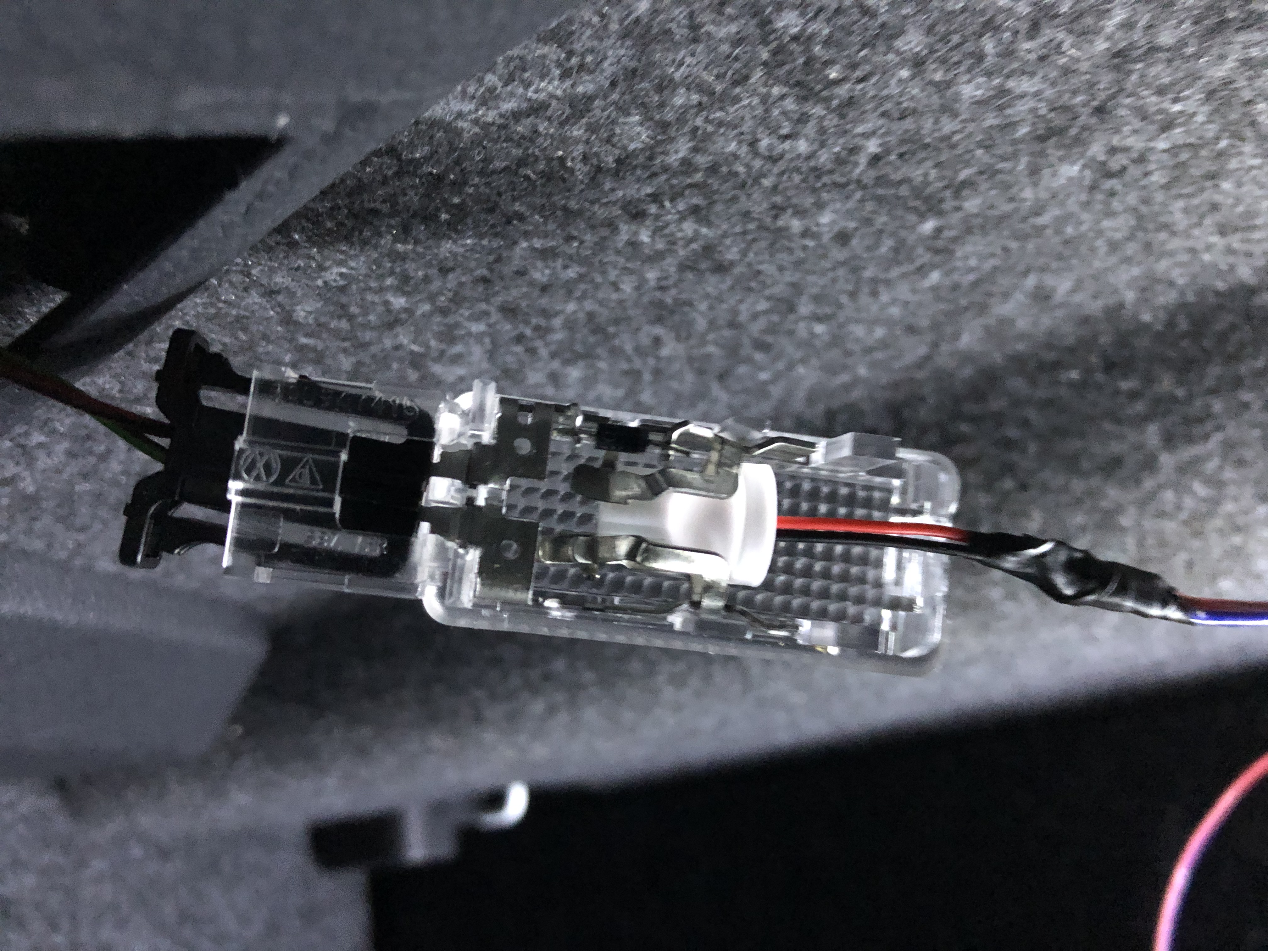

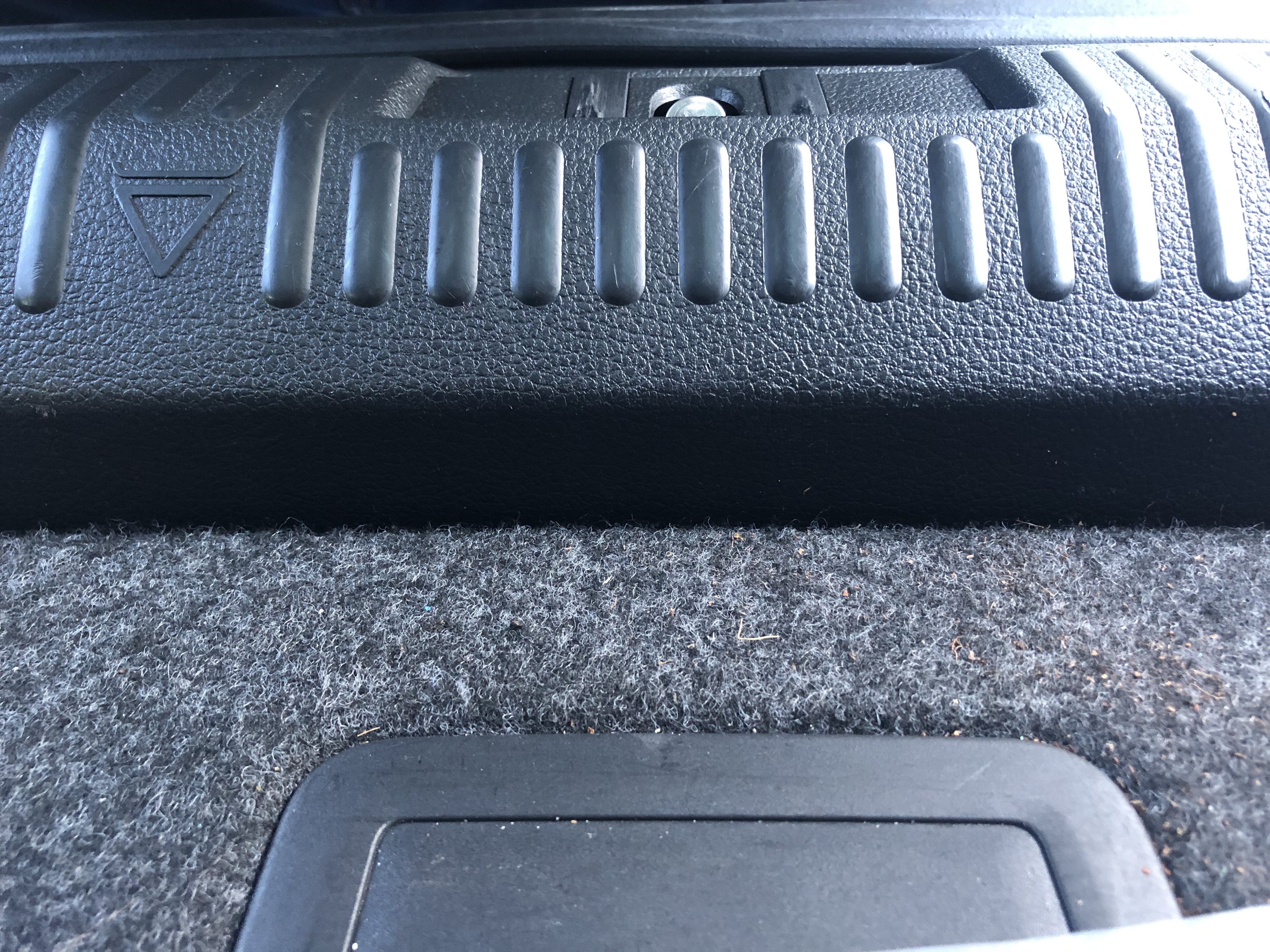

I was thinking of using a 1m cool white waterproof 3528 led strip with output power of 4.8w. The led strip has polarity so you need to match the positive and negative of the terminals.I will do a direct connection and see if it works fine and also if I get a canbus error.
The can bus error can be sorted either through vcds or with a resistor in parallel.
I found this company selling led strip with wire harness adapter with free can bus error bus it's in the US:
http://deautokey.com/product/1pc-hyper- ... -trunk-led

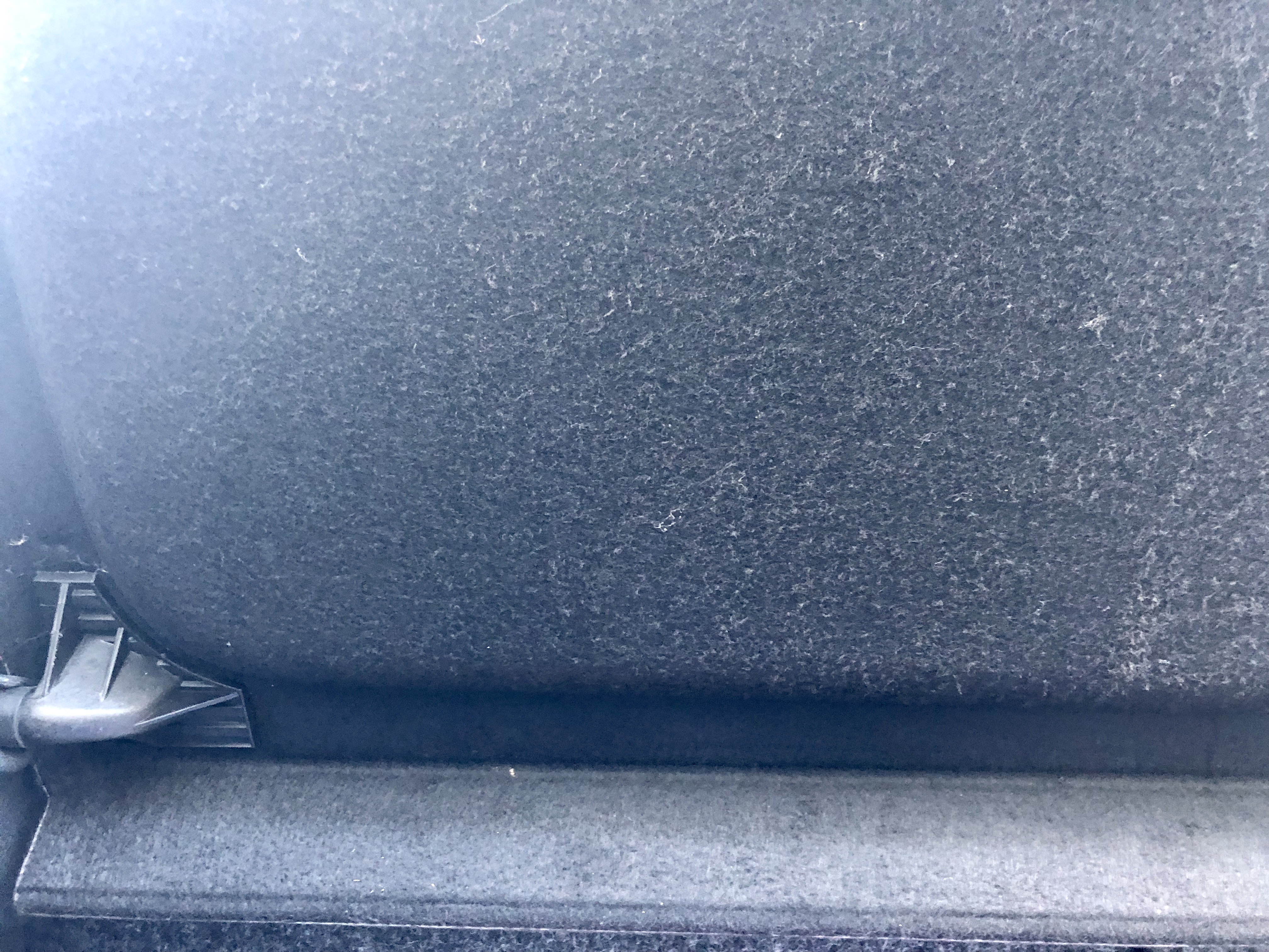

Also I can see two ways of positioning the led strip:
Here at the lower interior trunk:
or at the lower edge of the tray:

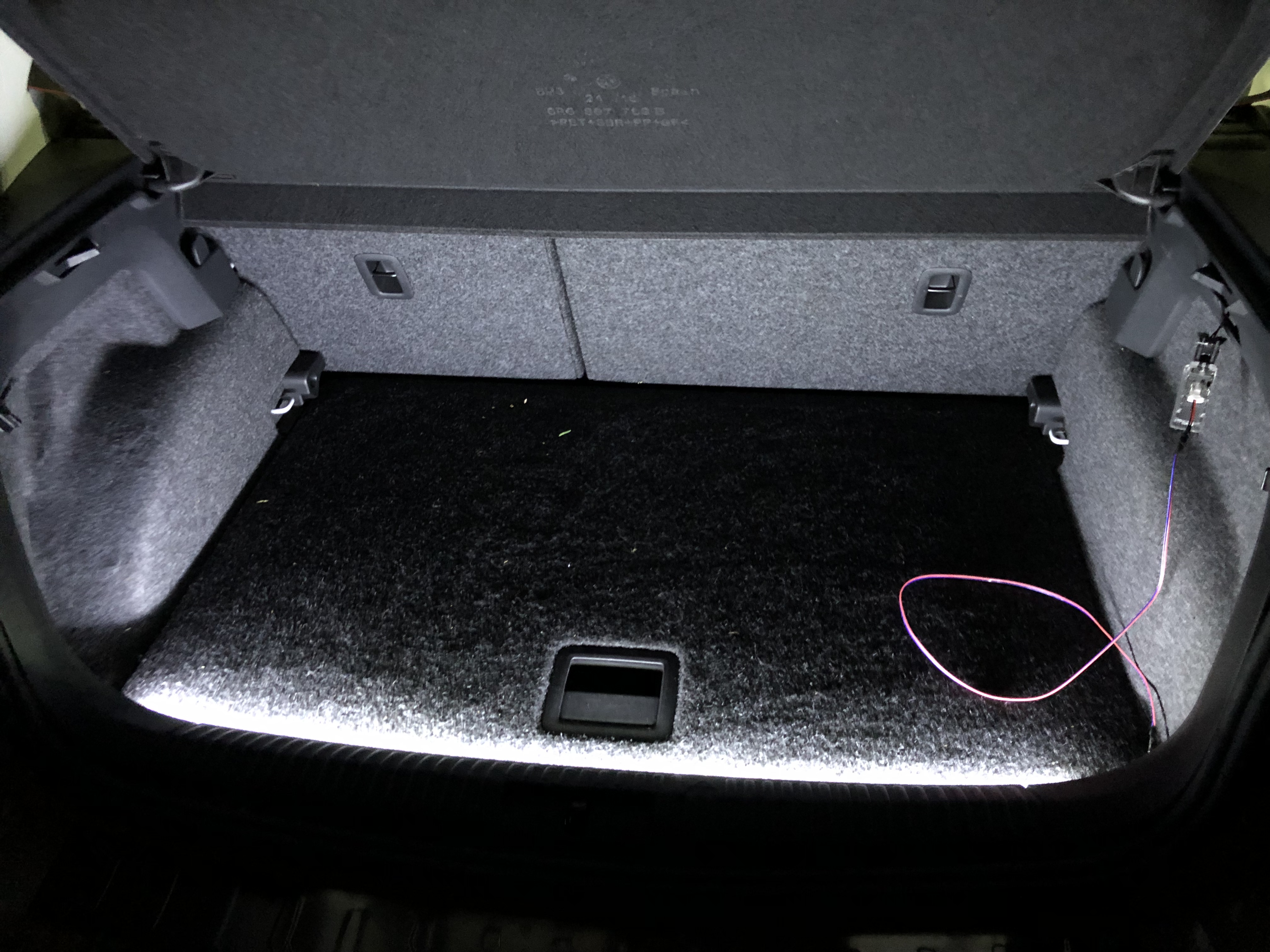

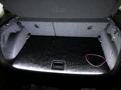

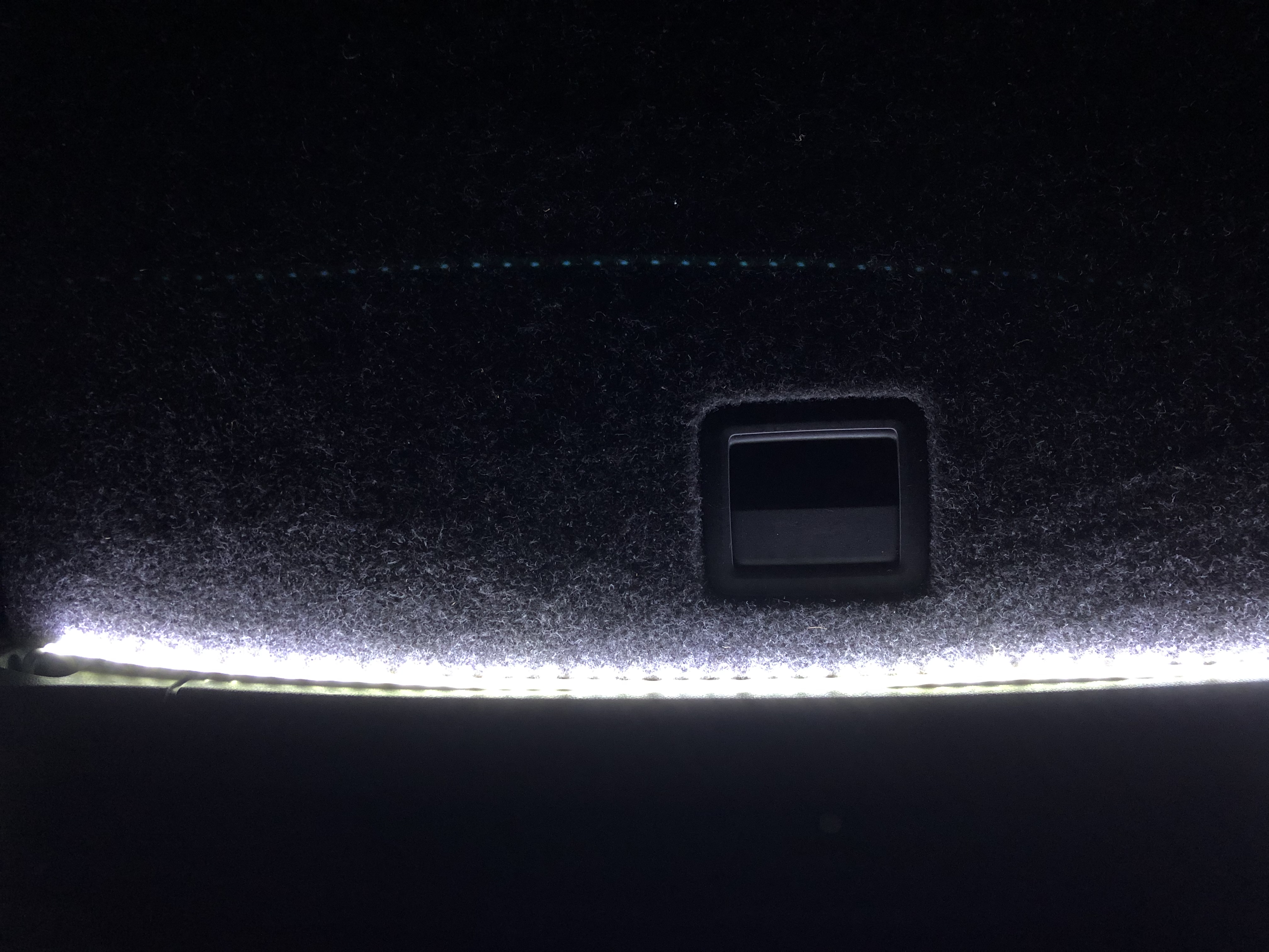

Did some testing and the led strip works perfect and great light inside. Kept the strip length to 84 cm which is just about 5w of power using 5050 cool white led. Also putting the strip below facing the boot illuminates all of it and wont affect anyone driving by...
The connector i used do not stay firmly in so i will do a different kind of connection.
massimo23
Posts: 128
Joined: Sun Nov 18, 2018 1:57 pm
Drives: Polo Beats 2017
Location: Ireland
Re: Want to install Led Strip replacing the Trunk light.
Post by massimo23 »
Hi So i removed the edge around the Circular part as seen in the image and it fits perfectly.
Also no canbus error and no light flickering ;-)
Also no problem in lifting the trunk's internal coverboard , just push it back a bit...
