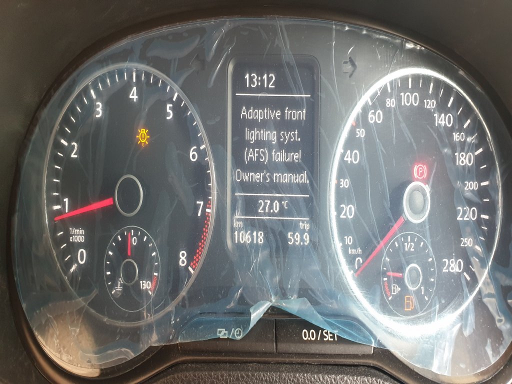

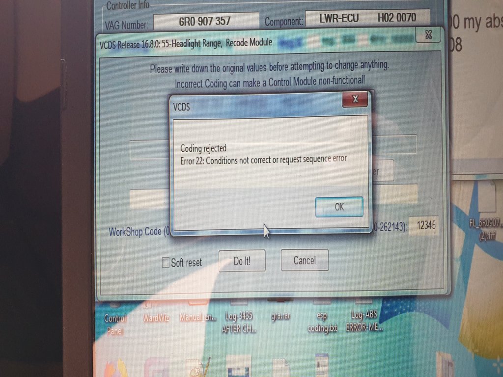

Good Morning everyone I had new error in my car IC image attached.I did not know why it comes. When i attached VCDS i had found error in headlight range (55) log is under.When i want to feed original coding there is an error which is attached under.please tell me how can i get rid of it.
Thank you to all in advance .

From where did you get the headlight range control module ?? dont tick headlight light control in installed components list then try original coding

It has working earlier but after update it is not coding .I had updated its firmware that i had downloaded from erwin with this FL_6R0907357___0070.frf firmware.i had tried as you suggested hmthakur but not get succeed .

Yes sir it is only for C version I had used this xml file but did not succeed. ODIS E refused to flash.
