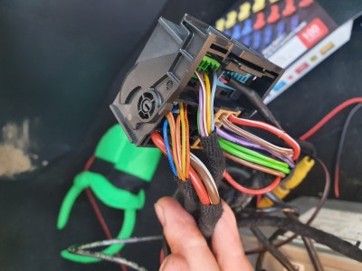

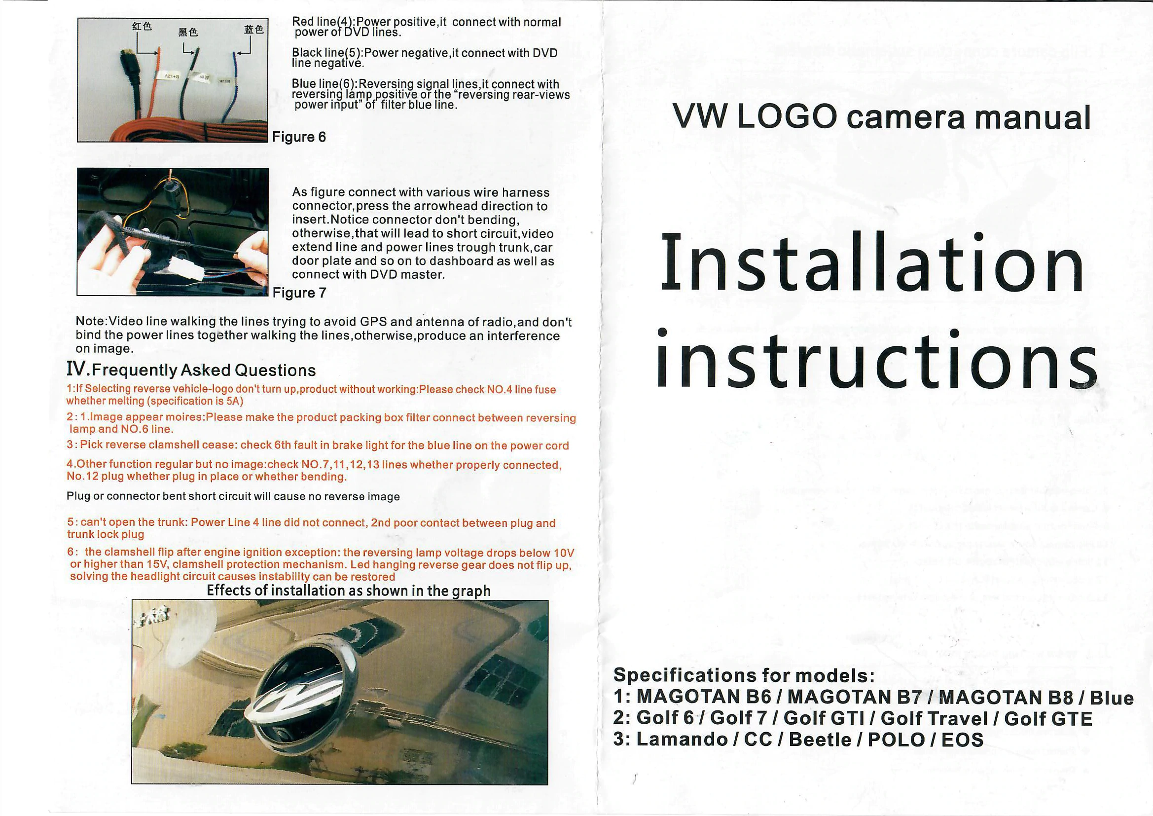

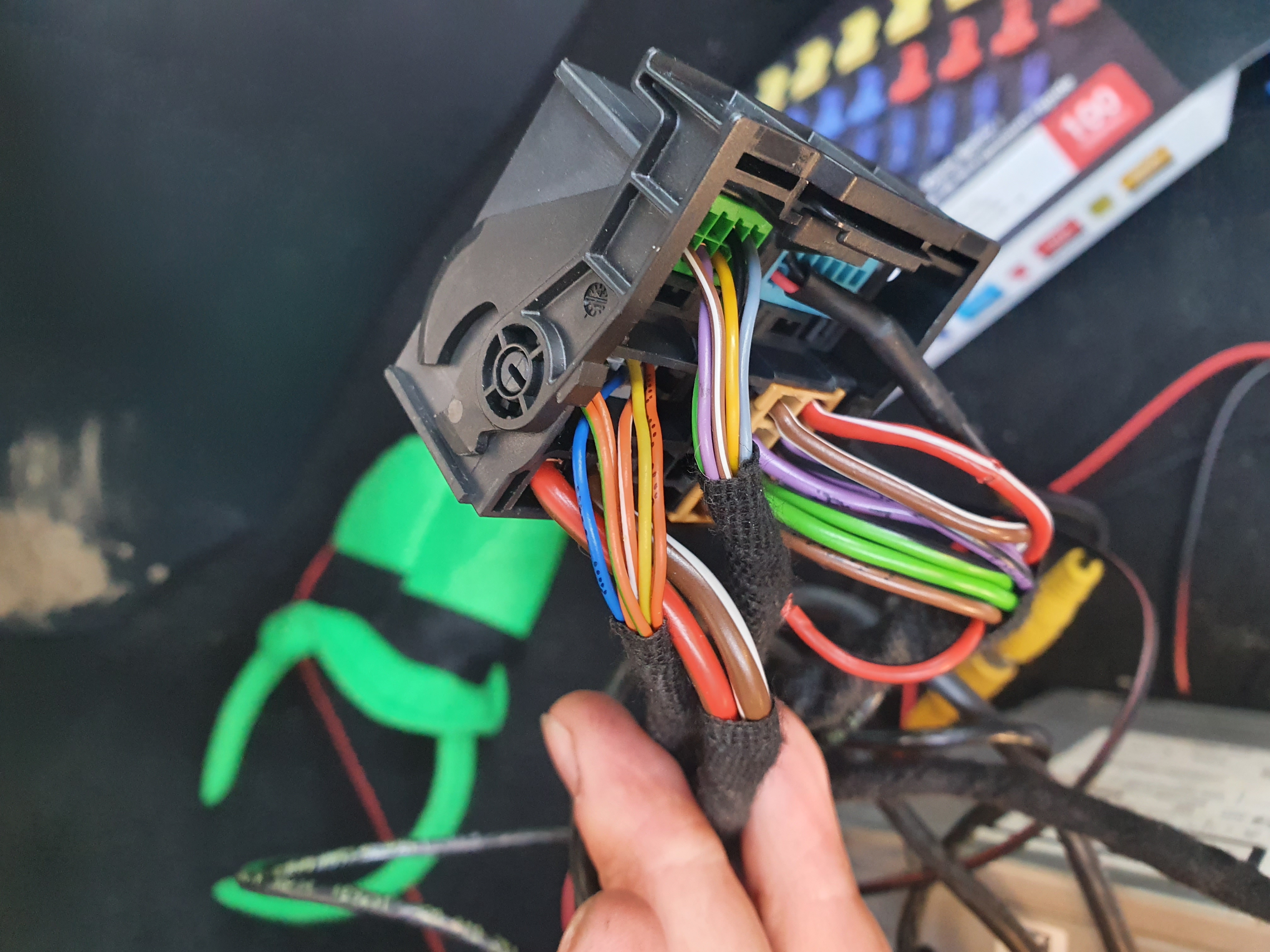

struggling to figure out the wiring for my reverse camera. ive got it all wired through the car but im stuck on these final wires
i have a MIBII unit. my instructions say connect to pos and neg from dvd lines
MIBII doesnt have dvd lines??
Last edited by JaegerStriker on Sat Apr 25, 2020 12:16 pm, edited 1 time in total.
- Posts: 6686
Re: Reverse camera
Use T12/6 and T12/12 of the blue connector of the quadlock. I can't tell you what's the positive and negative though.

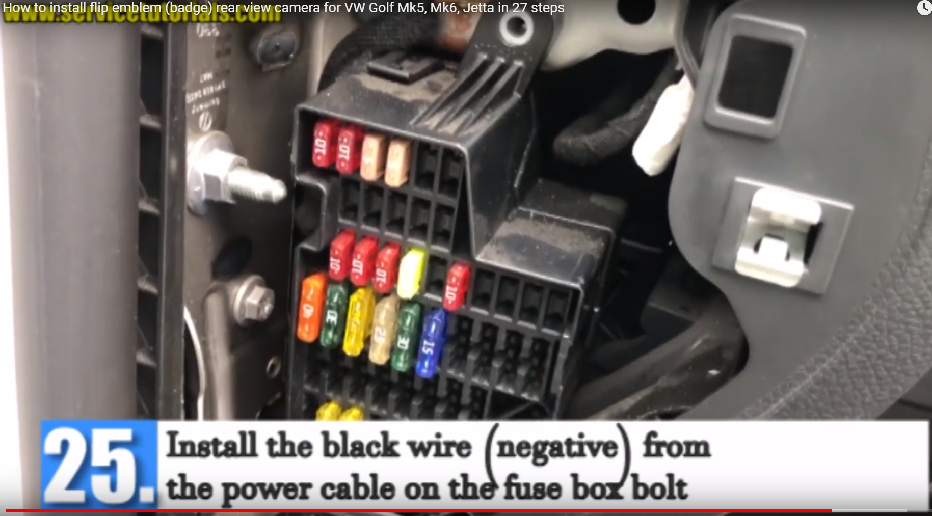

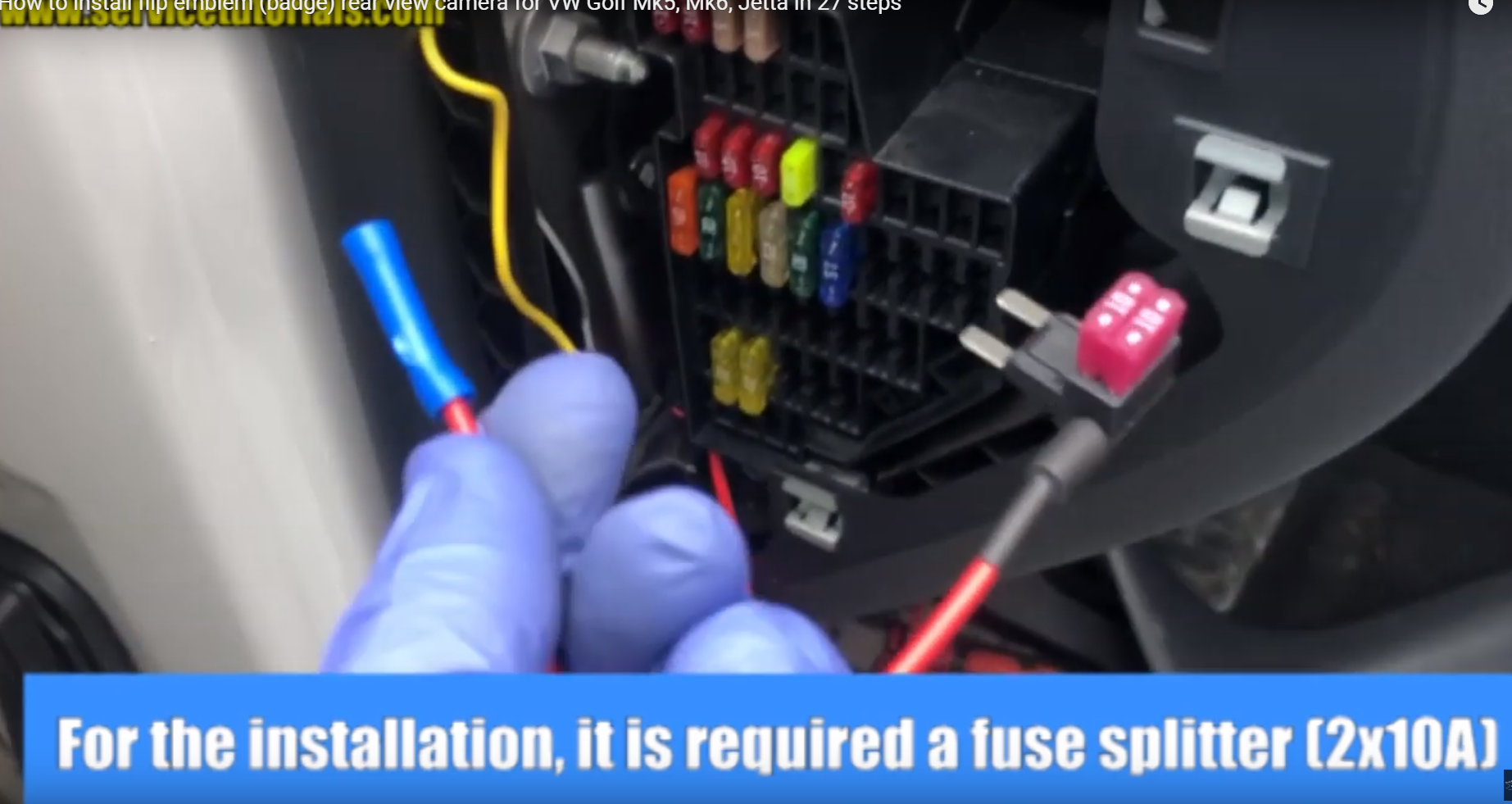

Re: Reverse camera
ive found this video. looks like the exact same kit ive got. do you reckon this would be the easier way to connect itiichel wrote: Thu Mar 26, 2020 11:32 am Use T12/6 and T12/12 of the blue connector of the quadlock. I can't tell you what's the positive and negative though.
https://www.youtube.com/watch?v=pnpN7ZUtryk

Re: Reverse camera
red into fuse splitteriichel wrote: Thu Mar 26, 2020 2:04 pm Could you give me a tl;dr? I don't really feel like watching a 17 minute video![]()
black into ground?
- Posts: 6686
Re: Reverse camera
Ah yes, my mistake.
Connect the black to the thick brown/white wire (GND)
Connect the red to the thick red wire.

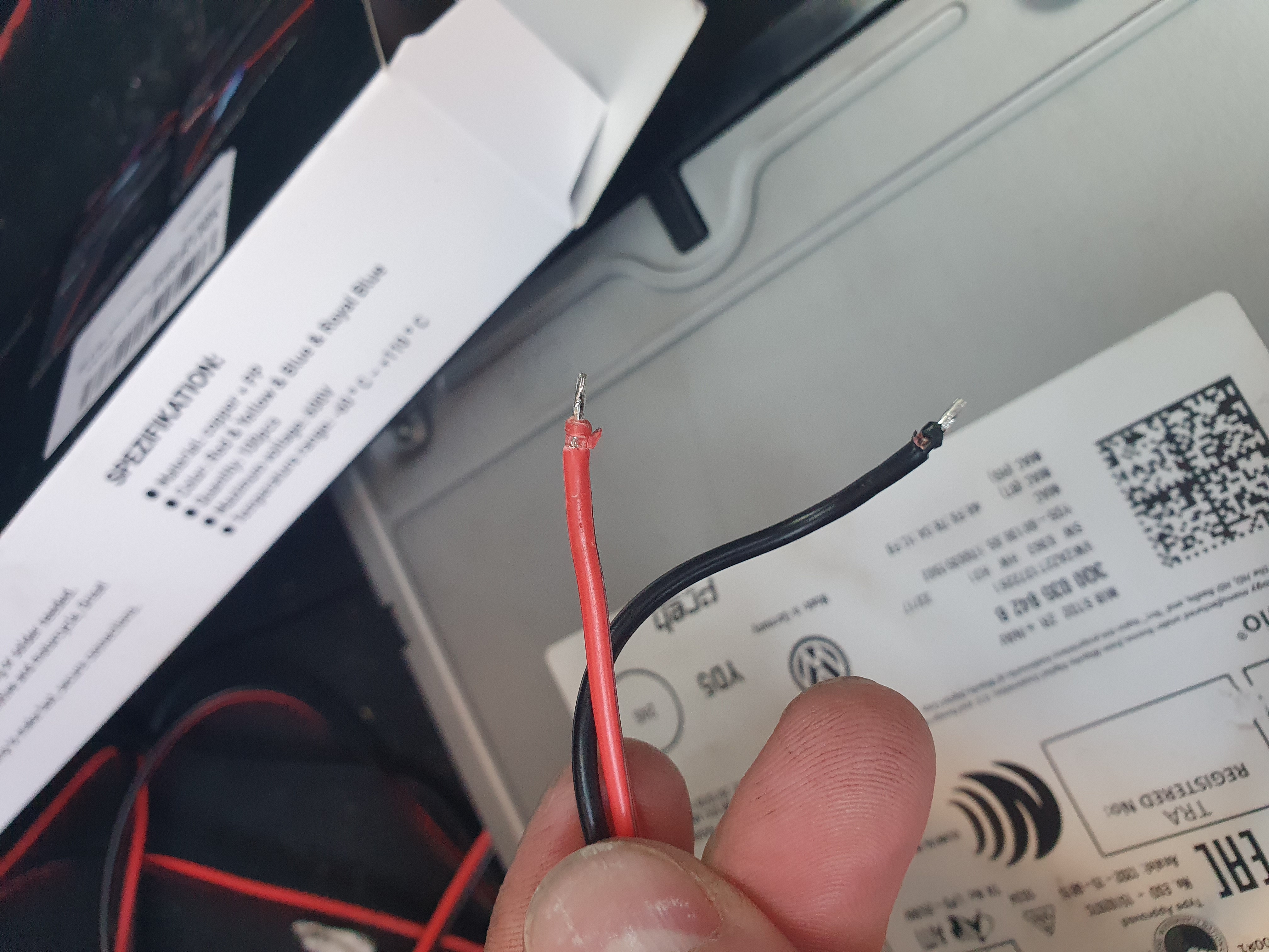

Re: Reverse camera
thanks for the help. the wires are alot smaller than those wires. will it have any issues ie melting from current?iichel wrote: Thu Mar 26, 2020 4:20 pm Ah yes, my mistake.
- Posts: 6686
Re: Reverse camera
No the wires will only draw the current they need for the camera.

Re: Reverse camera
So I've tried that. Still doesn't work. I'm going to try the piggy back fuse connection and see if that works. No doubt I'll be back crying for guidanceiichel wrote:No the wires will only draw the current they need for the camera.

Re: Reverse camera
update.
+ wire plugged into a constant power fuse enables to boot to be opened without keys in the ignition
need to get a connector to attach the - wire to a grounding point somewhere
halfway there kinda
halfway there kinda

Re: Reverse camera
FIXED
im an idiot
just needed to ground the black cable to a bolt behind the dash cover next to the drivers side door
im an idiot
