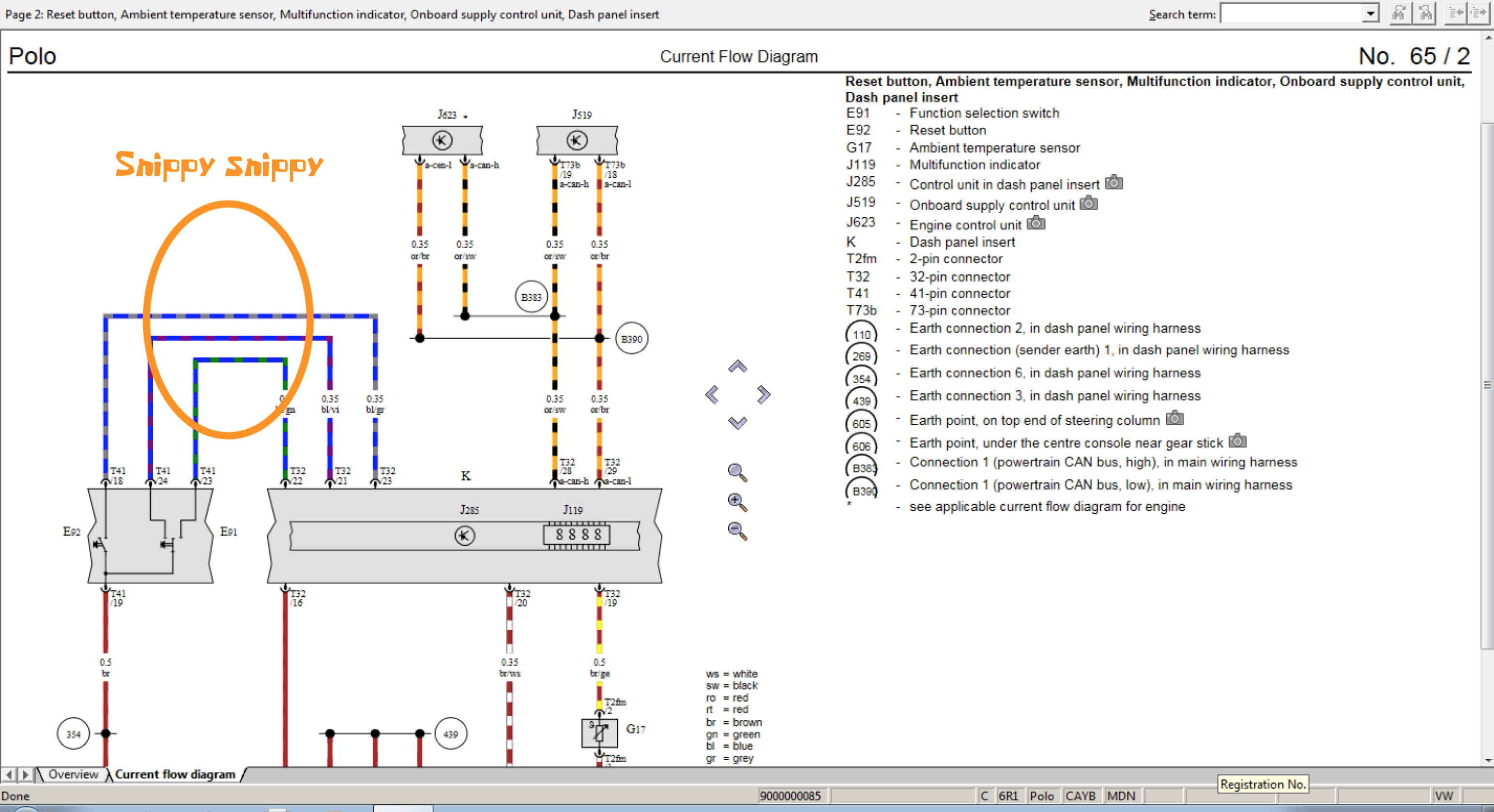

I am from India and owning Polo 6R Trendline which doesn't have buttons on steering wheel. So I am not able to see the average fuel consumption on cluster. Is it possible to make default when I switch on ignition by VCDS.
Right now its displaying only outside temperature:(
Need help!
Posts: 6694
Re: VCDS tweak for Average Fuel consumption display as default
No but you could connect a wire to the cluster and push the wire to GND a few times to emulate the mfd buttons. You do need vcds to enable the mfd buttons

Hey iichel,
Do you know the Pinout of Cluster for this DIY?
I am having 6RF920861F Cluster in my Polo.
Posts: 6694
(ignore the snippy snippy part)
