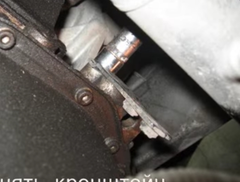

I was the one who changed the chain but had support from my local mechanic and he set the locking tools in place and i know 100% the bracket was not removed so I think this is why potentially the timing is slightly off
I will have to remove the bracket and get it re-timed
Thankfully that won't be too much of a big job
Surprised how that little bracket can throw it off.
I will let you know how I get on.
Bracket
Bracket

Aye, That's the little bracket, it holds the locating pin out just enough to screw up the timing. There's a pretty good walk-through on YouTube of a CBZB chain replacement I will see if I can put my finger on it.
There's a reasonable thread here with a a fair bit of discussion and a few good links. Jay-Jay, has posted tons of info, and done some upgrades to his chain.
viewtopic.php?t=73067
Here ya go, about half way down the thread it explains why you need to remove the bracket. (Highlighted in RED) Unfortunately it's in Italian so Google translate is your buddy.

I have just timed the car again without the bracket on and it's working perfect. The eml light has also turned off.
