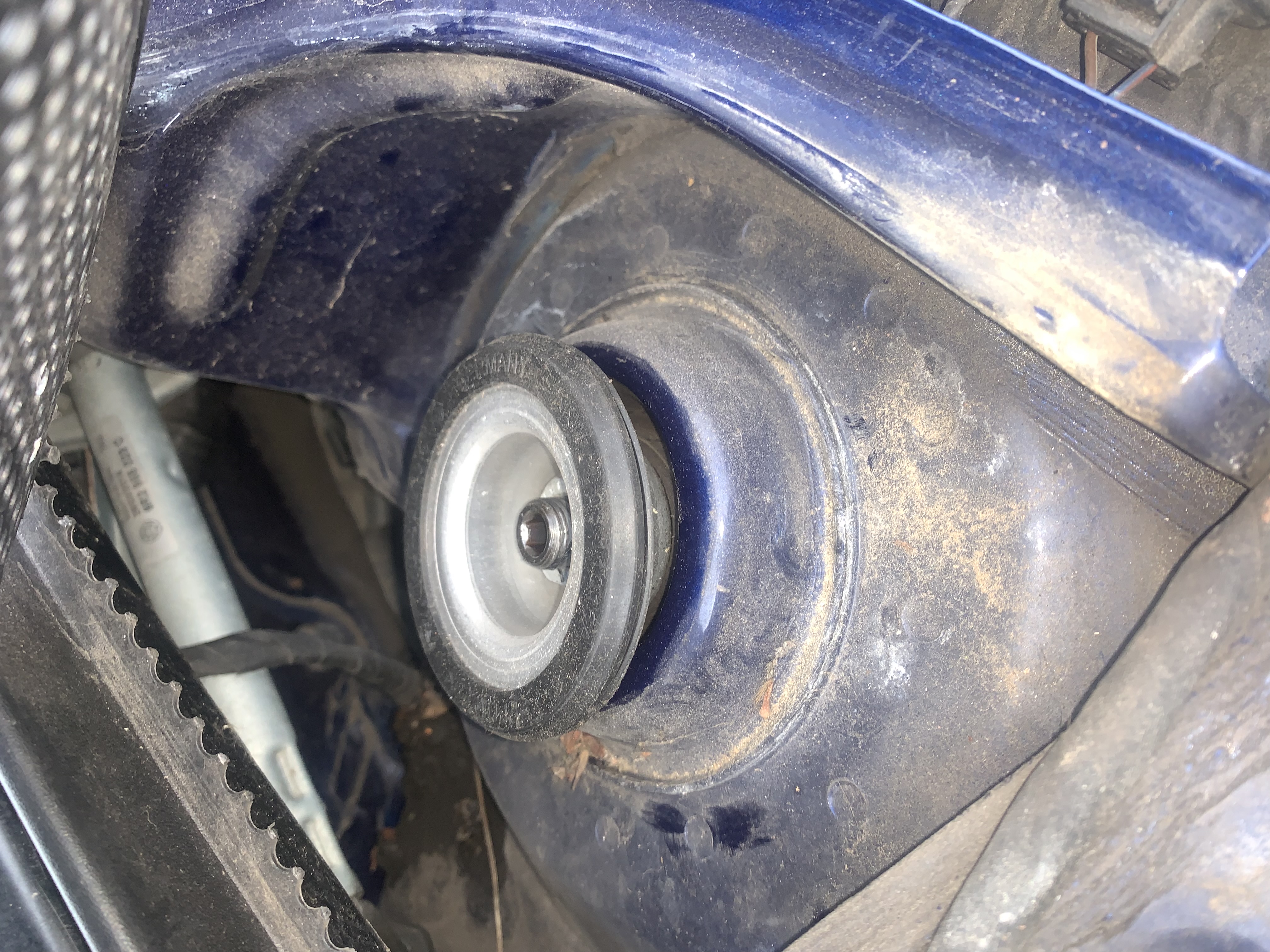

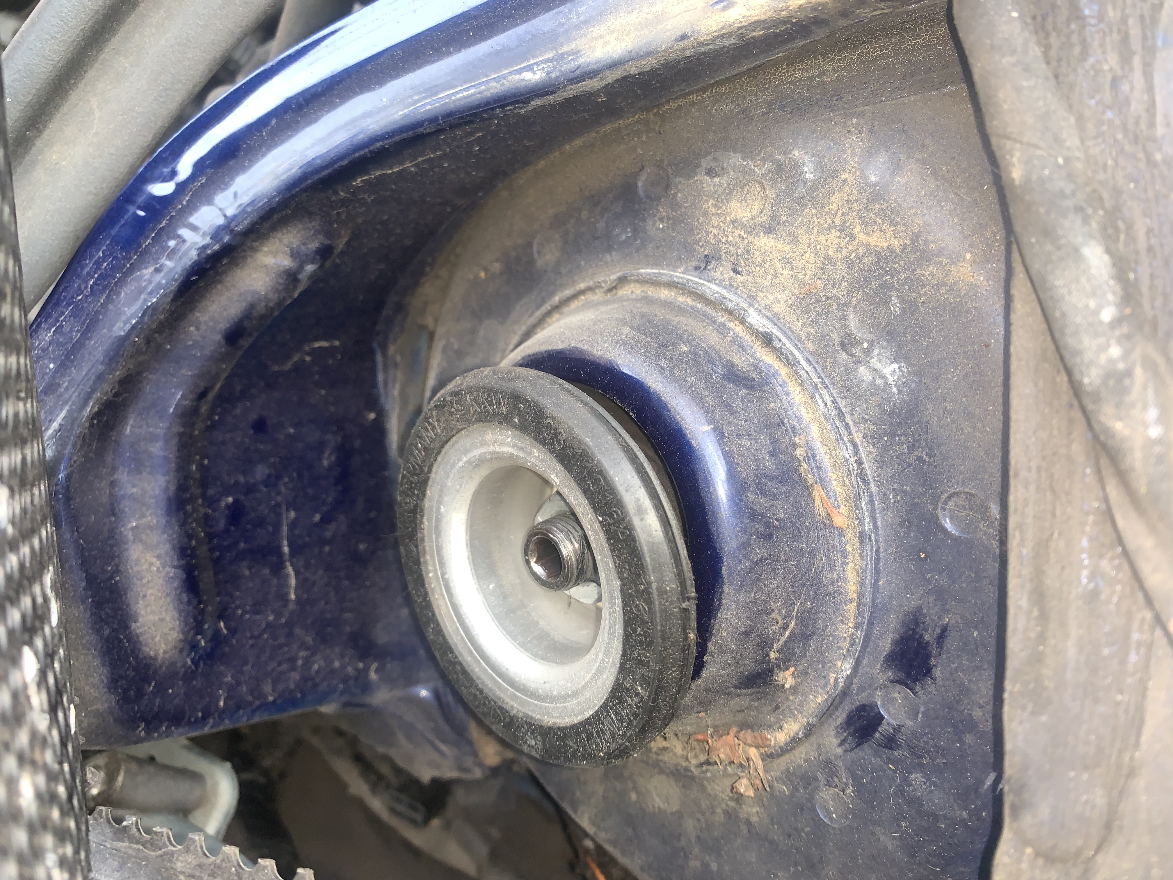

just wondering if anyone has any ideas what makes the creaking sound at the front right when going over bumps, it sounds like rubber rubbing, like a creaking noise.
I looked at the suspension , and its seems good, looked at the top of the strut mounts, two photo here of the right strut top...the right one when compared to the left, doesnt look central ???
Could this have caused any issue if its off?
any comments or advice please

Typicall VAG issue, the rubber on silent bloc when the weather is cold.
They are creaking. Nothing wrong, I have the same issue on my Polo

I might be wrong, but those look a little higher than they should be. Strut mount collapse?
I know one of mine must have a busted bearing since it makes clacking noise when turning the wheel.

You can't tell anything from shock mount in engine bay, you'll need to pull wheel off for proper inspection.
Regardless of mileage, ARB links are a likely culprit coming off a bump. If replacing, then Meyle HD parts are excellent.
