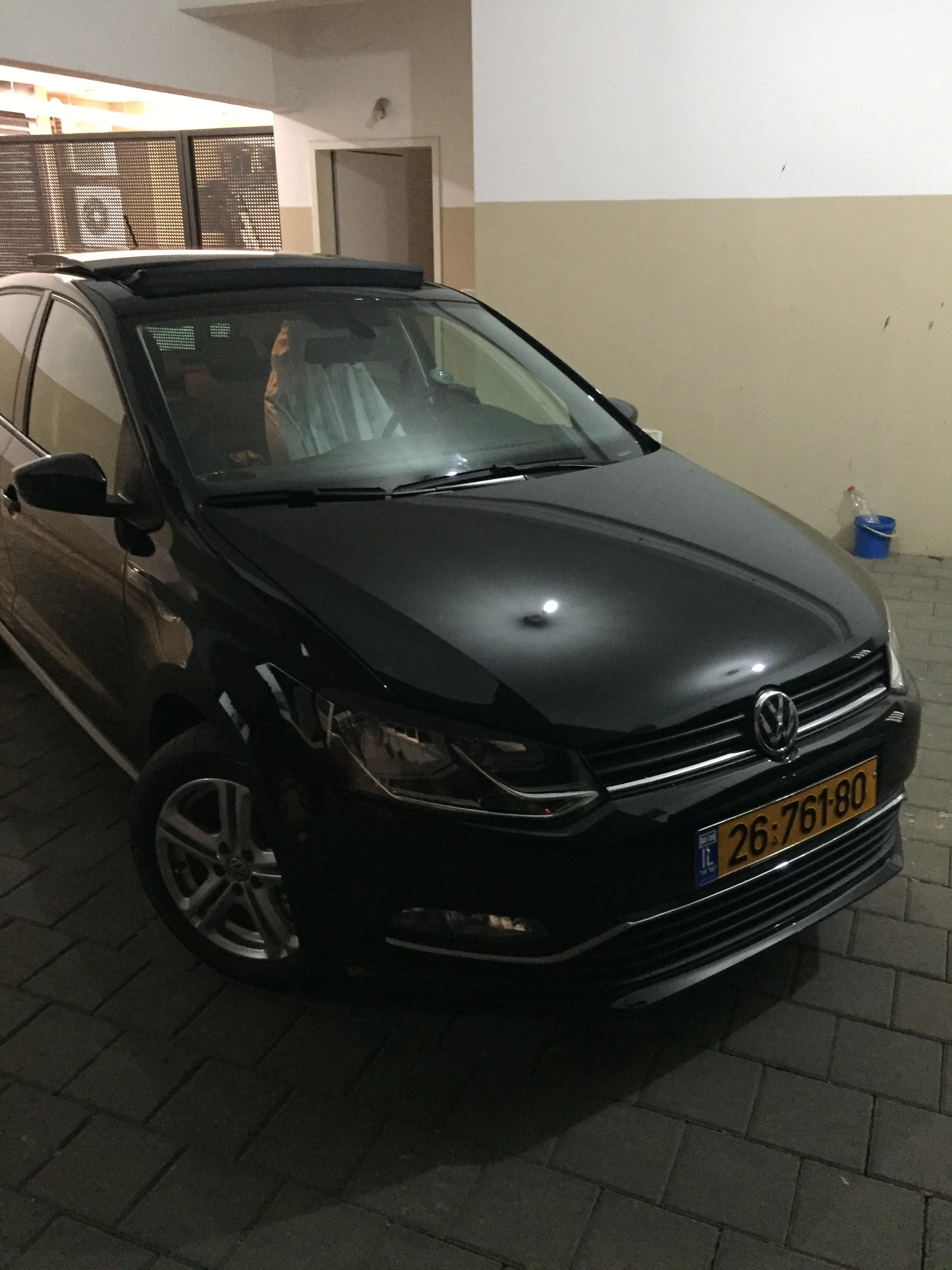

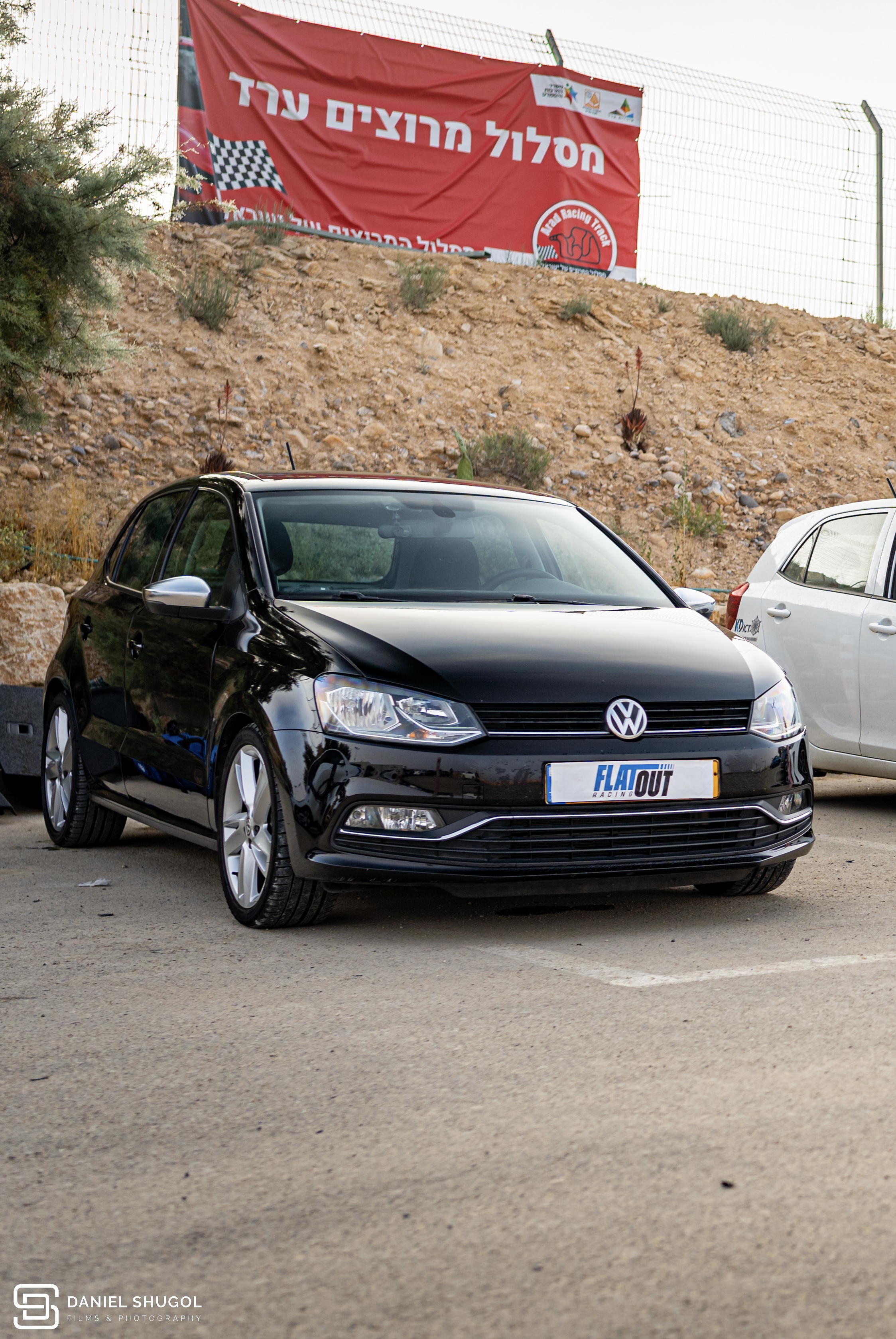

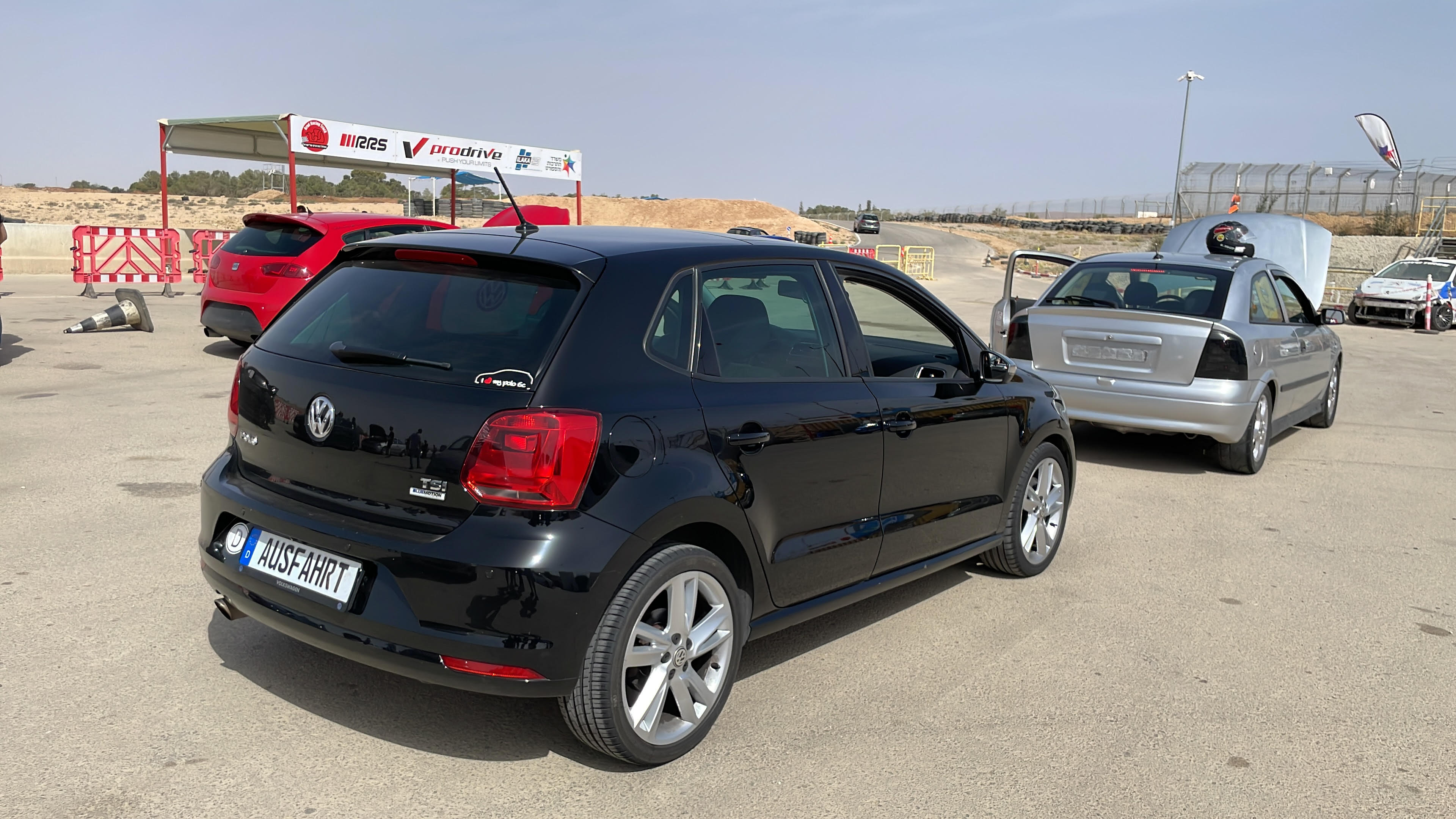

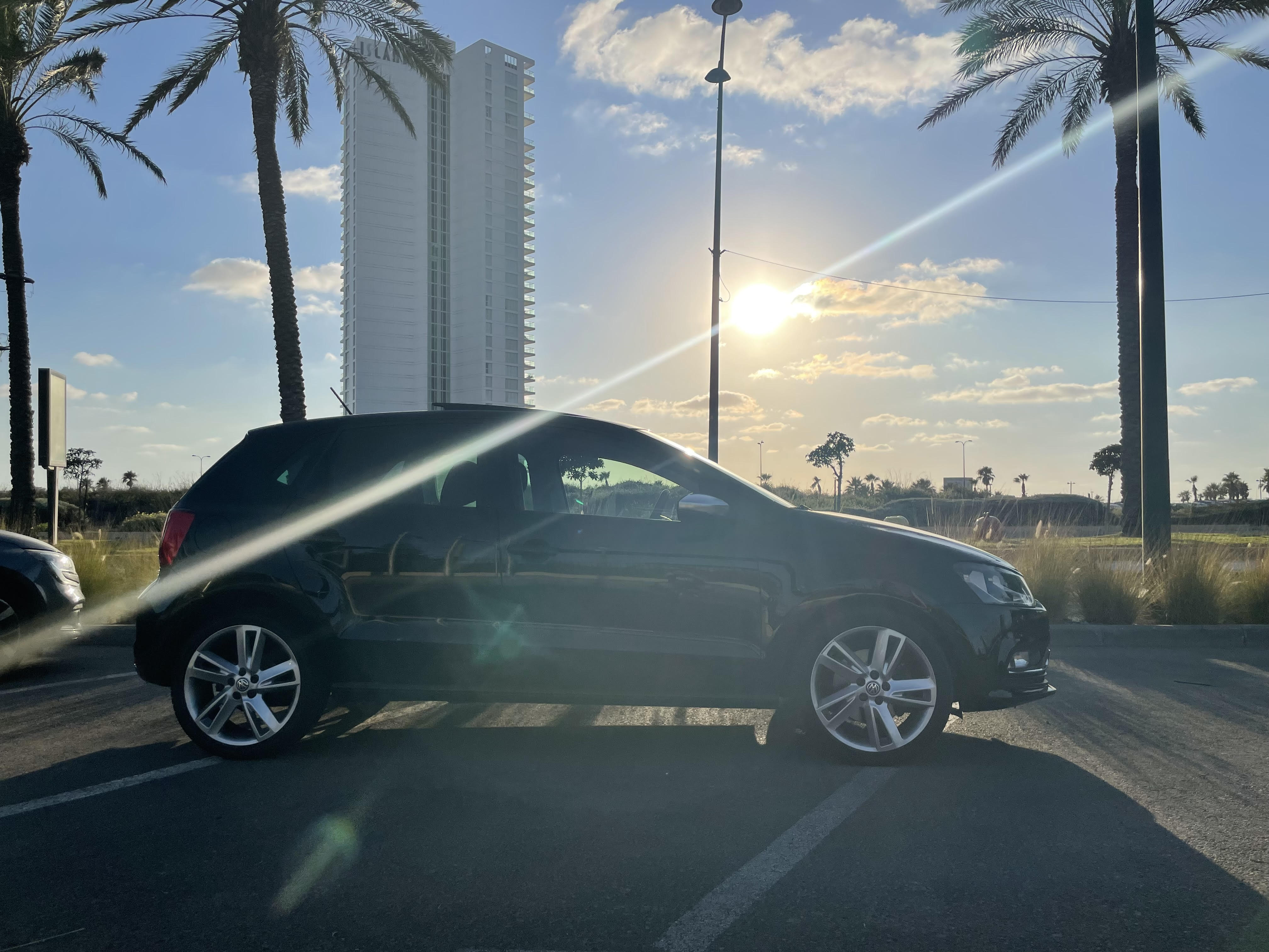

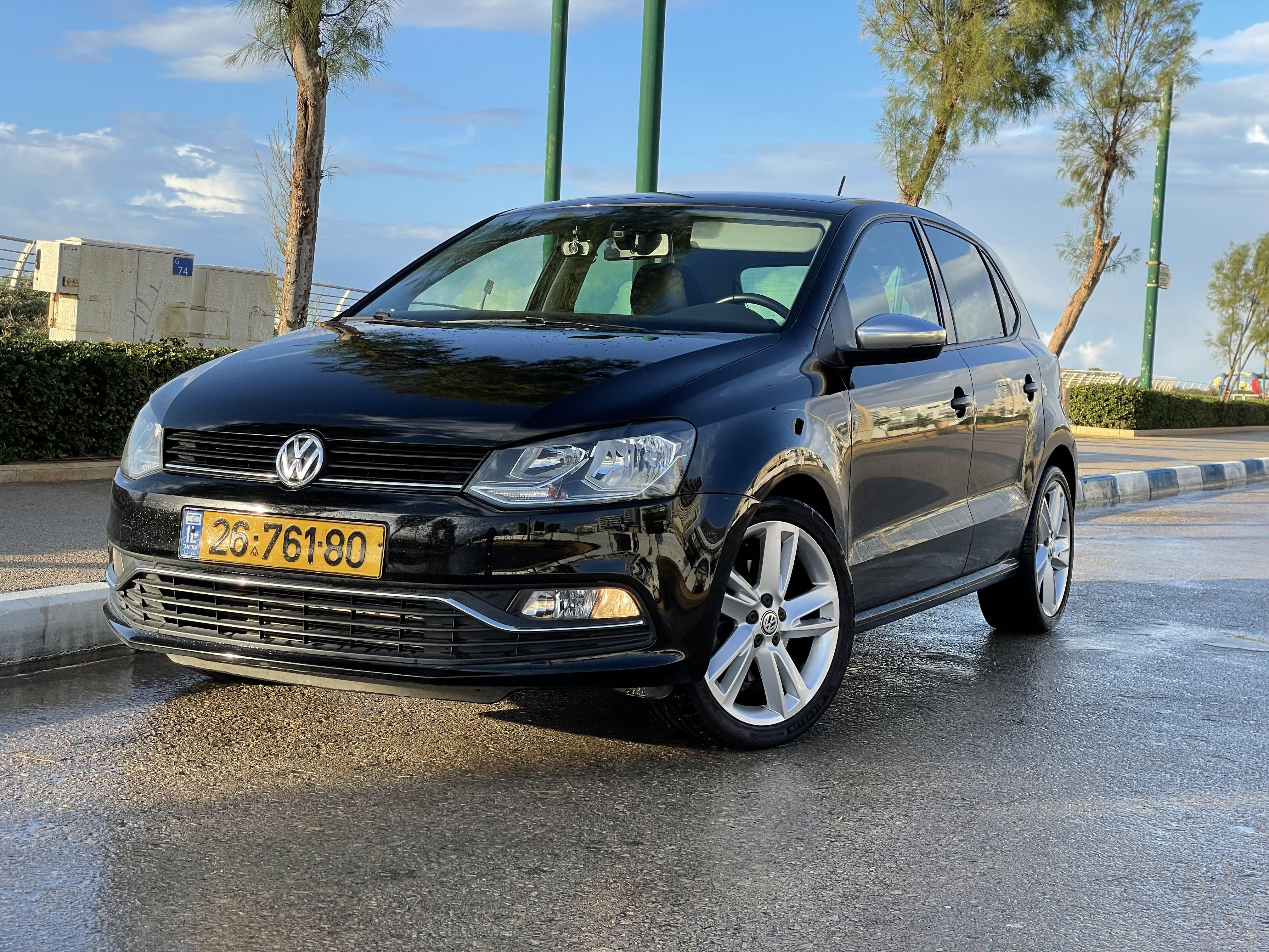

So let's look at it's background: Marco started it's life as a 2016 1.2 tsi (EA211 architecture) bluemotion. The EA211 engine is very reliable and tunable and as result of cost savings from VW is also very close in resemblance to the 1.4 in the gt! I am the first owner of this car, and it was delivered to me on February of 2017 (built November 2016). As for specs, it was the highest trim available here (apart from the gti) called comfortline, and has a sunroof, climate control, fog lights etc.. This is what it looked like more or less when it got to me:

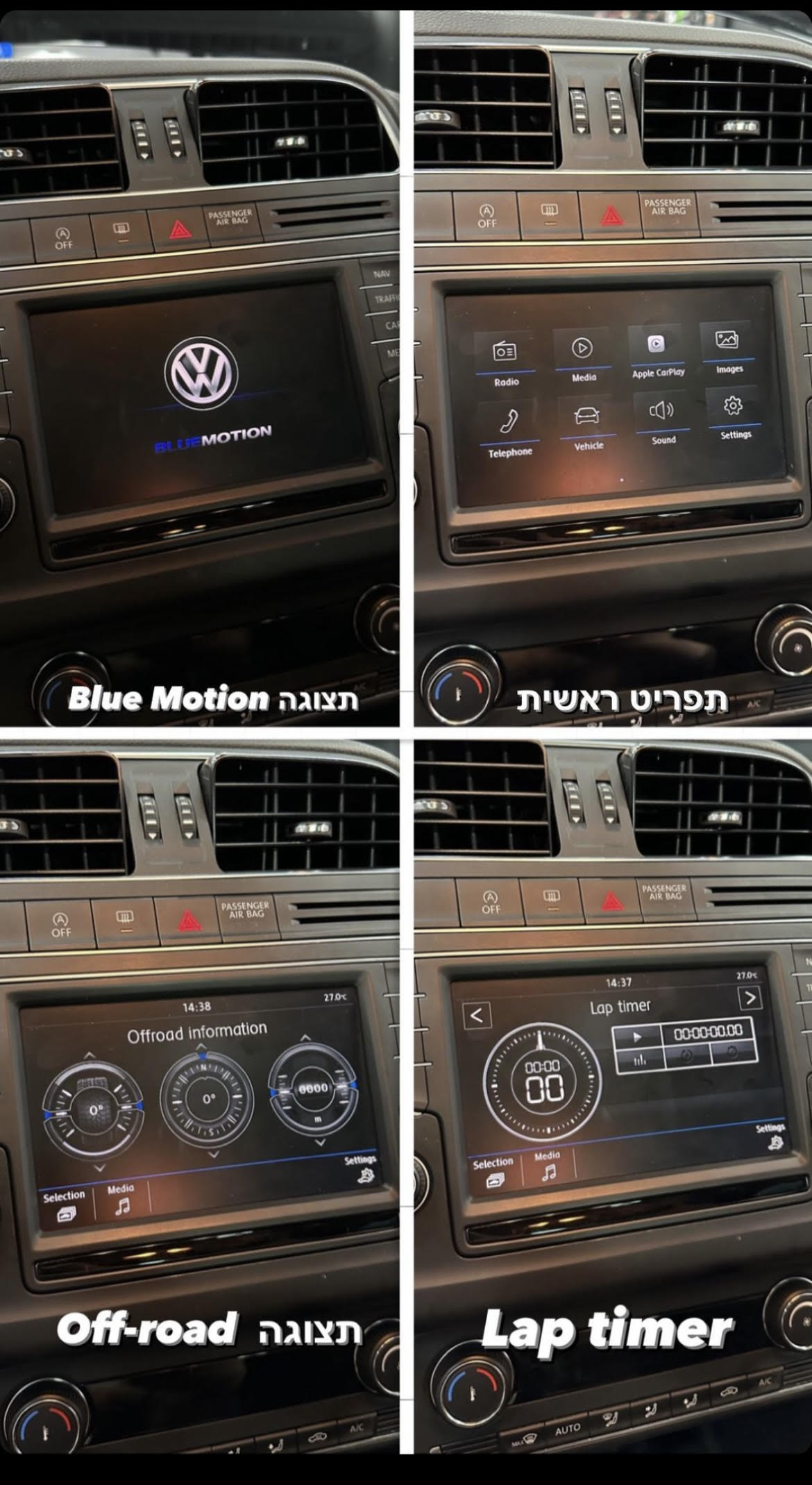

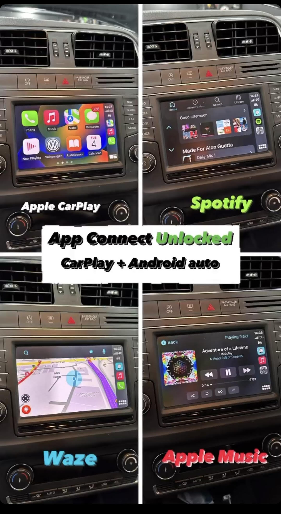

Over the years i haven't done much. Apart from basic maintenance i got 17' Seat Arona wheels with correct spacers (215/40 R17 michelin ps4's tires) to make it look higher spec, got a stage 1 dsg tune (to try and help preserve the gearbox in traffic), a full mib 2 conversion to glovebox unit with carplay and all other functions enabled (sports monitor, esc off option, reverse camera..). Among other small things which I will maybe add later, but mainly things to improve the amount of stuff that needed to come with the car in the first place (sigh...).

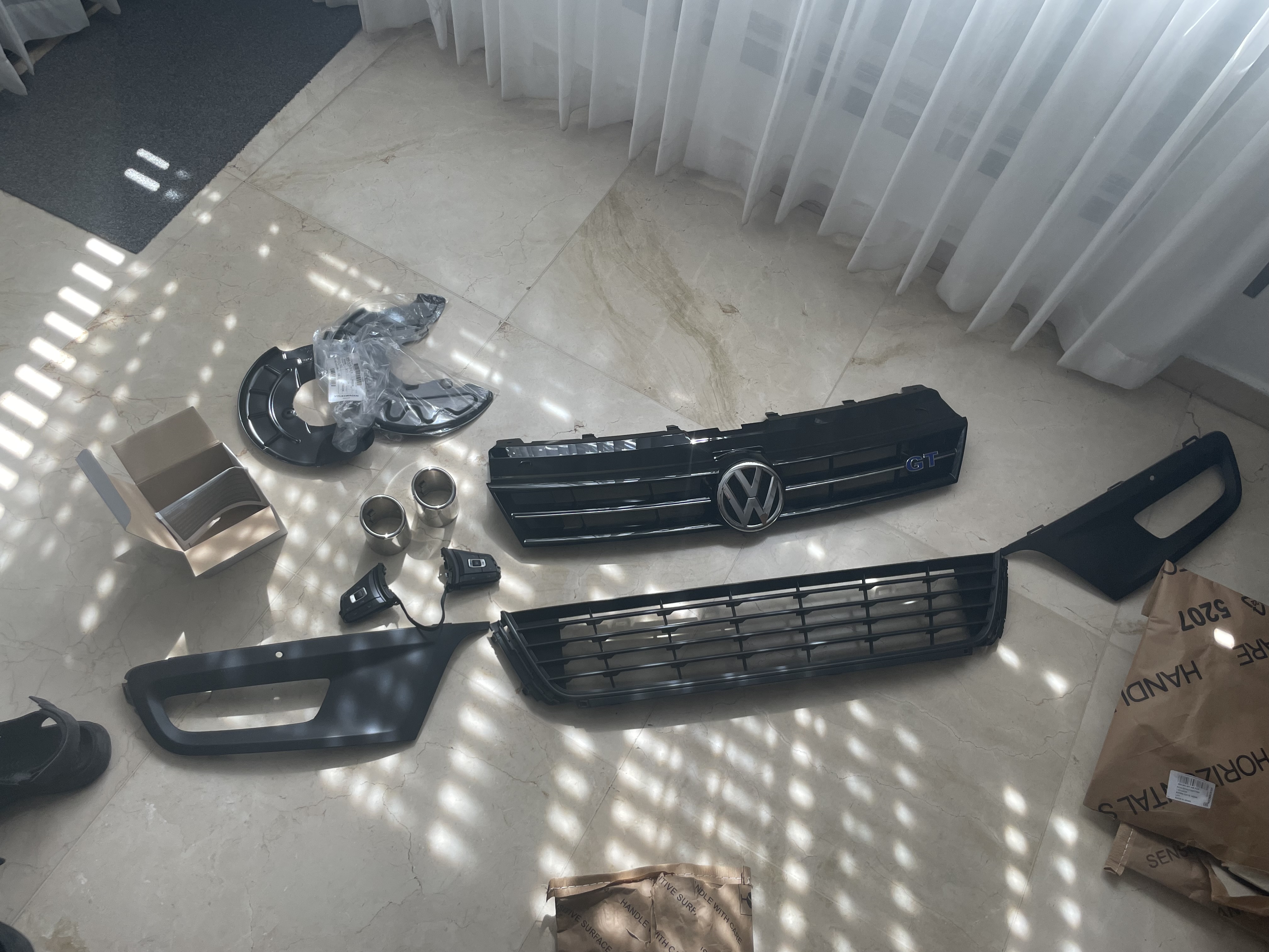

As a side quest over the last 2 years I have collected the relevant parts for this build. So far what I have is:
- 6r gti front bumper with foglights
- 6r gti rear spoiler with brackets
- 6r gti full exhaust (with two exists)
- 6r rear bumper brackets (needed because 6c has a different bracket and I need a 6r gti bumper)
- mk7.5 gti steering wheel
- st xa coilovers

Very nice. Looks amazing with those rims.
The infotainment system is very functional with all those unlocked features.

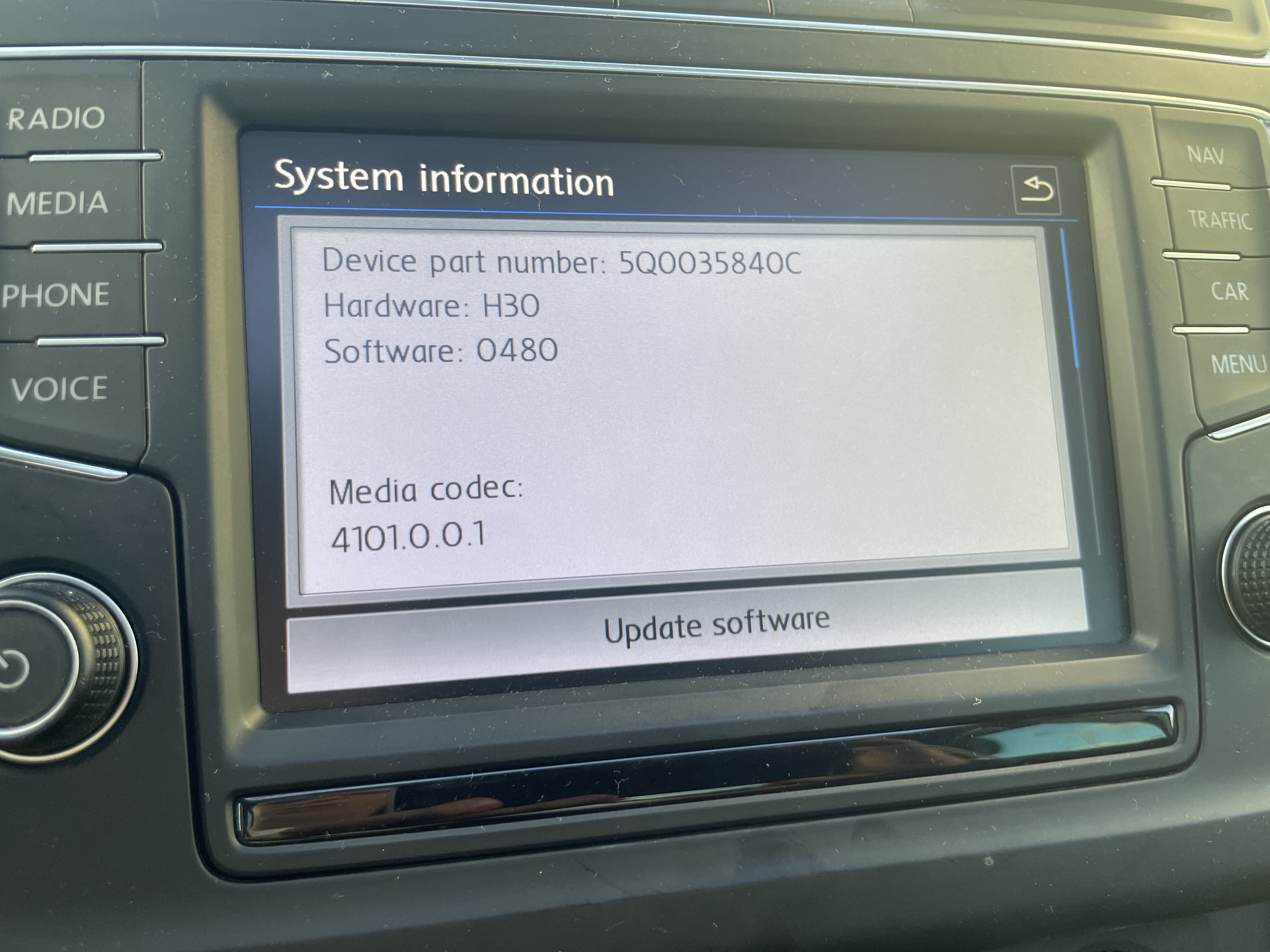

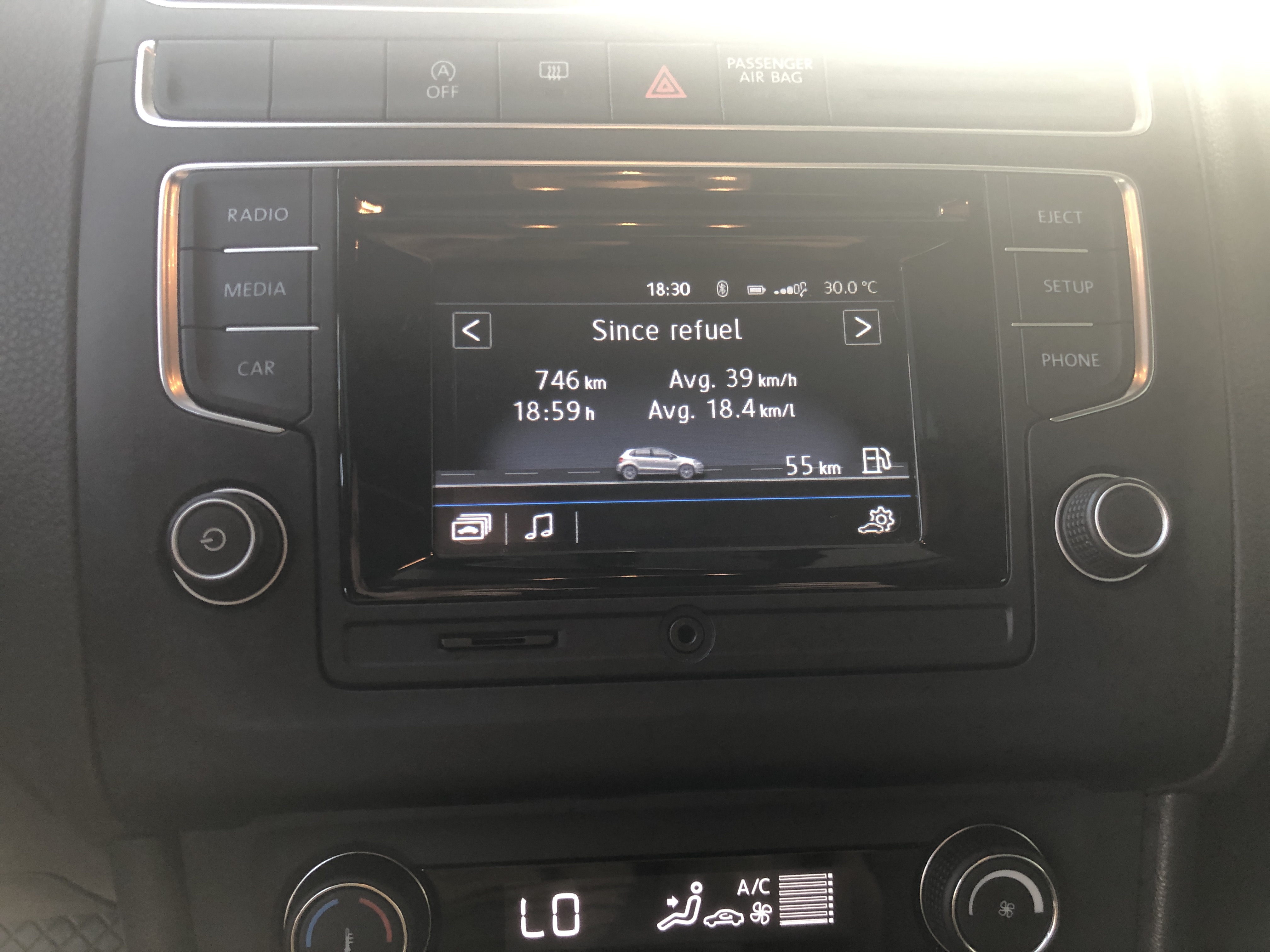

What type is this ? Could you please the code of this Unit (has two codes, one for the screen and one for the main unit).
Black6c
Posts: 56
Joined: Mon May 21, 2018 8:55 pm
Drives: 6c 1.2 (110) TSI DSG
Location: Israel
Re: Marco's Transformation to a Bluegt
Post by Black6c »
The code for the screen itself is 6CO 919 603 A

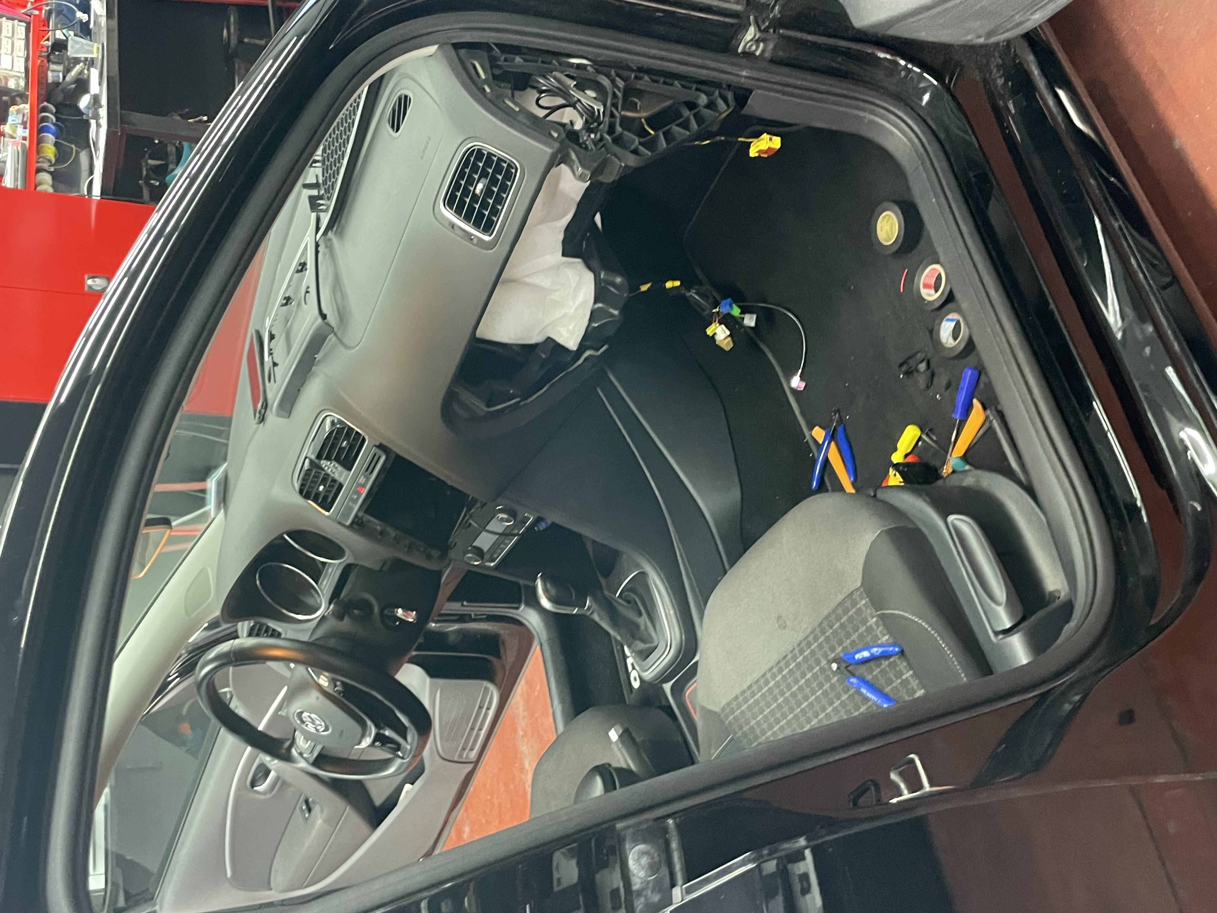

And unfortunately I do not know the part number for the unit in the glovebox because I took it for a professional workshop to install and I didn’t look at the part number before. It was a bit of a hassle because originally the car didn’t come with a unit in the glove box.
So it needed a new glovebox and to be wired in in order to work. Sadly I am not able to do it on my own :(
The screen itself is for navigation because originally I wanted to get nav but it involves installing more parts and a more expensive glovebox unit so I just opted for no nav (maybe will later get around to it) but in the meanwhile it does it’s job.

it is easy to check it, see this video
https://www.youtube.com/watch?v=AmGHhMO ... nel=mr-fix
Black6c
Posts: 56
Location: Israel
Post by Black6c »
Ah yes didn’t realize it’s possible to do that.
This is the glovebox unit code:
Hope that helps :P

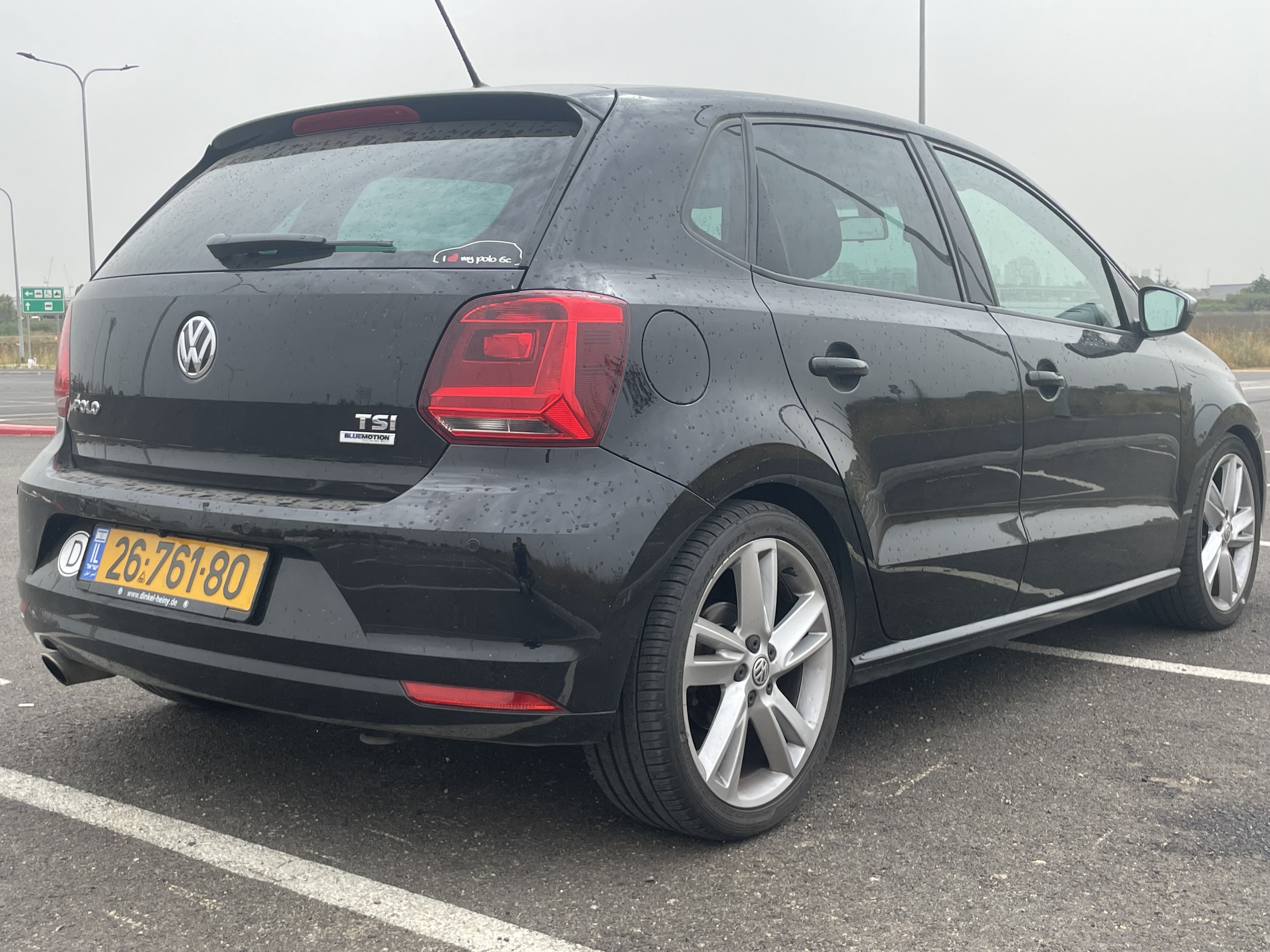

A bit of an update after a few months of silence.

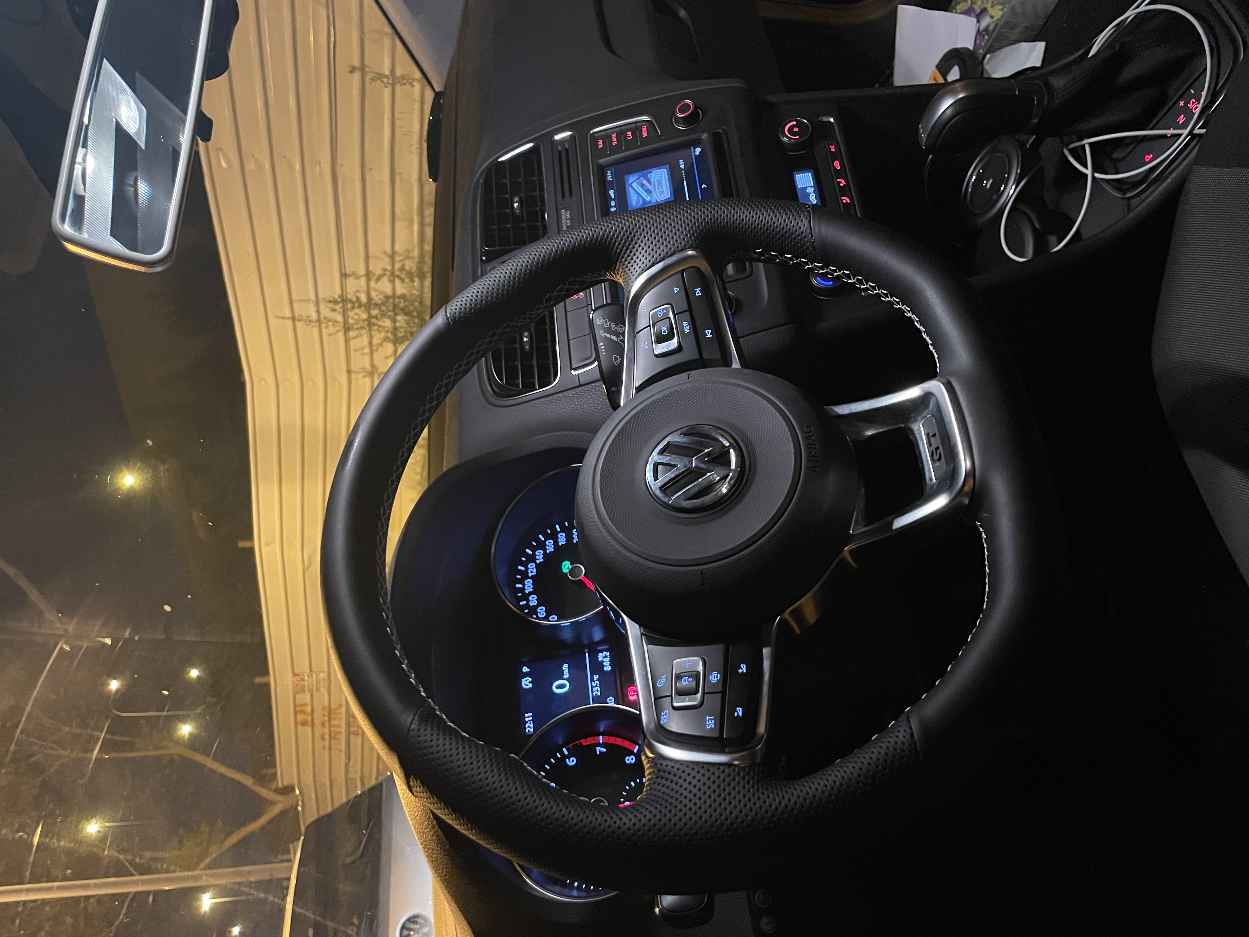

Finally got around to installing the coilovers and the mk7 gti steering wheel.
Coilovers completely transformed the car, it handles so much better, it’s a lot stiffer but not to the point that it isn’t bearable. Thank you the fact the coilovers I got are fully adjustable, both in height and stiffness, helps by a lot. Currently it’s still on the stiffness level set by the previous owner, which is indeed comfortable but I do plan to stiffen the back. Overall body roll has improved significantly, but is in need of an improvement, as I do rub a little when cornering in high speed.

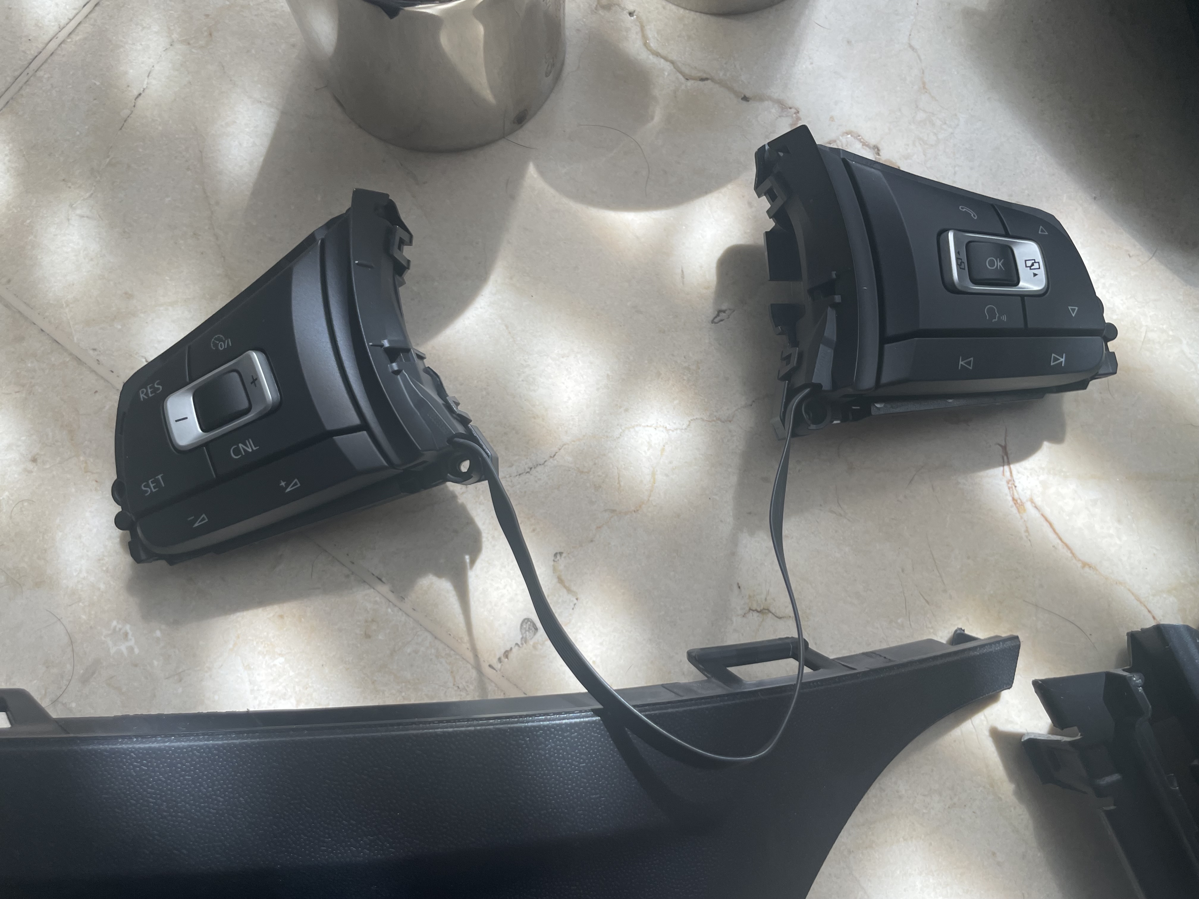

As for the mk7 gti mfsw, that’s a whole different story. The mfsw I got came with digital cockpit and adaptive cc buttons. Obviously those would not work on my polo as it doesn’t have neither. So at first I did get it retrofitted anyway, being told that normal cc buttons should fix the cruise control not working. This week I finally got the new buttons (5G0 959 442 Q ICX) delivered but apperantly a different connector is needed for the whole steering wheel to work properly (cruise control and horn). Has anyone here happen to do this kind of swap on a polo 6c and tell me what I’m missing?
Also, plenty of other GT parts arrived :D
