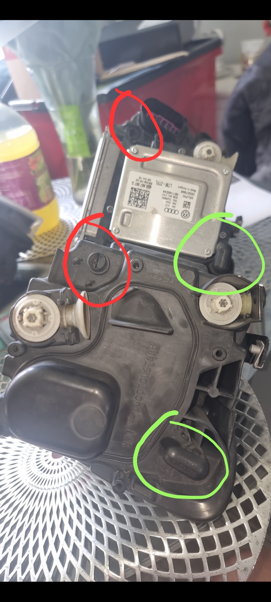

So I've been battling my problem of headlight condensation for about 3 weeks now and I think I'm just about going crazy.
I'm at the point now where I am going to go around the housing seal with some clear Silicone to try and seal any potential gaps in the original seal.
Upon taking the units out today (again) I noticed something interesting. On each of the units there seems to be 4 vents, and on both only 2 of them are covered with a small rubber tube(circled in green). Could this be the reason why I'm having this problem?
If not, any other pointers would be appreciated. As I said before I've tried drying them out, I've tried Silica bags in the backs of the units and I'm going to try and re-seal them using Silicone. Thanks in advance.

you have those rubber thingys on fog lamps. I think they serve as a bump stop

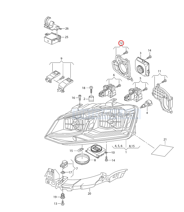

Had a quick look and there seem to be a number of parts that may have seals that are probably worth looking at.
items 12, 3, 11, 8, and 10 look like a good start.
How severe is the condensation? Does it only occur when driving in the rain?
As I mentioned the fogging issue I had only occurred after driving in the wet but I didn't get any substantial condensation where there were water droplets forming just fogged over in the small area around the indicator bulb.
Headlight Diagram.PNG (103.21 KiB) Viewed 1638 times

Bepis wrote: Sun Jul 30, 2023 1:35 am Had a quick look and there seem to be a number of parts that may have seals that are probably worth looking at.
Mine is also around the indicator area. Or so it seems to start from there. It does only happen in the rain but its to the point where water drops actually form and stay there until I remove the unit and dry it out in the house.
The diagram is actually very helpful, thank you. If the problem occurs in the future I will come back to it but fingers crossed the silicone seems to have helped.
