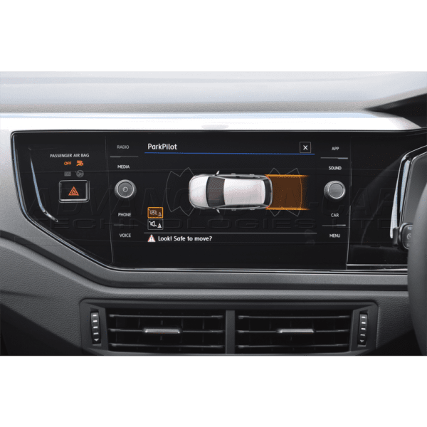

:D Any recommendations of where I can get a VW optical parking system (front & rear) fitted on to a 2020 Polo. South East or Midlands area.
Thanks in advance.
Volkswagen_Polo_AW_Front_Rear_Sensors1-600x600 (1).png (64.04 KiB) Viewed 1308 times

Just be aware that the cost will be very high, I retro fitted front parking system into my 2011 Audi S4 when it was 4 years old, I carried that update out as per what would have been done at initial factory build. I bought the controller, buzzer/speaker and correct replacement switch panel used, all sensors were bought NOS via ebay, mounting brackets were bought from a VW dealership, cabling was bought from Kufatec. On top of that I needed to buy the "same as factory" plug and socket for the front bumper cable, a kit of tools to punch, not drill out holes for the sensors, some reels of correct auto wiring and extra plug and socket contacts and crimping tools.
I took that job on as a small project to amuse myself and to get front parking sensors as that car came with rear parking sensors only, I also had VCDS so could change coding to suit this extra set of bits.
For any professional retro fitter, the cost of the genuine parts will still be very high and the hours of labour to built this into a fully built up car to an acceptable level will be high, so don't be surprised when you get a quote.
