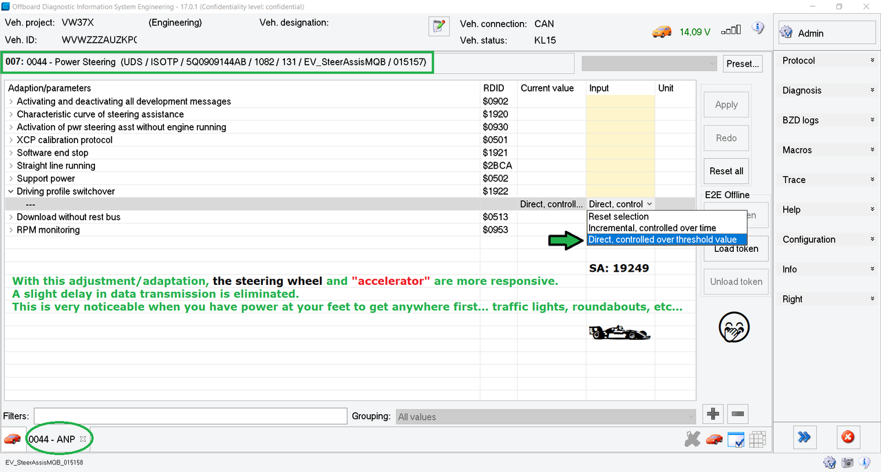

For those who weren't yet familiar with this adaptation:
Recommended only for those whose senses and/or intellect are not yet impaired.
https://www.youtube.com/watch?v=3Znbgqi-0wY&t=79s
https://www.youtube.com/watch?v=jWssqnzbleA
