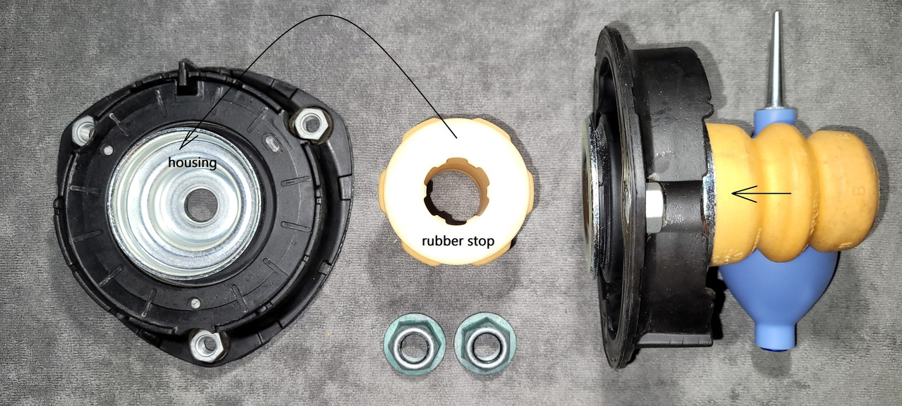

1- Remember that the rubber stop has its housing...
... for some, this point doesn't seem entirely clear.

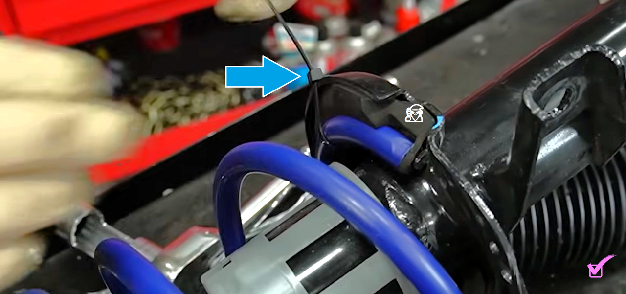

2- A great idea for holding the parts while releasing the spring compressor.
...and avoiding having to struggle with them. :arrow: https://youtu.be/LGgka_ytHH4?t=173 👍

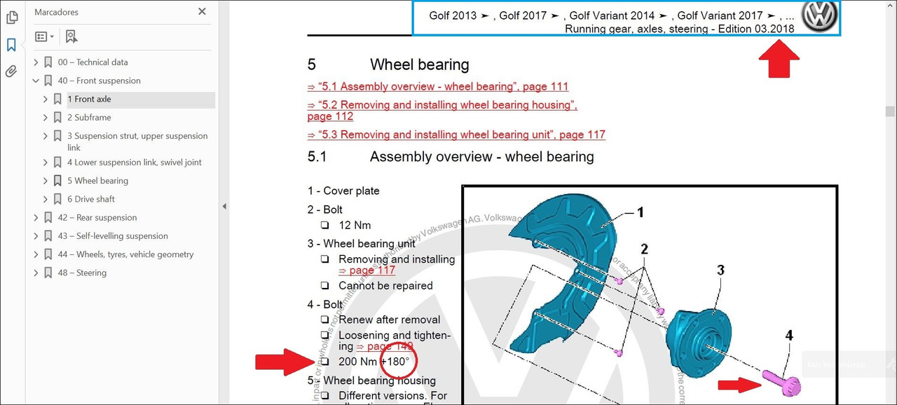

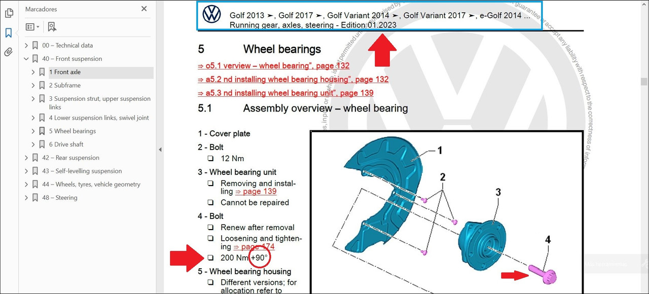

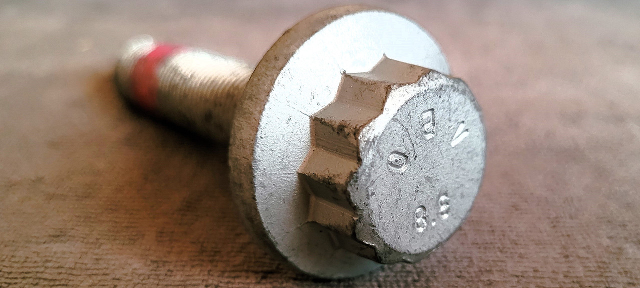

3- Torque update for bolt WHT005437A according to erWin:
e2018
Related: :arrow: viewtopic.php?p=603218#p603218
IMHO, it's best to apply full torque with the car jacked up (to protect the wheel bearing).
e2023
I don't know if this is due to the bolt's Property Class/Grade or the lateral preload applied to the wheel bearing.
Which engineer is responsible for this new torque on this bolt that also applies to the Golf 8? :mrgreen:
Remember not to use an impact wrench, or the bearing will be damaged, and in a few thousand kilometers/milles you'll have to replace it...
