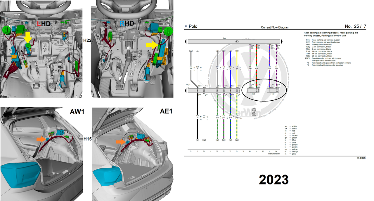

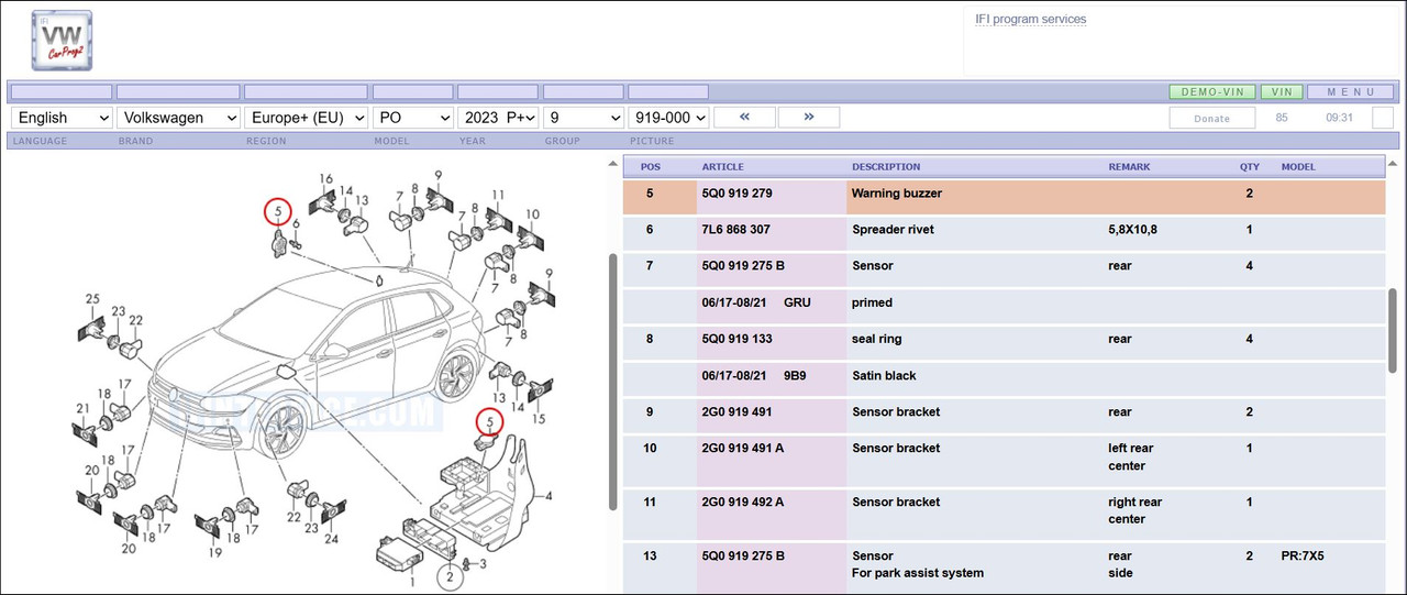

Hi, just to update, the car came back from its service and according to them, there are no faults with the sensors. The car only has a front buzzer that changes tone depending on whether it's in the front or back. According to what I saw in some forums, they say that from 2019 onwards, the Polo had the rear buzzer removed for cost reasons; I don't know if that's true.

Please tell us where you read that.
VW has placed a minion at each VW POLO for possible audible warnings regardless of their origin.
