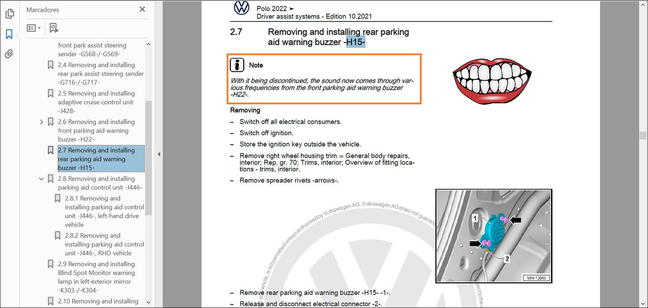

Hi, just to update, the car came back from its service and according to them, there are no faults with the sensors. The car only has a front buzzer that changes tone depending on whether it's in the front or back. According to what I saw in some forums, they say that from 2019 onwards, the Polo had the rear buzzer removed for cost reasons; I don't know if that's true.

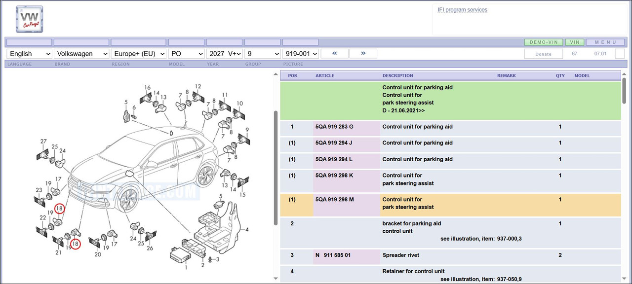

Hi, I already used the information you're showing to locate the buzzer before going to the workshop, and I can say that I disassembled the left and right sides of the wheel well using that diagram and didn't find it on either side.
Posts: 8992
Re: Question about parking sensors
So, VW is forced to hide information in its own diagrams.
Let's see what's happening in their repair manuals:
It occurs to me that this is very interesting for the cheapest retrofit of this assistant.🤭
We'll have to figure out the appropriate dataset for this 'mystery'.
